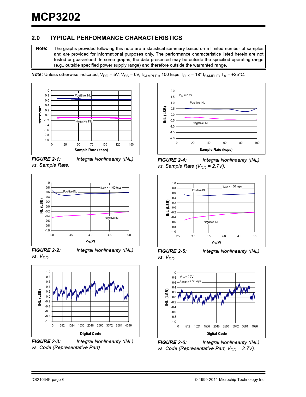

MCP3202. 2.0. TYPICAL PERFORMANCE CHARACTERISTICS. Note:. S L. INL (. Sample Rate (ksps). FIGURE 2-1:. FIGURE 2-4:. VDD(V). FIGURE 2-2:
MCP3202 2.0 TYPICAL PERFORMANCE CHARACTERISTICS Note: S L INL ( Sample Rate (ksps) FIGURE 2-1: FIGURE 2-4: VDD(V) FIGURE 2-2:
The graphs provided following this note are a statistical summary based on a limited number of samples and are provided for informational purposes only. The performance characteristics listed herein are not tested or guaranteed. In some graphs, the data presented may be outside the specified operating range (e.g., outside specified power supply range) and therefore outside the warranted range.
Note:
Unless otherwise indicated, VDD = 5V, VSS = 0V, fSAMPLE = 100 ksps, fCLK = 18* fSAMPLE, TA = +25°C. 1.0 2.0 0.8 Positive INL V 1.5 DD = 2.7V 0.6 1.0 Positive INL 0.4

Negative INL -0.4 -1.0 -0.6 -1.5 -0.8 -1.0 -2.0 0 20 40 60 80 100 0 25 50 75 100 125 150
Sample Rate (ksps) Sample Rate (ksps) FIGURE 2-1:
Integral Nonlinearity (INL)
FIGURE 2-4:
Integral Nonlinearity (INL) vs. Sample Rate. vs. Sample Rate (VDD = 2.7V). 1.0 1.0 0.8 f f SAMPLE = 100 ksps 0.8 SAMPLE = 50 ksps Positive INL 0.6 Positive INL 0.6 0.4

Negative INL -0.4 -0.6 -0.6 Negative INL -0.8 -0.8 -1.0 -1.0 3.0 3.5 4.0 4.5 5.0 2.5 3.0 3.5 4.0 4.5 5.0
VDD(V) VDD(V) FIGURE 2-2:
FIGURE 2-5:
Integral Nonlinearity (INL) vs. VDD. vs. VDD. 1.0 1.0 0.8 0.8 VDD = 2.7V 0.6 0.6 FSAMPLE = 50 ksps 0.4 0.4

-0.4 -0.4 -0.6 -0.6 -0.8 -0.8 -1.0 -1.0 0 512 1024 1536 2048 2560 3072 3584 4096 0 512 1024 1536 2048 2560 3072 3584 4096
Digital Code Digital Code FIGURE 2-3:
FIGURE 2-6:
Integral Nonlinearity (INL) vs. Code (Representative Part). vs. Code (Representative Part, VDD = 2.7V). DS21034F-page 6  1999-2011 Microchip Technology Inc. Document Outline MCP3202 - 2.7V Dual Channel 12-Bit A/D Converter with SPI Serial Interface Functional Block Diagram Package Types 1.0 Electrical Characteristics Absolute Maximum Ratings † FIGURE 1-1: Serial Timing. FIGURE 1-2: Test Circuits. 2.0 Typical Performance Characteristics FIGURE 2-1: Integral Nonlinearity (INL) vs. Sample Rate. FIGURE 2-2: Integral Nonlinearity (INL) vs. VDD. FIGURE 2-3: Integral Nonlinearity (INL) vs. Code (Representative Part). FIGURE 2-4: Integral Nonlinearity (INL) vs. Sample Rate (VDD = 2.7V). FIGURE 2-5: Integral Nonlinearity (INL) vs. VDD. FIGURE 2-6: Integral Nonlinearity (INL) vs. Code (Representative Part, VDD = 2.7V). FIGURE 2-7: Integral Nonlinearity (INL) vs. Temperature. FIGURE 2-8: Differential Nonlinearity (DNL) vs. Sample Rate. FIGURE 2-9: Differential Nonlinearity (DNL) vs. VDD. FIGURE 2-10: Integral Nonlinearity (INL) vs. Temperature (VDD = 2.7V). FIGURE 2-11: Differential Nonlinearity (DNL) vs. Sample Rate (VDD = 2.7V). FIGURE 2-12: Differential Nonlinearity (DNL) vs. VDD. FIGURE 2-13: Differential Nonlinearity (DNL) vs. Code (Representative Part). FIGURE 2-14: Differential Nonlinearity (DNL) vs. Temperature. FIGURE 2-15: Gain Error vs. VDD. FIGURE 2-16: Differential Nonlinearity (DNL) vs. Code (Representative Part, VDD = 2.7V). FIGURE 2-17: Differential Nonlinearity (DNL) vs. Temperature (VDD = 2.7V). FIGURE 2-18: Offset Error vs. VDD. FIGURE 2-19: Gain Error vs. Temperature. FIGURE 2-20: Signal-to-Noise Ratio (SNR) vs. Input Frequency. FIGURE 2-21: Total Harmonic Distortion (THD) vs. Input Frequency. FIGURE 2-22: Offset Error vs. Temperature. FIGURE 2-23: Signal-to-Noise and Distortion (SINAD) vs. Input Frequency. FIGURE 2-24: Signal-to-Noise and Distortion (SINAD) vs. Signal Level. FIGURE 2-25: Effective Number of Bits (ENOB) vs. VDD. FIGURE 2-26: Spurious Free Dynamic Range (SFDR) vs. Input Frequency. FIGURE 2-27: Frequency Spectrum of 10 kHz input (Representative Part). FIGURE 2-28: Effective Number of Bits (ENOB) vs. Input Frequency. FIGURE 2-29: Power Supply Rejection (PSR) vs. Ripple Frequency. FIGURE 2-30: Frequency Spectrum of 1 kHz input (Representative Part, VDD = 2.7V). FIGURE 2-31: IDD vs. VDD. FIGURE 2-32: IDD vs. Clock Frequency. FIGURE 2-33: IDD vs. Temperature. FIGURE 2-34: IDDS vs. VDD. FIGURE 2-35: IDDS vs. Temperature. FIGURE 2-36: Analog Input leakage current vs. Temperature. 3.0 Pin Descriptions TABLE 3-1: Pin Function Table 3.1 Analog Inputs (CH0/CH1) 3.2 Chip Select/Shutdown (CS/SHDN) 3.3 Serial Clock (CLK) 3.4 Serial Data Input (DIN) 3.5 Serial Data Output (DOUT) 4.0 Device Operation 4.1 Analog Inputs 4.2 Digital Output Code EQUATION 4-1: FIGURE 4-1: Analog Input Model. FIGURE 4-2: Maximum Clock Frequency vs. Input Resistance (RS) to maintain less than a 0.1 LSB deviation in INL from nominal conditions. 5.0 Serial Communications 5.1 Overview TABLE 5-1: Configuration Bits for the MCP3202 FIGURE 5-1: Communication with the MCP3202 using MSB first format only. FIGURE 5-2: Communication with MCP3202 using LSB first format. 6.0 Applications Information 6.1 Using the MCP3202 with Microcontroller (MCU) SPI Ports FIGURE 6-1: SPI Communication using 8-bit segments (Mode 0,0: SCLK idles low). FIGURE 6-2: SPI Communication using 8-bit segments (Mode 1,1: SCLK idles high). 6.2 Maintaining Minimum Clock Speed 6.3 Buffering/Filtering the Analog Inputs FIGURE 6-3: The MCP601 Operational Amplifier is used to implement a 2nd order anti- aliasing filter for the signal being converted by the MCP3202. 6.4 Layout Considerations FIGURE 6-4: VDD traces arranged in a ‘Star’ configuration in order to reduce errors caused by current return paths. 7.0 Packaging Information 7.1 Package Marking Information Appendix A: Revision History Worldwide Sales and Service
