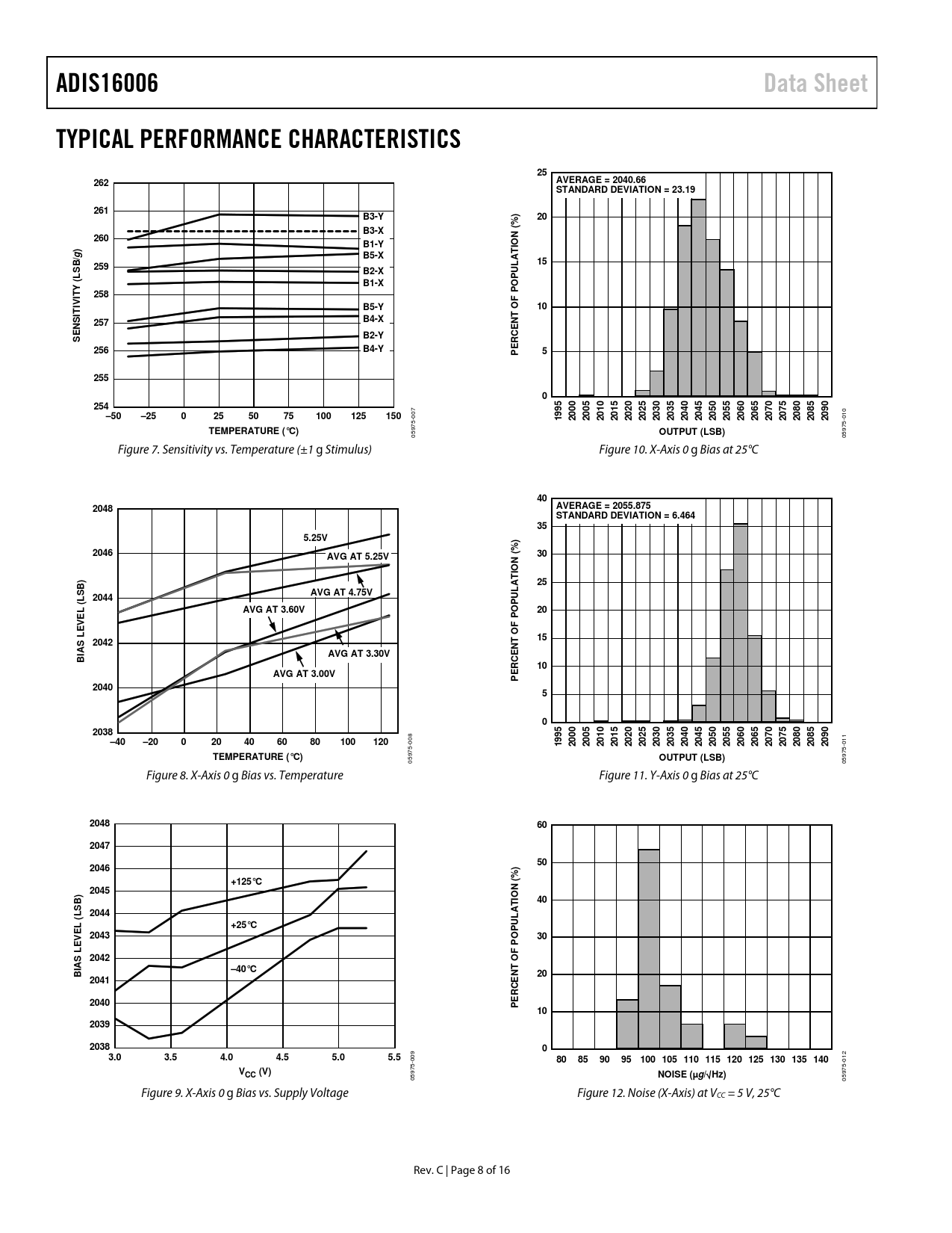

ADIS16006. Data Sheet. TYPICAL PERFORMANCE CHARACTERISTICS. 262. AVERAGE = 2040.66 STANDARD DEVIATION = 23.19. 261. B3-Y. B3-X. 260. B1-Y
ADIS16006 Data Sheet TYPICAL PERFORMANCE CHARACTERISTICS 262 AVERAGE = 2040.66 STANDARD DEVIATION = 23.19 261 B3-Y B3-X 260 B1-Y
ADIS16006 Data Sheet TYPICAL PERFORMANCE CHARACTERISTICS 25 262 AVERAGE = 2040.66 STANDARD DEVIATION = 23.19 261 B3-Y ) 20 B3-X (% 260 N B1-Y IO ) T /g B5-X A L 15 259 SB L B2-X PU Y ( B1-X T 258 PO F IVI O 10 T B5-Y T SI 257 B4-X N E C SEN B2-Y 256 B4-Y PER 5 255 0 254

597 05 0 Figure 7. Sensitivity vs. Temperature (±1 g Stimulus) Figure 10. X-Axis 0 g Bias at 25°C
40 2048 AVERAGE = 2055.875 STANDARD DEVIATION = 6.464 35 5.25V ) 2046 AVG AT 5.25V (% 30 N IO T A 25 B) S AVG AT 4.75V L L 2044 ( PU L AVG AT 3.60V 20 E PO V F E L O 15 2042 T AS N AVG AT 3.30V E BI C 10 AVG AT 3.00V PER 2040 5 0 2038

597 05 0 Figure 8. X-Axis 0 g Bias vs. Temperature Figure 11. Y-Axis 0 g Bias at 25°C
2048 60 2047 50 2046 ) +125°C (% 2045 N B) IO 40 T S 2044 A (L L L +25°C E PU 2043 V 30 E PO L F 2042 O AS –40°C T BI N 20 2041 E C 2040 PER 10 2039 2038 0 3.0 3.5 4.0 4.5 5.0 5.5

97 05 05 Figure 9. X-Axis 0 g Bias vs. Supply Voltage Figure 12. Noise (X-Axis) at VCC = 5 V, 25°C Rev. C | Page 8 of 16 Document Outline Features Applications General Description Functional Block Diagram Revision History Specifications Timing Specifications Circuit and Timing Diagrams Absolute Maximum Ratings ESD Caution Pin Configuration and Function Descriptions Typical Performance Characteristics Theory of Operation Accelerometer Data Format Self-Test Serial Interface Accelerometer Serial Interface Accelerometer Control Register Power-Down ADD0 ZERO ONE DONTC Accelerometer Conversion Details Temperature Sensor Serial Interface Read Operation Write Operation Temperature Sensor Control Register ZERO Output Data Format Temperature Sensor Conversion Details Power Supply Decoupling Setting the Bandwidth Selecting Filter Characteristics: The Noise/Bandwidth Trade-Off Applications Second Level Assembly Outline Dimensions Ordering Guide
