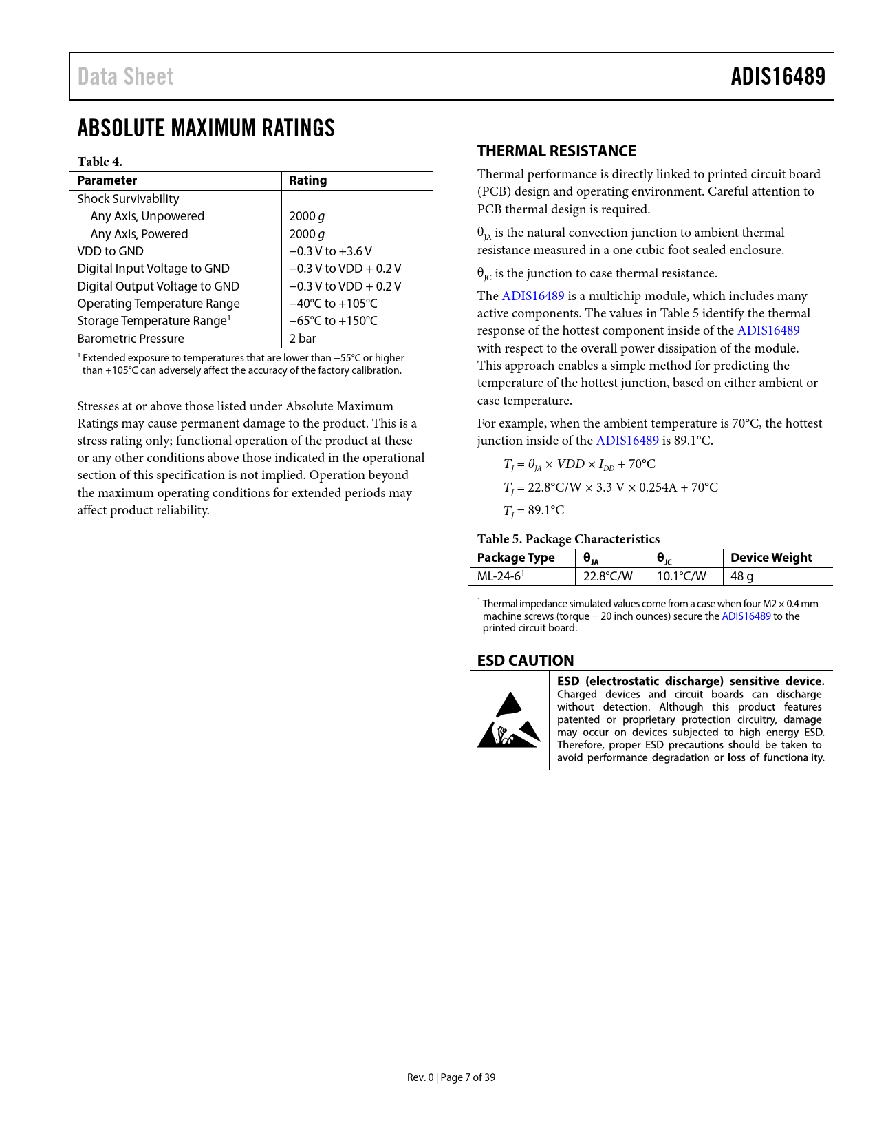

Data Sheet ADIS16489 ABSOLUTE MAXIMUM RATINGS THERMAL RESISTANCE Table 4. Parameter Rating
Thermal performance is directly linked to printed circuit board Shock Survivability (PCB) design and operating environment. Careful attention to Any Axis, Unpowered 2000 g PCB thermal design is required. Any Axis, Powered 2000 g θJA is the natural convection junction to ambient thermal VDD to GND −0.3 V to +3.6 V resistance measured in a one cubic foot sealed enclosure. Digital Input Voltage to GND −0.3 V to VDD + 0.2 V θJC is the junction to case thermal resistance. Digital Output Voltage to GND −0.3 V to VDD + 0.2 V Operating Temperature Range −40°C to +105°C The ADIS16489 is a multichip module, which includes many Storage Temperature Range1 −65°C to +150°C active components. The values in Table 5 identify the thermal response of the hottest component inside of the ADIS16489 Barometric Pressure 2 bar with respect to the overal power dissipation of the module. 1 Extended exposure to temperatures that are lower than −55°C or higher than +105°C can adversely affect the accuracy of the factory calibration. This approach enables a simple method for predicting the temperature of the hottest junction, based on either ambient or Stresses at or above those listed under Absolute Maximum case temperature. Ratings may cause permanent damage to the product. This is a For example, when the ambient temperature is 70°C, the hottest stress rating only; functional operation of the product at these junction inside of the ADIS16489 is 89.1°C. or any other conditions above those indicated in the operational T section of this specification is not implied. Operation beyond J = θJA × VDD × IDD + 70°C the maximum operating conditions for extended periods may TJ = 22.8°C/W × 3.3 V × 0.254A + 70°C affect product reliability. TJ = 89.1°C
Table 5. Package Characteristics Package Type θ θ Device Weight JA JC
ML-24-61 22.8°C/W 10.1°C/W 48 g 1 Thermal impedance simulated values come from a case when four M2 × 0.4 mm machine screws (torque = 20 inch ounces) secure the ADIS16489 to the printed circuit board.
ESD CAUTION
