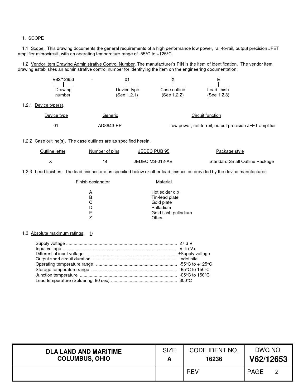

1. SCOPE 1.1 Scope. This drawing documents the general requirements of a high performance low power, rail-to-rail, output precision JFET amplifier microcircuit, with an operating temperature range of -55°C to +125°C. 1.2 Vendor Item Drawing Administrative Control Number. The manufacturer’s PIN is the item of identification. The vendor item drawing establishes an administrative control number for identifying the item on the engineering documentation: V62/12653 - 01 X E Drawing Device type Case outline Lead finish number (See 1.2.1) (See 1.2.2) (See 1.2.3) 1.2.1 Device type(s). Device type Generic Circuit function 01 AD8643-EP Low power, rail-to-rail, output precision JFET amplifier 1.2.2 Case outline(s). The case outlines are as specified herein. Outline letter Number of pins JEDEC PUB 95 Package style X 14 JEDEC MS-012-AB Standard Small Outline Package 1.2.3 Lead finishes. The lead finishes are as specified below or other lead finishes as provided by the device manufacturer: Finish designator Material A Hot solder dip B Tin-lead plate C Gold plate D Palladium E Gold flash palladium Z Other 1.3 Absolute maximum ratings. 1/ Supply voltage ... 27.3 V Input voltage .. V- to V+ Differential input voltage .. ±Supply voltage Output short circuit duration .. Indefinite Operating temperature range: ... -55°C to +125°C Storage temperature range ... -65°C to 150°C Junction temperature .. -65°C to 150°C Lead temperature (Soldering, 60 sec) ... 300°C
