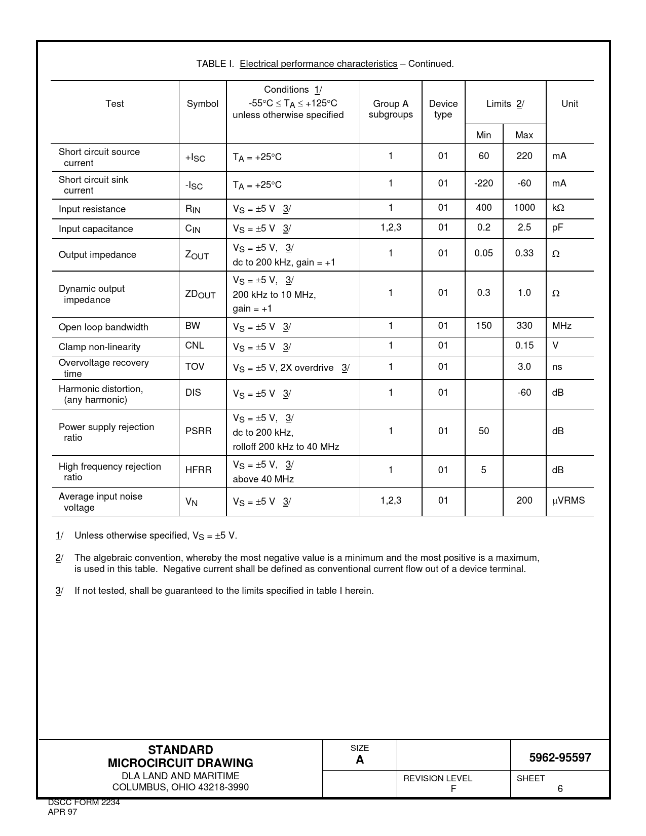

STANDARD. 5962-95597. MICROCIRCUIT DRAWING
STANDARD 5962-95597 MICROCIRCUIT DRAWING
TABLE I. Electrical performance characteristics – Continued. Conditions 1/ Test Symbol -55°C ≤ TA ≤ +125°C Group A Device Limits 2/ Unit unless otherwise specified subgroups type Min Max Short circuit source +I current SC TA = +25°C 1 01 60 220 mA Short circuit sink -I current SC TA = +25°C 1 01 -220 -60 mA Input resistance RIN VS = ±5 V 3/ 1 01 400 1000 kΩ Input capacitance CIN VS = ±5 V 3/ 1,2,3 01 0.2 2.5 pF VS = ±5 V, 3/ Output impedance ZOUT 1 01 0.05 0.33 Ω dc to 200 kHz, gain = +1 VS = ±5 V, 3/ Dynamic output ZD 200 kHz to 10 MHz, 1 01 0.3 1.0 Ω impedance OUT gain = +1 Open loop bandwidth BW VS = ±5 V 3/ 1 01 150 330 MHz Clamp non-linearity CNL VS = ±5 V 3/ 1 01 0.15 V Overvoltage recovery TOV V time S = ±5 V, 2X overdrive 3/ 1 01 3.0 ns Harmonic distortion, DIS V (any harmonic) S = ±5 V 3/ 1 01 -60 dB VS = ±5 V, 3/ Power supply rejection PSRR dc to 200 kHz, 1 01 50 dB ratio rolloff 200 kHz to 40 MHz High frequency rejection V HFRR S = ±5 V, 3/ 1 01 5 dB ratio above 40 MHz Average input noise V voltage N VS = ±5 V 3/ 1,2,3 01 200 µVRMS 1/ Unless otherwise specified, VS = ±5 V. 2/ The algebraic convention, whereby the most negative value is a minimum and the most positive is a maximum, is used in this table. Negative current shall be defined as conventional current flow out of a device terminal. 3/ If not tested, shall be guaranteed to the limits specified in table I herein.
STANDARD
SIZE
5962-95597 MICROCIRCUIT DRAWING A
DLA LAND AND MARITIME REVISION LEVEL SHEET COLUMBUS, OHIO 43218-3990 F 6 DSCC FORM 2234 APR 97 Document Outline DEPARTMENT OF DEFENSE SPECIFICATION DEPARTMENT OF DEFENSE STANDARDS
