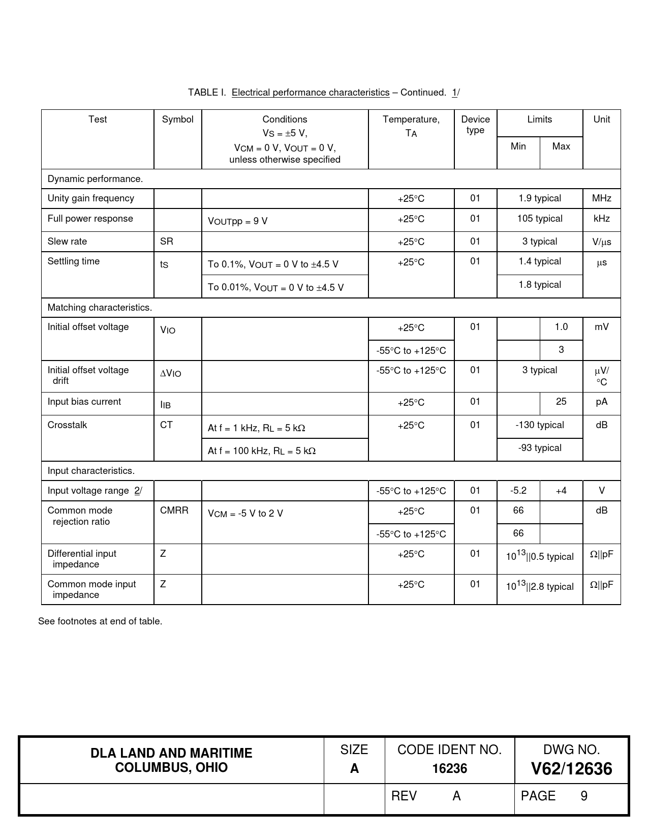

TABLE I. Electrical performance characteristics – Continued. 1/ Test Symbol Conditions Temperature, Device Limits Unit VS = 5 V, TA type VCM = 0 V, VOUT = 0 V, Min Max unless otherwise specified Dynamic performance. Unity gain frequency +25C 01 1.9 typical MHz Full power response VOUTpp = 9 V +25C 01 105 typical kHz Slew rate SR +25C 01 3 typical V/s Settling time tS To 0.1%, VOUT = 0 V to 4.5 V +25C 01 1.4 typical s To 0.01%, VOUT = 0 V to 4.5 V 1.8 typical Matching characteristics. Initial offset voltage VIO +25C 01 1.0 mV -55C to +125C 3 Initial offset voltage VIO -55C to +125C 01 3 typical V/ drift C Input bias current IIB +25C 01 25 pA Crosstalk CT At f = 1 kHz, RL = 5 k +25C 01 -130 typical dB At f = 100 kHz, RL = 5 k -93 typical Input characteristics. Input voltage range 2/ -55C to +125C 01 -5.2 +4 V Common mode CMRR VCM = -5 V to 2 V +25C 01 66 dB rejection ratio -55C to +125C 66 Differential input Z +25C 01 1013||0.5 typical ||pF impedance Common mode input Z +25C 01 1013||2.8 typical ||pF impedance See footnotes at end of table.
