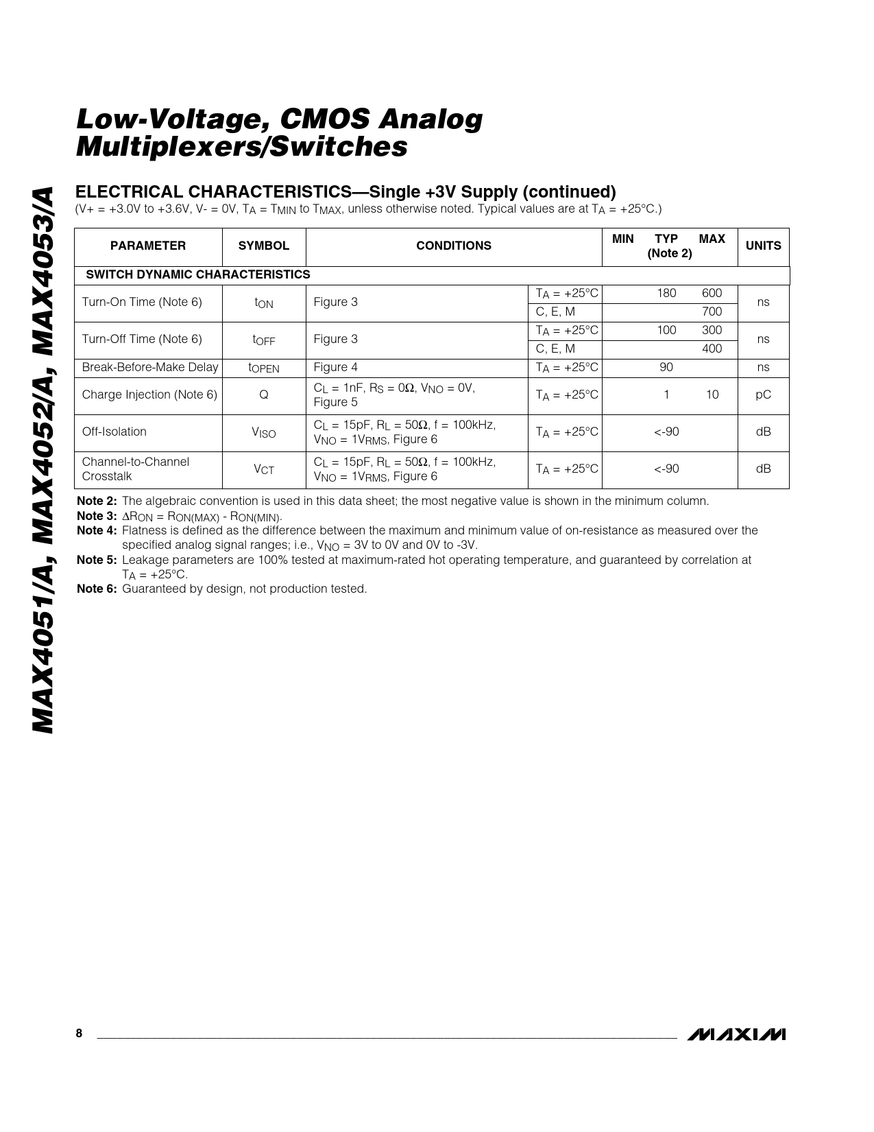

Low-Voltage, CMOS Analog Multiplexers/Switches. ELECTRICAL CHARACTERISTICS—Single +3V Supply (continued). MIN. TYP. MAX
Low-Voltage, CMOS Analog Multiplexers/Switches ELECTRICAL CHARACTERISTICS—Single +3V Supply (continued) MIN TYP MAX
(V+ = +3.0V to +3.6V, V- = 0V, TA = TMIN to TMAX, unless otherwise noted. Typical values are at TA = +25°C.)
MIN TYP MAX PARAMETER SYMBOL CONDITIONS UNITS (Note 2) DIGITAL I/O SWITCH DYNAMIC CHARACTERISTICS
TA = +25°C 180 600 Turn-On Time (Note 6) tON Figure 3 ns C, E, M 700 TA = +25°C 100 300 Turn-Off Time (Note 6) tOFF Figure 3 ns C, E, M 400 Break-Before-Make Delay tOPEN Figure 4 TA = +25°C 90 ns C Charge Injection (Note 6) Q L = 1nF, RS = 0Ω, VNO = 0V, TA = +25°C 1 10 pC Figure 5 C Off-Isolation V L = 15pF, RL = 50Ω, f = 100kHz, ISO TA = +25°C <-90 dB VNO = 1VRMS, Figure 6 Channel-to-Channel C V L = 15pF, RL = 50Ω, f = 100kHz, CT TA = +25°C <-90 dB Crosstalk VNO = 1VRMS, Figure 6
Note 2:
The algebraic convention is used in this data sheet; the most negative value is shown in the minimum column.
Note 3:
∆RON = RON(MAX) - RON(MIN).
Note 4:
Flatness is defined as the difference between the maximum and minimum value of on-resistance as measured over the specified analog signal ranges; i.e., VNO = 3V to 0V and 0V to -3V.
Note 5:
Leakage parameters are 100% tested at maximum-rated hot operating temperature, and guaranteed by correlation at TA = +25°C.
Note 6:
Guaranteed by design, not production tested.
