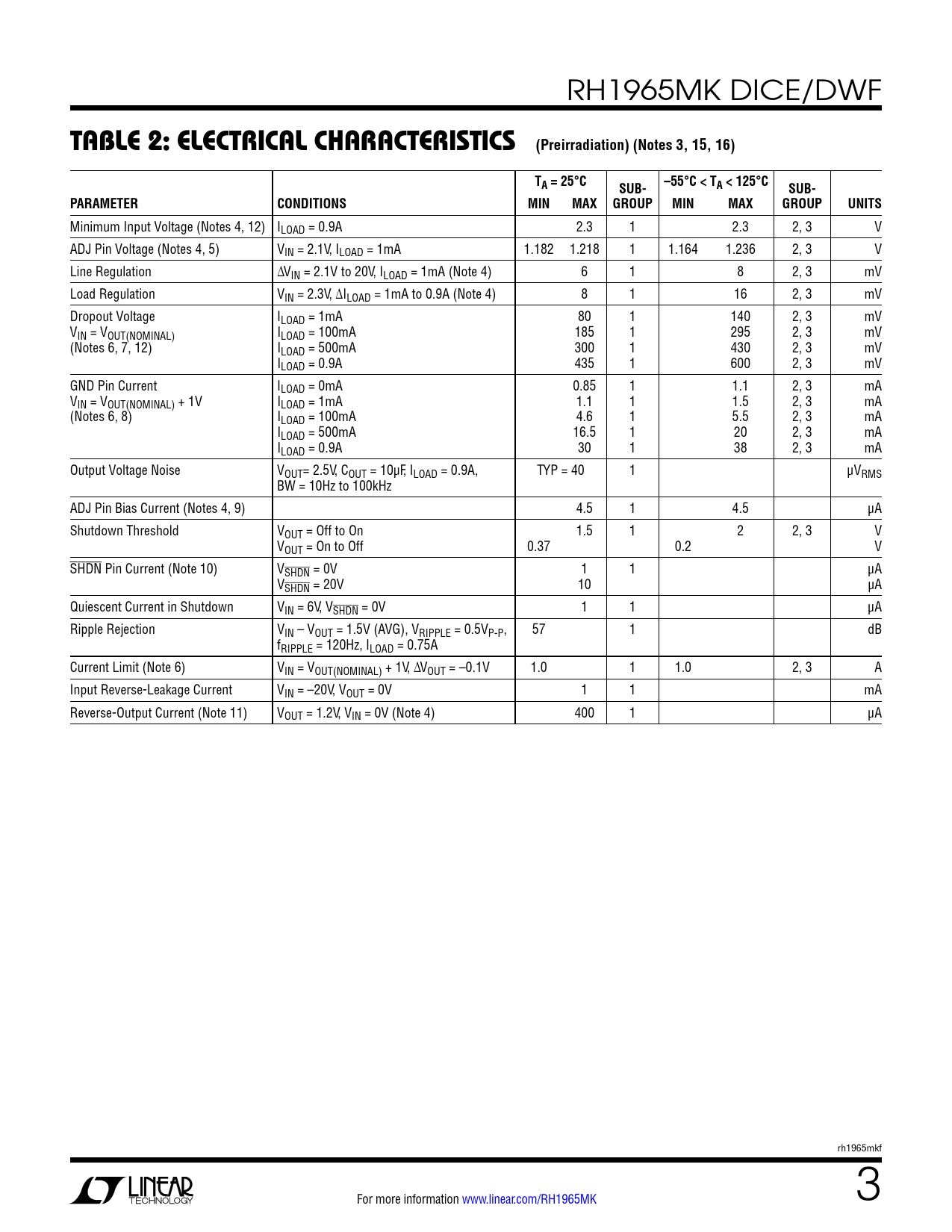

table 2: electrical characteristics (Preirradiation) (Notes 3, 15, 16). TA = 25°C. SUB-. –55°C < TA < 125°C. PARAMETER
table 2: electrical characteristics (Preirradiation) (Notes 3, 15, 16) TA = 25°C SUB- –55°C < TA < 125°C PARAMETER
RH1965MK DICE/DWF
table 2: electrical characteristics (Preirradiation) (Notes 3, 15, 16) TA = 25°C SUB- –55°C < TA < 125°C SUB- PARAMETER CONDITIONS MIN MAX GROUP MIN MAX GROUP UNITS
Minimum Input Voltage (Notes 4, 12) ILOAD = 0.9A 2.3 1 2.3 2, 3 V ADJ Pin Voltage (Notes 4, 5) VIN = 2.1V, ILOAD = 1mA 1.182 1.218 1 1.164 1.236 2, 3 V Line Regulation ∆VIN = 2.1V to 20V, ILOAD = 1mA (Note 4) 6 1 8 2, 3 mV Load Regulation VIN = 2.3V, ∆ILOAD = 1mA to 0.9A (Note 4) 8 1 16 2, 3 mV Dropout Voltage ILOAD = 1mA 80 1 140 2, 3 mV VIN = VOUT(NOMINAL) ILOAD = 100mA 185 1 295 2, 3 mV (Notes 6, 7, 12) ILOAD = 500mA 300 1 430 2, 3 mV ILOAD = 0.9A 435 1 600 2, 3 mV GND Pin Current ILOAD = 0mA 0.85 1 1.1 2, 3 mA VIN = VOUT(NOMINAL) + 1V ILOAD = 1mA 1.1 1 1.5 2, 3 mA (Notes 6, 8) ILOAD = 100mA 4.6 1 5.5 2, 3 mA ILOAD = 500mA 16.5 1 20 2, 3 mA ILOAD = 0.9A 30 1 38 2, 3 mA Output Voltage Noise VOUT= 2.5V, COUT = 10µF, ILOAD = 0.9A, TYP = 40 1 μVRMS BW = 10Hz to 100kHz ADJ Pin Bias Current (Notes 4, 9) 4.5 1 4.5 μA Shutdown Threshold VOUT = Off to On 1.5 1 2 2, 3 V VOUT = On to Off 0.37 0.2 V SHDN Pin Current (Note 10) VSHDN = 0V 1 1 μA VSHDN = 20V 10 µA Quiescent Current in Shutdown VIN = 6V, VSHDN = 0V 1 1 μA Ripple Rejection VIN – VOUT = 1.5V (AVG), VRIPPLE = 0.5VP-P, 57 1 dB fRIPPLE = 120Hz, ILOAD = 0.75A Current Limit (Note 6) VIN = VOUT(NOMINAL) + 1V, ∆VOUT = –0.1V 1.0 1 1.0 2, 3 A Input Reverse-Leakage Current VIN = –20V, VOUT = 0V 1 1 mA Reverse-Output Current (Note 11) VOUT = 1.2V, VIN = 0V (Note 4) 400 1 μA rh1965mkf For more information www.linear.com/RH1965MK 3 Document Outline Features Description Dice Pinout Absolute Maximum Ratings Table 1: DICE/DWF Electrical Test Limits Table 2: Electrical Characteristics Table 3: Electrical Characteristics Table 4. Post Burn-In Endpoints and Delta Limit Requirements Table 5. Electrical Test Requirements Total Dose Bias Circuit Burn-In Circuit Typical Performance Characteristics
