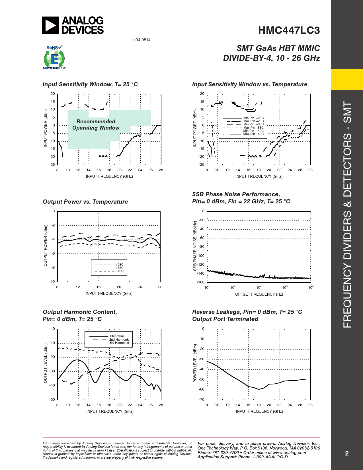

HMC447LC3. SMT GaAs HBT MMIC. DIVIDE-BY-4, 10 - 26 GHz. Input Sensitivity Window, T= 25 °C
HMC447LC3 SMT GaAs HBT MMIC DIVIDE-BY-4, 10 - 26 GHz Input Sensitivity Window, T= 25 °C
HMC447LC3
v04.0514
SMT GaAs HBT MMIC DIVIDE-BY-4, 10 - 26 GHz Input Sensitivity Window, T= 25 °C Input Sensitivity Window vs. Temperature
20 20 15 15 T 10 10 5 5 M Min Pin +25C Max Pin +25C
Recommended
0 0 Min Pin +85C Max Pin +85C
Operating Window
-5 -5 Min Pin -40C Max Pin -40C -10 -10 S - S INPUT POWER (dBm) INPUT POWER (dBm) -15 -15 R -20 -20 O T -25 -25 8 10 12 14 16 18 20 22 24 26 28 8 10 12 14 16 18 20 22 24 26 28 C INPUT FREQUENCY (GHz) INPUT FREQUENCY (GHz) E T E
SSB Phase Noise Performance, Output Power vs. Temperature Pin= 0 dBm, Fin = 22 GHz, T= 25 °C
0 0 S & D -20 -2 R -40 E (dBm) -4 -60 ID POWER -80 -6 IV -100 OUTPUT +25C -120 -8 +85C -40C SSB PHASE NOISE (dBc/Hz) Y D -140 C -10 -160 N 8 12 16 20 24 28 102 103 104 105 106 E INPUT FREQUENCY (GHz) OFFSET FREQUENCY (Hz) U Q
Output Harmonic Content, Reverse Leakage, Pin= 0 dBm, T= 25 °C
E
Pin= 0 dBm, T= 25 °C Output Port Terminated
R 0 0 F Pfeedthru 2nd Harmonic -10 -10 3rd Harmonic -20 -20 -30 -40 -30 -50 OUTPUT LEVEL (dBm) POWER LEVEL (dBm) -40 -60 -50 -70 8 10 12 14 16 18 20 22 24 26 28 8 10 12 14 16 18 20 22 24 26 28 INPUT FREQUENCY (GHz) INPUT FREQUENCY (GHz) Inf F or o m r p atio r n ifc ur e n , d ishe e d lbiv y e A r n y a alog n D d t evic o p es is la beclie o eved rd to ebre sa: H ccur iattti e tae M nd re ilicarbloew . H a o ve C wever, o n rp o For price, delivery, and to place orders: Analog Devices, Inc., responsibility is assumed by Analog Devices for its use, nor for any infringements of patents or other oration, 2 Elizabeth Drive, Chelmsford, MA 01824 One Technology Way, P.O. Box 9106, Norwood, MA 02062-9106 Phone: 978-250-3343 Fax: 978-250-3373 O rights of third parties that may result from its use. Specifications subject to change without notice. No P rd hone e r O : 7 n 81- -3li 2n 9 e a -47 t w 0 w 0 • O w rd .h e it r o t niltie n .c e ao t m license is granted by implication or otherwise under any patent or patent rights of Analog Devices. www.analog.com
