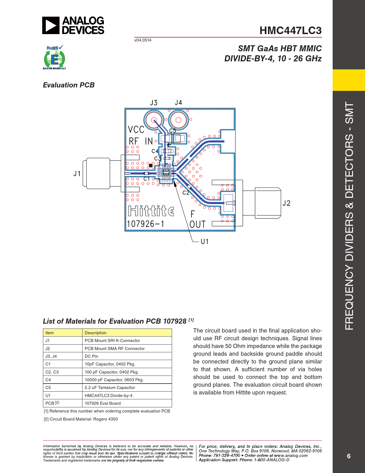

HMC447LC3. SMT GaAs HBT MMIC. DIVIDE-BY-4, 10 - 26 GHz. Evaluation PCB. List of Materials for Evaluation PCB 107928 [1]
HMC447LC3 SMT GaAs HBT MMIC DIVIDE-BY-4, 10 - 26 GHz Evaluation PCB List of Materials for Evaluation PCB 107928 [1]
HMC447LC3
v04.0514
T M S - S R O T C E T E S & D R E ID IV Y D C N E U Q E
R The circuit board used in the final application sho- F Item Description uld use RF circuit design techniques. Signal lines J1 PCB Mount SRI K-Connector should have 50 Ohm impedance while the package J2 PCB Mount SMA RF Connector ground leads and backside ground paddle should J3, J4 DC Pin be connected directly to the ground plane similar C1 10pF Capacitor, 0402 Pkg. to that shown. A sufficient number of via holes C2, C3 100 pF Capacitor, 0402 Pkg. should be used to connect the top and bottom C4 10000 pF Capacitor, 0603 Pkg. ground planes. The evaluation circuit board shown C5 2.2 uF Tantalum Capacitor is available from Hittite upon request. U1 HMC447LC3 Divide-by-4 PCB [2] 107926 Eval Board [1] Reference this number when ordering complete evaluation PCB [2] Circuit Board Material: Rogers 4350 Inf F or o m r p atio r n ifc ur e n , d ishe e d lbiv y e A r n y a alog n D d t evic o p es is la beclie o eved rd to ebre sa: H ccur iattti e tae M nd re ilicarbloew . H a o ve C wever, o n rp o For price, delivery, and to place orders: Analog Devices, Inc., responsibility is assumed by Analog Devices for its use, nor for any infringements of patents or other oration, 2 Elizabeth Drive, Chelmsford, MA 01824 One Technology Way, P.O. Box 9106, Norwood, MA 02062-9106 Phone: 978-250-3343 Fax: 978-250-3373 O rights of third parties that may result from its use. Specifications subject to change without notice. No P rd hone e r O : 7 n 81- -3li 2n 9 e a -47 t w 0 w 0 • O w rd .h e it r o t niltie n .c e ao t m license is granted by implication or otherwise under any patent or patent rights of Analog Devices. www.analog.com
