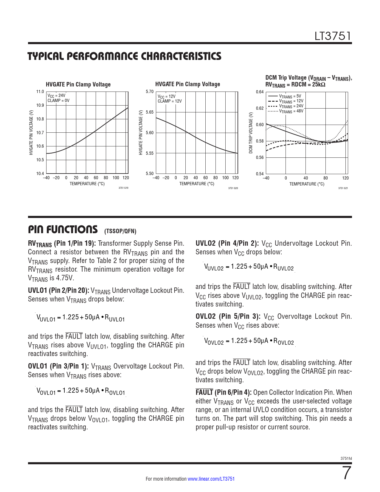

TYPICAL PERFORMANCE CHARACTERISTICS. DCM Trip Voltage (VDRAIN – VTRANS),. HVGATE Pin Clamp Voltage. RVTRANS = RDCM = 25kΩ
TYPICAL PERFORMANCE CHARACTERISTICS DCM Trip Voltage (VDRAIN – VTRANS), HVGATE Pin Clamp Voltage RVTRANS = RDCM = 25kΩ
LT3751
TYPICAL PERFORMANCE CHARACTERISTICS DCM Trip Voltage (VDRAIN – VTRANS), HVGATE Pin Clamp Voltage HVGATE Pin Clamp Voltage RVTRANS = RDCM = 25kΩ
11.0 5.70 0.64 VCC = 24V VCC = 12V VTRANS = 5V CLAMP = 0V CLAMP = 12V VTRANS = 12V 10.9 0.62 VTRANS = 24V 5.65 VTRANS = 48V 10.8 TAGE (V) TAGE (V) TAGE (V) 0.60 10.7 5.60 TE PIN VOL 0.58 10.6 TE PIN VOL HVGA HVGA 5.55 DCM TRIP VOL 10.5 0.56 10.4 5.50 0.54 –40 –20 0 20 40 60 80 100 120 –40 –20 0 20 40 60 80 100 120 –40 0 40 80 120 TEMPERATURE (°C) TEMPERATURE (°C) TEMPERATURE (°C) 3751 G19 3751 G20 3751 G21
