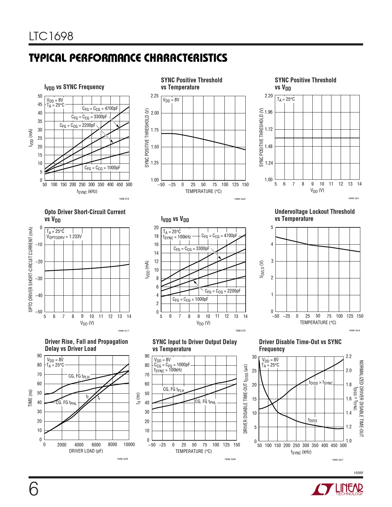

Pages / Page24 / 6 — TYPICAL PERFOR A CE CHARACTERISTICS. SYNC Positive Threshold. IVDD vs …
TYPICAL PERFOR A CE CHARACTERISTICS. SYNC Positive Threshold. IVDD vs SYNC Frequency. vs Temperature. vs VDD
TYPICAL PERFOR A CE CHARACTERISTICS SYNC Positive Threshold IVDD vs SYNC Frequency vs Temperature vs VDD
LTC1698
W U TYPICAL PERFOR A CE CHARACTERISTICS SYNC Positive Threshold SYNC Positive Threshold IVDD vs SYNC Frequency vs Temperature vs VDD
50 2.25 2.20 V T DD = 8V VDD = 8V A = 25°C 45 TA = 25°C CFG = CCG = 4700pF 40 2.00 1.96 CFG = CCG = 3300pF 35 CFG = CCG = 2200pF 30 1.75 1.72 (mA) 25 I VDD 20 1.50 1.48 15 10 1.25 1.24 SYNC POSITIVE THRESHOLD (V) C SYNC POSITIVE THRESHOLD (V) FG = CCG = 1000pF 5 0 1.00 1.00 50 100 150 200 250 300 350 400 450 500 –50 –25 0 25 50 75 100 125 150 5 6 7 8 9 10 11 12 13 14 f V SYNC (kHz) TEMPERATURE (°C) DD (V) 1698 G19 1698 G20 1698 G21
Opto Driver Short-Circuit Current Undervoltage Lockout Threshold vs V I vs Temperature DD VDD vs VDD
0 20 5 TA = 25°C TA = 25°C VOPTODRV = 1.233V 18 fSYNC = 100kHz CFG = CCG = 4700pF –10 16 4 CFG = CCG = 3300pF 14 –20 12 3 (V) (mA) 10 UVLO I VDD V 8 2 –30 6 CFG = CCG = 2200pF 4 1 –40 CFG = CCG = 1000pF 2 OPTO DRIVER SHORT-CIRCUIT CURRENT (mA) –50 0 0 5 6 7 8 9 10 11 12 13 14 5 6 7 8 9 10 11 12 13 14 –50 –25 0 25 50 75 100 125 150 V V TEMPERATURE ( DD (V) DD (V) °C) 1698 G17 1698 G18 1698 G24
Driver Rise, Fall and Propagation SYNC Input to Driver Output Delay Driver Disable Time-Out vs SYNC Delay vs Driver Load vs Temperature Frequency
