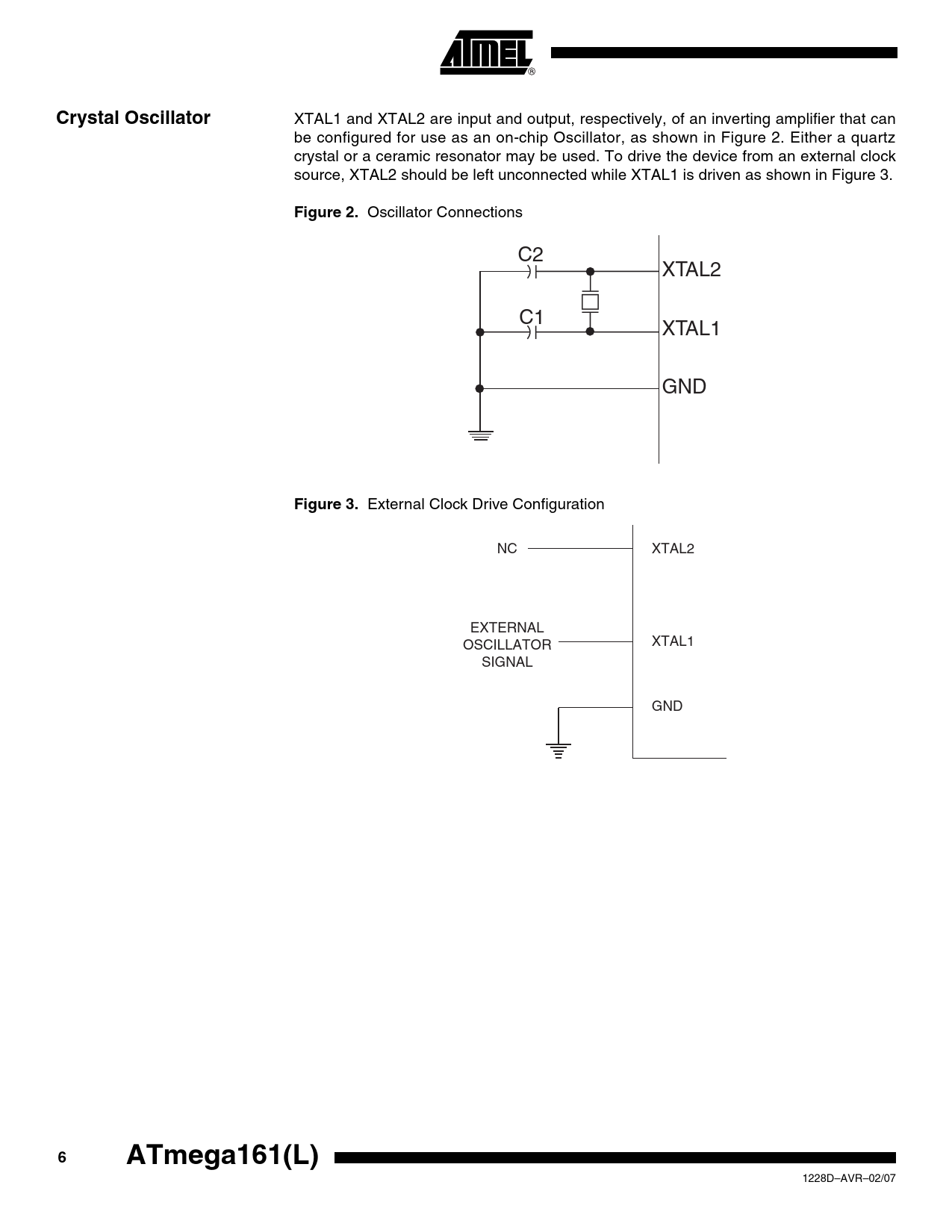

Crystal Oscillator
XTAL1 and XTAL2 are input and output, respectively, of an inverting amplifier that can be configured for use as an on-chip Oscillator, as shown in Figure 2. Either a quartz crystal or a ceramic resonator may be used. To drive the device from an external clock source, XTAL2 should be left unconnected while XTAL1 is driven as shown in Figure 3.
Figure 2.
Oscillator Connections C2 XTAL2 C1 XTAL1 GND
Figure 3.
External Clock Drive Configuration NC XTAL2 EXTERNAL XTAL1 OSCILLATOR SIGNAL GND
