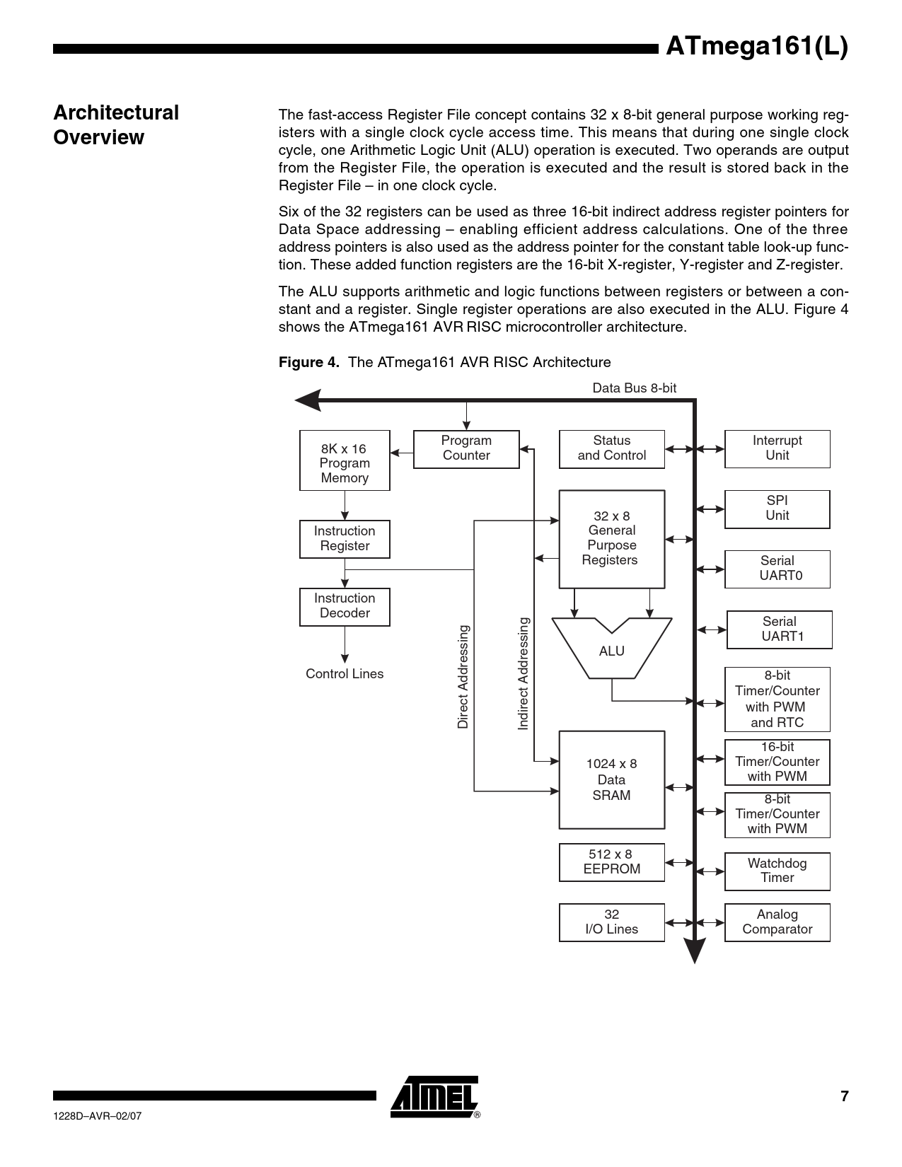

ATmega161(L). Architectural. Overview. Figure 4
ATmega161(L) Architectural Overview Figure 4
The fast-access Register File concept contains 32 x 8-bit general purpose working reg-
Overview
isters with a single clock cycle access time. This means that during one single clock cycle, one Arithmetic Logic Unit (ALU) operation is executed. Two operands are output from the Register File, the operation is executed and the result is stored back in the Register File – in one clock cycle. Six of the 32 registers can be used as three 16-bit indirect address register pointers for Data Space addressing – enabling efficient address calculations. One of the three address pointers is also used as the address pointer for the constant table look-up func- tion. These added function registers are the 16-bit X-register, Y-register and Z-register. The ALU supports arithmetic and logic functions between registers or between a con- stant and a register. Single register operations are also executed in the ALU. Figure 4 shows the ATmega161 AVR RISC microcontroller architecture.
Figure 4.
The ATmega161 AVR RISC Architecture Data Bus 8-bit Program Status Interrupt 8K x 16 Counter and Control Unit Program Memory SPI 32 x 8 Unit Instruction General Register Purpose Registers Serial UART0 Instruction Decoder Serial UART1 ALU Control Lines 8-bit Timer/Counter with PWM Direct Addressing and RTC Indirect Addressing 16-bit Timer/Counter 1024 x 8 with PWM Data SRAM 8-bit Timer/Counter with PWM 512 x 8 Watchdog EEPROM Timer 32 Analog I/O Lines Comparator
