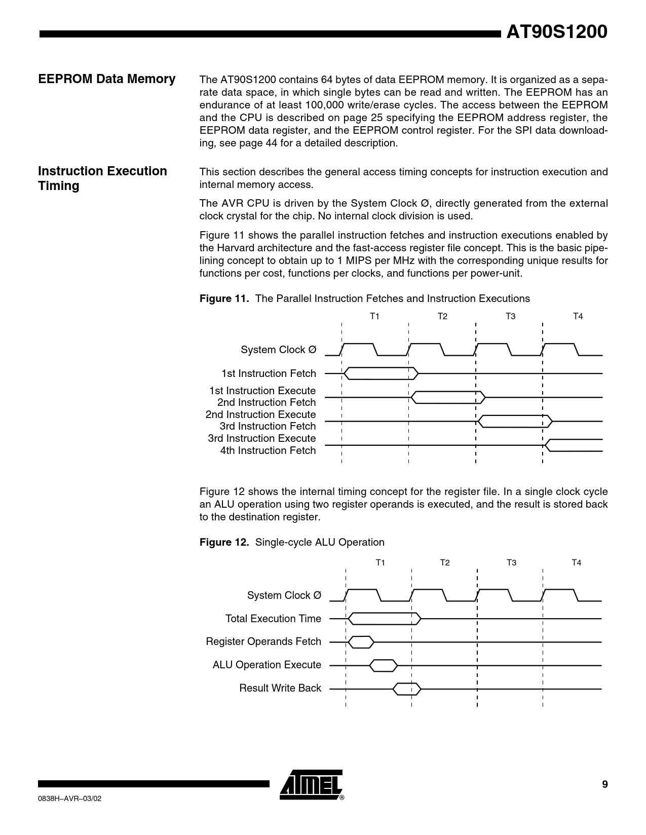

AT90S1200 EEPROM Data Memory
The AT90S1200 contains 64 bytes of data EEPROM memory. It is organized as a sepa- rate data space, in which single bytes can be read and written. The EEPROM has an endurance of at least 100,000 write/erase cycles. The access between the EEPROM and the CPU is described on page 25 specifying the EEPROM address register, the EEPROM data register, and the EEPROM control register. For the SPI data download- ing, see page 44 for a detailed description.
Instruction Execution
This section describes the general access timing concepts for instruction execution and
Timing
internal memory access. The AVR CPU is driven by the System Clock Ø, directly generated from the external clock crystal for the chip. No internal clock division is used. Figure 11 shows the parallel instruction fetches and instruction executions enabled by the Harvard architecture and the fast-access register file concept. This is the basic pipe- lining concept to obtain up to 1 MIPS per MHz with the corresponding unique results for functions per cost, functions per clocks, and functions per power-unit.
Figure 11.
The Parallel Instruction Fetches and Instruction Executions T1 T2 T3 T4 System Clock Ø 1st Instruction Fetch 1st Instruction Execute 2nd Instruction Fetch 2nd Instruction Execute 3rd Instruction Fetch 3rd Instruction Execute 4th Instruction Fetch Figure 12 shows the internal timing concept for the register file. In a single clock cycle an ALU operation using two register operands is executed, and the result is stored back to the destination register.
Figure 12.
Single-cycle ALU Operation T1 T2 T3 T4 System Clock Ø Total Execution Time Register Operands Fetch ALU Operation Execute Result Write Back
