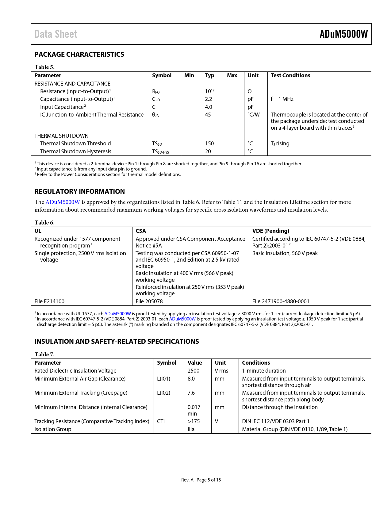

Data Sheet. ADuM5000W. PACKAGE CHARACTERISTICS. Table 5. Parameter. Symbol. Min. Typ. Max. Unit. Test Conditions. REGULATORY INFORMATION
Data Sheet ADuM5000W PACKAGE CHARACTERISTICS Table 5 Parameter Symbol Min Typ Max Unit Test Conditions REGULATORY INFORMATION
link to page 12 link to page 5 link to page 7 link to page 14 link to page 1
Data Sheet ADuM5000W PACKAGE CHARACTERISTICS Table 5. Parameter Symbol Min Typ Max Unit Test Conditions
RESISTANCE AND CAPACITANCE Resistance (Input-to-Output)1 RI-O 1012 Ω Capacitance (Input-to-Output)1 CI-O 2.2 pF f = 1 MHz Input Capacitance2 CI 4.0 pF IC Junction-to-Ambient Thermal Resistance θJA 45 °C/W Thermocouple is located at the center of the package underside; test conducted on a 4-layer board with thin traces3 THERMAL SHUTDOWN Thermal Shutdown Threshold TSSD 150 °C TJ rising Thermal Shutdown Hysteresis TSSD-HYS 20 °C 1 This device is considered a 2-terminal device; Pin 1 through Pin 8 are shorted together, and Pin 9 through Pin 16 are shorted together. 2 Input capacitance is from any input data pin to ground. 3 Refer to the Power Considerations section for thermal model definitions.
The ADuM5000W is approved by the organizations listed in Table 6. Refer to Table 11 and the Insulation Lifetime section for more information about recommended maximum working voltages for specific cross isolation waveforms and insulation levels.
Table 6. UL CSA VDE (Pending)
Recognized under 1577 component Approved under CSA Component Acceptance Certified according to IEC 60747-5-2 (VDE 0884, recognition program1 Notice #5A Part 2):2003-012 Single protection, 2500 V rms isolation Testing was conducted per CSA 60950-1-07 Basic insulation, 560 V peak voltage and IEC 60950-1, 2nd Edition at 2.5 kV rated voltage Basic insulation at 400 V rms (566 V peak) working voltage Reinforced insulation at 250 V rms (353 V peak) working voltage File E214100 File 205078 File 2471900-4880-0001 1 In accordance with UL 1577, each ADuM5000W is proof tested by applying an insulation test voltage ≥ 3000 V rms for 1 sec (current leakage detection limit = 5 µA). 2 In accordance with IEC 60747-5-2 (VDE 0884, Part 2):2003-01, each ADuM5000W is proof tested by applying an insulation test voltage ≥ 1050 V peak for 1 sec (partial discharge detection limit = 5 pC). The asterisk (*) marking branded on the component designates IEC 60747-5-2 (VDE 0884, Part 2):2003-01.
INSULATION AND SAFETY-RELATED SPECIFICATIONS Table 7. Parameter Symbol Value Unit Conditions
Rated Dielectric Insulation Voltage 2500 V rms 1-minute duration Minimum External Air Gap (Clearance) L(I01) 8.0 mm Measured from input terminals to output terminals, shortest distance through air Minimum External Tracking (Creepage) L(I02) 7.6 mm Measured from input terminals to output terminals, shortest distance path along body Minimum Internal Distance (Internal Clearance) 0.017 mm Distance through the insulation min Tracking Resistance (Comparative Tracking Index) CTI >175 V DIN IEC 112/VDE 0303 Part 1 Isolation Group IIIa Material Group (DIN VDE 0110, 1/89, Table 1) Rev. A | Page 5 of 15 Document Outline FEATURES APPLICATIONS FUNCTIONAL BLOCK DIAGRAM GENERAL DESCRIPTION REVISION HISTORY SPECIFICATIONS ELECTRICAL CHARACTERISTICS—5 V PRIMARY INPUT SUPPLY/5 V SECONDARY ISOLATED SUPPLY ELECTRICAL CHARACTERISTICS—3.3 V PRIMARY INPUT SUPPLY/3.3 V SECONDARY ISOLATED SUPPLY ELECTRICAL CHARACTERISTICS—5 V PRIMARY INPUT SUPPLY/3.3 V SECONDARY ISOLATED SUPPLY PACKAGE CHARACTERISTICS REGULATORY INFORMATION INSULATION AND SAFETY-RELATED SPECIFICATIONS IEC 60747-5-2 (VDE 0884, PART 2):2003-01 INSULATION CHARACTERISTICS Thermal Derating Curve RECOMMENDED OPERATING CONDITIONS ABSOLUTE MAXIMUM RATINGS ESD CAUTION PIN CONFIGURATION AND FUNCTION DESCRIPTIONS TYPICAL PERFORMANCE CHARACTERISTICS APPLICATIONS INFORMATION PCB LAYOUT START-UP BEHAVIOR EMI CONSIDERATIONS THERMAL ANALYSIS CURRENT LIMIT AND THERMAL OVERLOAD PROTECTION POWER CONSIDERATIONS INCREASING AVAILABLE POWER INSULATION LIFETIME OUTLINE DIMENSIONS ORDERING GUIDE AUTOMOTIVE PRODUCTS
