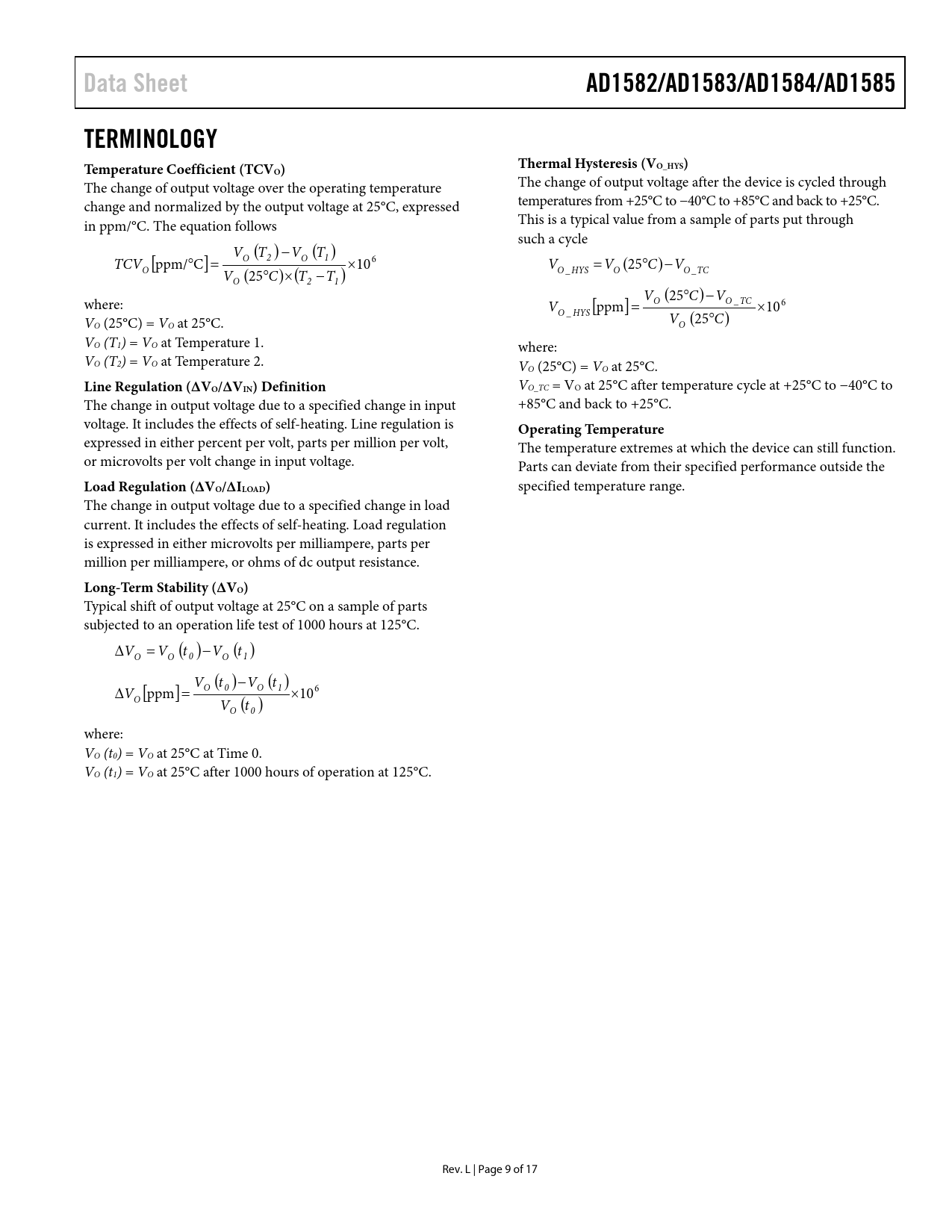

Data Sheet. AD1582/AD1583/AD1584/AD1585. TERMINOLOGY Temperature Coefficient (TCV. Thermal Hysteresis (VO_HYS)
Data Sheet AD1582/AD1583/AD1584/AD1585 TERMINOLOGY Temperature Coefficient (TCV Thermal Hysteresis (VO_HYS)
Data Sheet AD1582/AD1583/AD1584/AD1585 TERMINOLOGY Temperature Coefficient (TCV Thermal Hysteresis (VO_HYS) O)
The change of output voltage over the operating temperature The change of output voltage after the device is cycled through change and normalized by the output voltage at 25°C, expressed temperatures from +25°C to −40°C to +85°C and back to +25°C. in ppm/°C. The equation follows This is a typical value from a sample of parts put through such a cycle TCV [ V T −V T V = ° − _ V (25 C) O ppm/ C ° ] ( ) ( ) O 2 O 1 6 = × V V ( °C)×(T −T ) 10 O HYS O O _TC O 25 2 1 V ° O C − where: V [ V O HYS ppm] (25 ) O_TC 6 = × _ 10 V V ( O 25°C) O (25°C) = VO at 25°C. VO (T1) = VO at Temperature 1. where: VO (T2) = VO at Temperature 2. VO (25°C) = VO at 25°C.
Line Regulation (ΔVO/ΔVIN) Definition
VO_TC = VO at 25°C after temperature cycle at +25°C to −40°C to The change in output voltage due to a specified change in input +85°C and back to +25°C. voltage. It includes the effects of self-heating. Line regulation is
Operating Temperature
expressed in either percent per volt, parts per million per volt, The temperature extremes at which the device can still function. or microvolts per volt change in input voltage. Parts can deviate from their specified performance outside the
Load Regulation (ΔVO/ΔILOAD)
specified temperature range. The change in output voltage due to a specified change in load current. It includes the effects of self-heating. Load regulation is expressed in either microvolts per milliampere, parts per million per milliampere, or ohms of dc output resistance.
Long-Term Stability (ΔVO)
Typical shift of output voltage at 25°C on a sample of parts subjected to an operation life test of 1000 hours at 125°C. V ∆ = V (t )−V (t ) O O 0 O 1 V t V t ∆V [ − O ppm] ( ) ( ) O 0 O 1 6 = V (t ) ×10 O 0 where: VO (t0) = VO at 25°C at Time 0. VO (t1) = VO at 25°C after 1000 hours of operation at 125°C. Rev. L | Page 9 of 17 Document Outline FEATURES APPLICATIONS PIN CONFIGURATION GENERAL DESCRIPTION TABLE OF CONTENTS REVISION HISTORY SPECIFICATIONS AD1582 SPECIFICATIONS AD1583 SPECIFICATIONS AD1584 SPECIFICATIONS AD1585 SPECIFICATIONS ABSOLUTE MAXIMUM RATINGS ESD CAUTION TERMINOLOGY TYPICAL PERFORMANCE CHARACTERISTICS THEORY OF OPERATION APPLICATIONS INFORMATION TEMPERATURE PERFORMANCE VOLTAGE OUTPUT NONLINEARITY VS. TEMPERATURE OUTPUT VOLTAGE HYSTERESIS SOLDER HEAT EFFECT SUPPLY CURRENT VS. TEMPERATURE SUPPLY VOLTAGE AC PERFORMANCE NOISE PERFORMANCE AND REDUCTION TURN-ON TIME DYNAMIC PERFORMANCE OUTLINE DIMENSIONS ORDERING GUIDE AUTOMOTIVE APPLICATIONS
