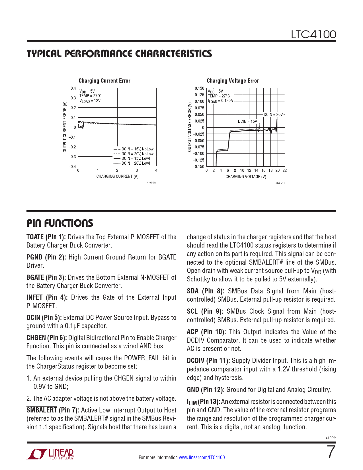

Typical perForMance characTerisTics. Charging Current Error. Charging Voltage Error. pin FuncTions TGATE (Pin 1):
Typical perForMance characTerisTics Charging Current Error Charging Voltage Error pin FuncTions TGATE (Pin 1):
LTC4100
0.4 0.150 VDD = 5V VDD = 5V 0.125 0.3 TEMP = 27°C TEMP = 27°C VLOAD = 12V 0.100 ILOAD = 0.120A 0.2 0.075 0.050 DCIN = 20V 0.1 0.025 DCIN = 15V 0 TAGE ERROR (V) 0 –0.025 –0.1 –0.050 –0.2 –0.075 OUTPUT CURRENT ERROR (A) DCIN = 15V, NoLowI OUTPUT VOL DCIN = 20V, NoLowI –0.100 –0.3 DCIN = 15V, LowI –0.125 DCIN = 20V, LowI –0.4 –0.150 0 1 2 3 4 0 2 4 6 8 10 12 14 16 18 20 22 CHARGING CURRENT (A) CHARGING VOLTAGE (V) 4100 G10 4100 G11
