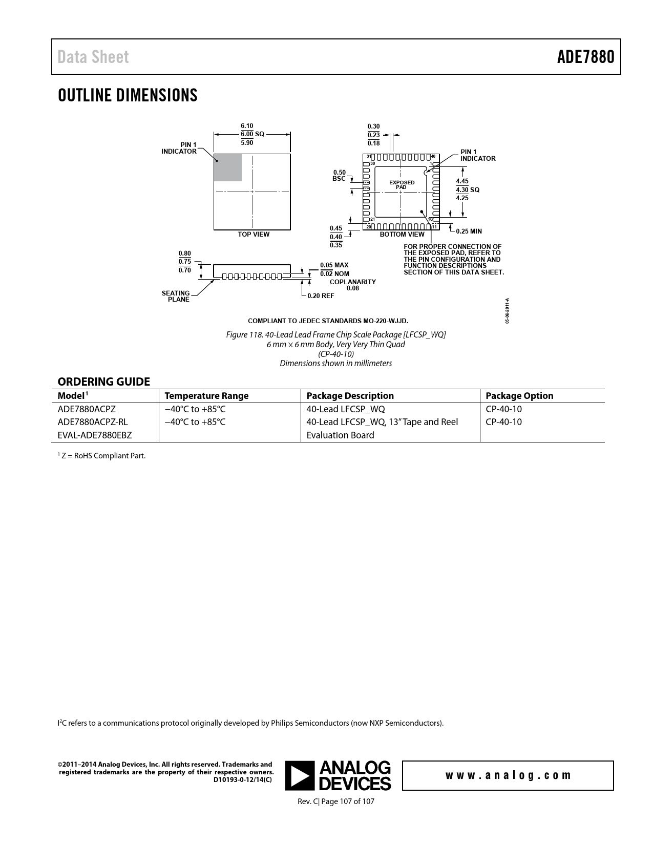

Data Sheet. ADE7880. OUTLINE DIMENSIONS. 6.10. 0.30. 6.00 SQ. 0.23. PIN 1. 5.90. 0.18. INDICATOR. 0.50. BSC. EXPOSED. 4.45. PAD. 4.30 SQ. 4.25. 0.45
Data Sheet ADE7880 OUTLINE DIMENSIONS 6.10 0.30 6.00 SQ 0.23 PIN 1 5.90 0.18 INDICATOR 0.50 BSC EXPOSED 4.45 PAD 4.30 SQ 4.25 0.45
Data Sheet ADE7880 OUTLINE DIMENSIONS 6.10 0.30 6.00 SQ 0.23 PIN 1 5.90 0.18 INDICATOR PIN 1 31 40 INDICATOR 30 1 0.50 BSC EXPOSED 4.45 PAD 4.30 SQ 4.25 21 10 0.45 20 11 TOP VIEW BOTTOM VIEW 0.25 MIN 0.40 0.35 FOR PROPER CONNECTION OF 0.80 THE EXPOSED PAD, REFER TO 0.75 THE PIN CONFIGURATION AND 0.05 MAX 0.70 FUNCTION DESCRIPTIONS 0.02 NOM SECTION OF THIS DATA SHEET. COPLANARITY 0.08 SEATING PLANE 0.20 REF A 11- 20 06- COMPLIANT TO JEDEC STANDARDS MO-220-WJJD. 05-
Figure 118. 40-Lead Lead Frame Chip Scale Package [LFCSP_WQ] 6 mm × 6 mm Body, Very Very Thin Quad (CP-40-10) Dimensions shown in millimeters
ORDERING GUIDE Model1 Temperature Range Package Description Package Option
ADE7880ACPZ −40°C to +85°C 40-Lead LFCSP_WQ CP-40-10 ADE7880ACPZ-RL −40°C to +85°C 40-Lead LFCSP_WQ, 13” Tape and Reel CP-40-10 EVAL-ADE7880EBZ Evaluation Board 1 Z = RoHS Compliant Part. I2C refers to a communications protocol original y developed by Philips Semiconductors (now NXP Semiconductors).
