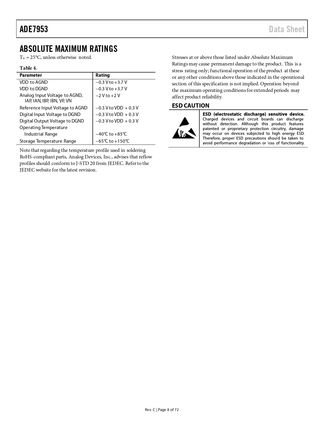

ADE7953. Data Sheet. ABSOLUTE MAXIMUM RATINGS. Table 4. Parameter. Rating. ESD CAUTION
ADE7953 Data Sheet ABSOLUTE MAXIMUM RATINGS Table 4 Parameter Rating ESD CAUTION
TA = 25°C, unless otherwise noted. Stresses at or above those listed under Absolute Maximum Ratings may cause permanent damage to the product. This is a
Table 4.
stress rating only; functional operation of the product at these
Parameter Rating
or any other conditions above those indicated in the operational VDD to AGND −0.3 V to +3.7 V section of this specification is not implied. Operation beyond VDD to DGND −0.3 V to +3.7 V the maximum operating conditions for extended periods may Analog Input Voltage to AGND, −2 V to +2 V affect product reliability. IAP, IAN, IBP, IBN, VP, VN Reference Input Voltage to AGND −0.3 V to VDD + 0.3 V
ESD CAUTION
Digital Input Voltage to DGND −0.3 V to VDD + 0.3 V Digital Output Voltage to DGND −0.3 V to VDD + 0.3 V Operating Temperature Industrial Range −40°C to +85°C Storage Temperature Range −65°C to +150°C Note that regarding the temperature profile used in soldering RoHS-compliant parts, Analog Devices, Inc., advises that reflow profiles should conform to J-STD 20 from JEDEC. Refer to the JEDEC website for the latest revision. Rev. C | Page 8 of 72 Document Outline FEATURES GENERAL DESCRIPTION FUNCTIONAL BLOCK DIAGRAM REVISION HISTORY SPECIFICATIONS TIMING CHARACTERISTICS SPI Interface Timing SPI Interface Timing Diagram I2C Interface Timing I2C Interface Timing Diagram ABSOLUTE MAXIMUM RATINGS ESD CAUTION PIN CONFIGURATION AND FUNCTION DESCRIPTIONS TYPICAL PERFORMANCE CHARACTERISTICS TEST CIRCUIT TERMINOLOGY ADE7953 POWER-UP PROCEDURE REQUIRED REGISTER SETTING THEORY OF OPERATION ANALOG INPUTS Current Channel A Current Channel B Voltage Channel ANALOG-TO-DIGITAL CONVERSION Oversampling Noise Shaping Antialiasing Filter CURRENT CHANNEL ADCS di/dt Current Sensor and Digital Integrator VOLTAGE CHANNEL ADC REFERENCE CIRCUIT ROOT MEAN SQUARE MEASUREMENT CURRENT CHANNEL RMS CALCULATION VOLTAGE CHANNEL RMS CALCULATION ACTIVE POWER CALCULATION SIGN OF ACTIVE POWER CALCULATION ACTIVE ENERGY CALCULATION Active Energy Integration Time Under Steady Load Active Energy Line Cycle Accumulation Mode ACTIVE ENERGY ACCUMULATION MODES Signed Accumulation Mode Positive-Only Accumulation Mode Absolute Accumulation Mode REACTIVE POWER CALCULATION SIGN OF REACTIVE POWER CALCULATION REACTIVE ENERGY CALCULATION Reactive Energy Integration Time Under Steady Load Reactive Energy Line Cycle Accumulation Mode REACTIVE ENERGY ACCUMULATION MODES Signed Accumulation Mode Antitamper Accumulation Mode Absolute Accumulation Mode APPARENT POWER CALCULATION APPARENT ENERGY CALCULATION Apparent Energy Integration Time Under Steady Load Apparent Energy Line Cycle Accumulation Mode AMPERE-HOUR ACCUMULATION ENERGY-TO-FREQUENCY CONVERSION PULSE OUTPUT CHARACTERISTICS ENERGY CALIBRATION GAIN CALIBRATION Current Channel Gain Adjustment PHASE CALIBRATION OFFSET CALIBRATION Power Offsets RMS Offsets PERIOD MEASUREMENT INSTANTANEOUS POWERS AND WAVEFORM SAMPLING POWER FACTOR USING THE LINE CYCLE ACCUMULATION MODE TO DETERMINE THE POWER FACTOR POWER FACTOR WITH NO-LOAD DETECTION ANGLE MEASUREMENT NO-LOAD DETECTION SETTING THE NO-LOAD THRESHOLDS ACTIVE ENERGY NO-LOAD DETECTION Active Energy No-Load Interrupt Active Energy No-Load Status Bits REACTIVE ENERGY NO-LOAD DETECTION Reactive Energy No-Load Interrupt Reactive Energy No-Load Status Bits APPARENT ENERGY NO-LOAD DETECTION Apparent Energy No-Load Interrupt Apparent Energy No-Load Status Bits ZERO-CROSSING DETECTION ZERO-CROSSING OUTPUT PINS Voltage Channel Zero Crossing Current Channel Zero Crossing ZERO-CROSSING INTERRUPTS ZERO-CROSSING TIMEOUT ZERO-CROSSING THRESHOLD VOLTAGE SAG DETECTION SETTING THE SAGCYC REGISTER SETTING THE SAGLVL REGISTER VOLTAGE SAG INTERRUPT PEAK DETECTION INDICATION OF POWER DIRECTION REVERSE POWER SIGN INDICATION OVERCURRENT AND OVERVOLTAGE DETECTION SETTING THE OVLVL AND OILVL REGISTERS OVERVOLTAGE AND OVERCURRENT INTERRUPTS ALTERNATIVE OUTPUT FUNCTIONS ADE7953 INTERRUPTS PRIMARY INTERRUPTS (VOLTAGE CHANNEL AND CURRENT CHANNEL A) CURRENT CHANNEL B INTERRUPTS COMMUNICATING WITH THE ADE7953 COMMUNICATION AUTODETECTION LOCKING THE COMMUNICATION INTERFACE SPI INTERFACE I2C INTERFACE I2C Write Operations I2C Read Operations UART INTERFACE UART Read UART Write COMMUNICATION VERIFICATION AND SECURITY WRITE PROTECTION COMMUNICATION VERIFICATION CHECKSUM REGISTER ADE7953 REGISTERS ADE7953 REGISTER DESCRIPTIONS Interrupt Enable and Interrupt Status Registers Current Channel A and Voltage Channel Registers Current Channel B Registers LAYOUT GUIDELINES OUTLINE DIMENSIONS ORDERING GUIDE
