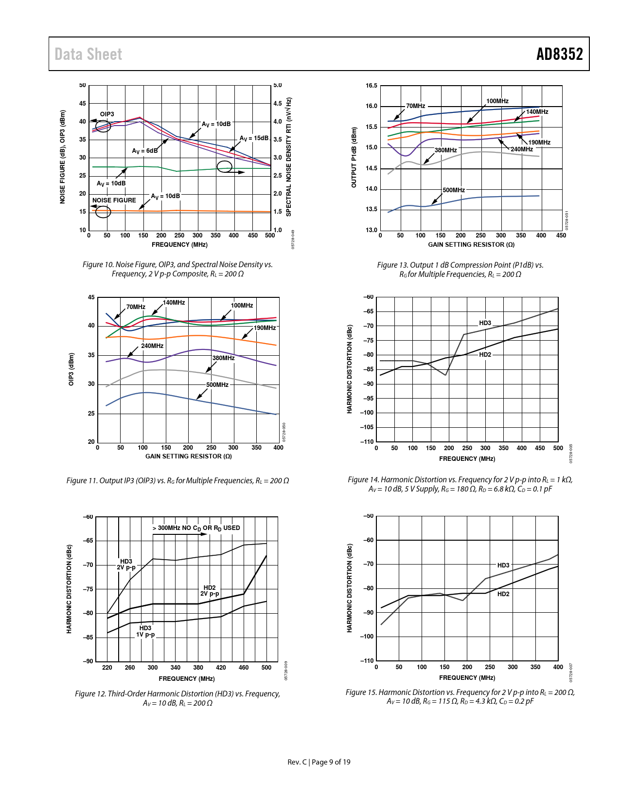

Data Sheet. AD8352. 5.0. 16.5. 4.5. 100MHz. 16.0. 70MHz. 140MHz. OIP3. 4.0. I (n. V = 10dB. 15.5. Bm). Y R. V = 15dB. 3.5. 190MHz. ), OIP. B (. 15.0. 380MHz. 240MHz
Data Sheet AD8352 5.0 16.5 4.5 100MHz 16.0 70MHz 140MHz OIP3 4.0 I (n V = 10dB 15.5 Bm) Y R V = 15dB 3.5 190MHz ), OIP B ( 15.0 380MHz 240MHz
Data Sheet AD8352 50 5.0 16.5 z) 45 4.5 100MHz 16.0 70MHz ) H 140MHz m OIP3 V/ 40 4.0 dB A I (n ( V = 10dB T 15.5 3 Bm) 35 A Y R V = 15dB 3.5 T d 190MHz ), OIP SI B ( 15.0 A 380MHz 240MHz dB V = 6dB EN 1d ( 30 3.0 E P R UT 14.5 ISE D 25 2.5 O P FIGU A N UT E V = 10dB L O A 14.0 500MHz 20 2.0 R OIS AV = 10dB T N NOISE FIGURE 15 1.5 13.5 SPEC

05728- Figure 10. Noise Figure, OIP3, and Spectral Noise Density vs. Figure 13. Output 1 dB Compression Point (P1dB) vs. Frequency, 2 V p-p Composite, RL = 200 Ω RG for Multiple Frequencies, RL = 200 Ω

05728- Figure 11. Output IP3 (OIP3) vs. RG for Multiple Frequencies, RL = 200 Ω Figure 14. Harmonic Distortion vs. Frequency for 2 V p-p into RL = 1 kΩ, AV = 10 dB, 5 V Supply, RG = 180 Ω, RD = 6.8 kΩ, CD = 0.1 pF
–60 –50 > 300MHz NO CD OR RD USED –65 –60 Bc) Bc) d d N ( HD3 –70 N ( –70 HD3 IO 2V p-p IO RT RT O O T HD2 T S –75 S –80 2V p-p HD2 C DI C DI NI NI O –80 O –90 HD3 HARM HARM 1V p-p –85 –100 –90 –110 220 260 300 340 380 420 460 500

05728- Figure 12. Third-Order Harmonic Distortion (HD3) vs. Frequency, Figure 15. Harmonic Distortion vs. Frequency for 2 V p-p into RL = 200 Ω, A A V = 10 dB, RL = 200 Ω V = 10 dB, RG = 115 Ω, RD = 4.3 kΩ, CD = 0.2 pF Rev. C | Page 9 of 19 Document Outline FEATURES APPLICATIONS FUNCTIONAL BLOCK DIAGRAM GENERAL DESCRIPTION TABLE OF CONTENTS REVISION HISTORY SPECIFICATIONS NOISE DISTORTION SPECIFICATIONS ABSOLUTE MAXIMUM RATINGS ESD CAUTION PIN CONFIGURATION AND FUNCTION DESCRIPTIONS TYPICAL PERFORMANCE CHARACTERISTICS APPLICATIONS INFORMATION GAIN AND DISTORTION ADJUSTMENT (DIFFERENTIAL INPUT) SINGLE-ENDED INPUT OPERATION NARROW-BAND, THIRD-ORDER INTERMODULATION CANCELLATION HIGH PERFORMANCE ADC DRIVING LAYOUT AND TRANSMISSION LINE EFFECTS EVALUATION BOARD EVALUATION BOARD LOADING SCHEMES SOLDERING INFORMATION EVALUATION BOARD SCHEMATICS OUTLINE DIMENSIONS ORDERING GUIDE
