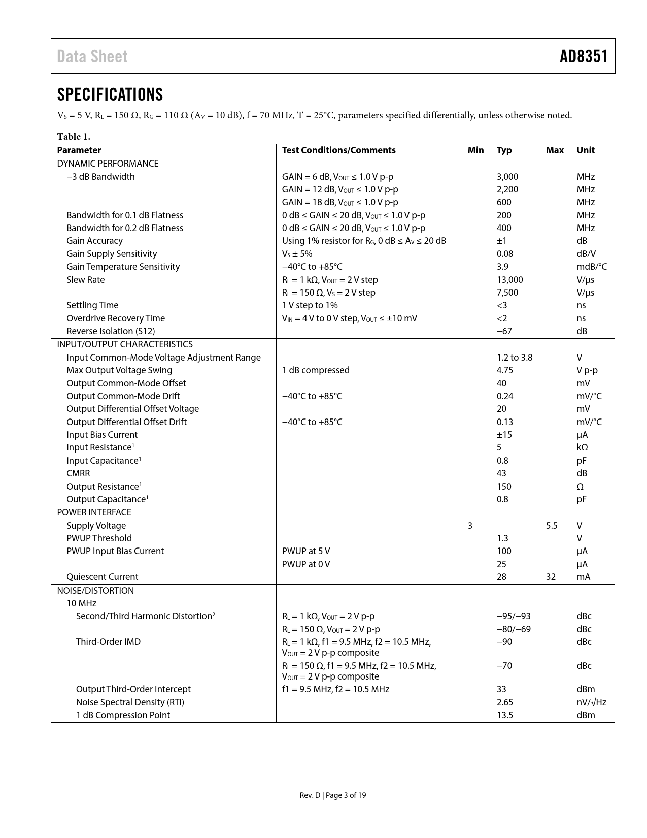

Data Sheet AD8351 SPECIFICATIONS
VS = 5 V, RL = 150 Ω, RG = 110 Ω (AV = 10 dB), f = 70 MHz, T = 25°C, parameters specified differentially, unless otherwise noted.
Table 1. Parameter Test Conditions/Comments Min Typ Max Unit
DYNAMIC PERFORMANCE −3 dB Bandwidth GAIN = 6 dB, VOUT ≤ 1.0 V p-p 3,000 MHz GAIN = 12 dB, VOUT ≤ 1.0 V p-p 2,200 MHz GAIN = 18 dB, VOUT ≤ 1.0 V p-p 600 MHz Bandwidth for 0.1 dB Flatness 0 dB ≤ GAIN ≤ 20 dB, VOUT ≤ 1.0 V p-p 200 MHz Bandwidth for 0.2 dB Flatness 0 dB ≤ GAIN ≤ 20 dB, VOUT ≤ 1.0 V p-p 400 MHz Gain Accuracy Using 1% resistor for RG, 0 dB ≤ AV ≤ 20 dB ±1 dB Gain Supply Sensitivity VS ± 5% 0.08 dB/V Gain Temperature Sensitivity −40°C to +85°C 3.9 mdB/°C Slew Rate RL = 1 kΩ, VOUT = 2 V step 13,000 V/μs RL = 150 Ω, VS = 2 V step 7,500 V/μs Settling Time 1 V step to 1% <3 ns Overdrive Recovery Time VIN = 4 V to 0 V step, VOUT ≤ ±10 mV <2 ns Reverse Isolation (S12) −67 dB INPUT/OUTPUT CHARACTERISTICS Input Common-Mode Voltage Adjustment Range 1.2 to 3.8 V Max Output Voltage Swing 1 dB compressed 4.75 V p-p Output Common-Mode Offset 40 mV Output Common-Mode Drift −40°C to +85°C 0.24 mV/°C Output Differential Offset Voltage 20 mV Output Differential Offset Drift −40°C to +85°C 0.13 mV/°C Input Bias Current ±15 μA Input Resistance1 5 kΩ Input Capacitance1 0.8 pF CMRR 43 dB Output Resistance1 150 Ω Output Capacitance1 0.8 pF POWER INTERFACE Supply Voltage 3 5.5 V PWUP Threshold 1.3 V PWUP Input Bias Current PWUP at 5 V 100 μA PWUP at 0 V 25 μA Quiescent Current 28 32 mA NOISE/DISTORTION 10 MHz Second/Third Harmonic Distortion2 RL = 1 kΩ, VOUT = 2 V p-p −95/−93 dBc RL = 150 Ω, VOUT = 2 V p-p −80/−69 dBc Third-Order IMD RL = 1 kΩ, f1 = 9.5 MHz, f2 = 10.5 MHz, −90 dBc VOUT = 2 V p-p composite RL = 150 Ω, f1 = 9.5 MHz, f2 = 10.5 MHz, −70 dBc VOUT = 2 V p-p composite Output Third-Order Intercept f1 = 9.5 MHz, f2 = 10.5 MHz 33 dBm Noise Spectral Density (RTI) 2.65 nV/√Hz 1 dB Compression Point 13.5 dBm Rev. D | Page 3 of 19 Document Outline FEATURES APPLICATIONS FUNCTIONAL BLOCK DIAGRAM GENERAL DESCRIPTION TABLE OF CONTENTS REVISION HISTORY SPECIFICATIONS ABSOLUTE MAXIMUM RATINGS ESD CAUTION PIN CONFIGURATIONS AND FUNCTION DESCRIPTIONS TYPICAL PERFORMANCE CHARACTERISTICS THEORY OF OPERATION BASIC CONCEPTS GAIN ADJUSTMENT COMMON-MODE ADJUSTMENT INPUT AND OUTPUT MATCHING SINGLE-ENDED-TO-DIFFERENTIAL OPERATION ADC DRIVING ANALOG MULTIPLEXING I/O CAPACITIVE LOADING TRANSMISSION LINE EFFECTS CHARACTERIZATION SETUP EVALUATION BOARD OUTLINE DIMENSIONS ORDERING GUIDE
