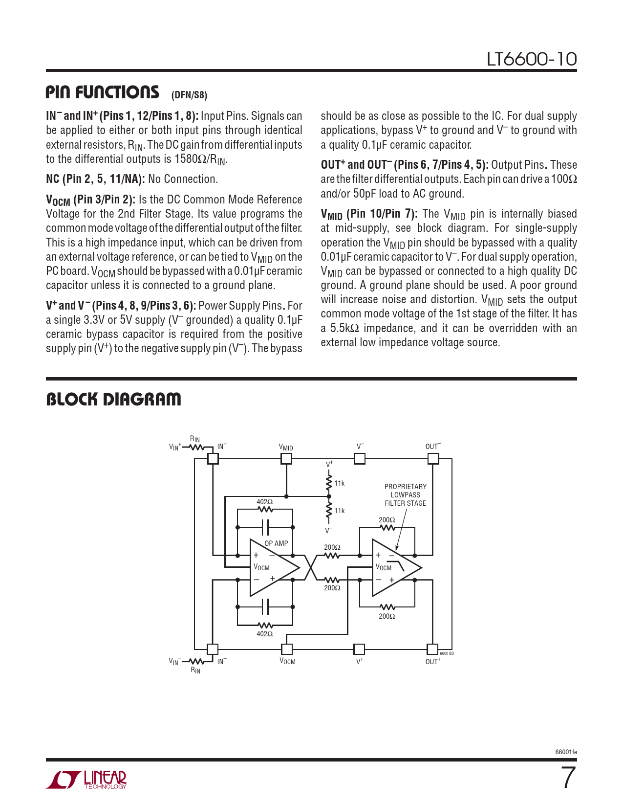

PIN FUNCTIONS (DFN/S8). IN– and IN+ (Pins 1, 12/Pins 1, 8):. OUT+ and OUT– (Pins 6, 7/Pins 4, 5):. NC (Pin 2, 5, 11/NA):
PIN FUNCTIONS (DFN/S8) IN– and IN+ (Pins 1, 12/Pins 1, 8): OUT+ and OUT– (Pins 6, 7/Pins 4, 5): NC (Pin 2, 5, 11/NA):
LT6600-10
Input Pins. Signals can should be as close as possible to the IC. For dual supply be applied to either or both input pins through identical applications, bypass V+ to ground and V– to ground with external resistors, RIN. The DC gain from differential inputs a quality 0.1μF ceramic capacitor. to the differential outputs is 1580Ω/RIN.
Output Pins
These
No Connection. are the fi lter differential outputs. Each pin can drive a 100Ω and/or 50pF load to AC ground.
VOCM (Pin 3/Pin 2):
Is the DC Common Mode Reference Voltage for the 2nd Filter Stage. Its value programs the
VMID (Pin 10/Pin 7):
The VMID pin is internally biased common mode voltage of the differential output of the fi lter. at mid-supply, see block diagram. For single-supply This is a high impedance input, which can be driven from operation the VMID pin should be bypassed with a quality an external voltage reference, or can be tied to VMID on the 0.01μF ceramic capacitor to V–. For dual supply operation, PC board. VOCM should be bypassed with a 0.01μF ceramic VMID can be bypassed or connected to a high quality DC capacitor unless it is connected to a ground plane. ground. A ground plane should be used. A poor ground will increase noise and distortion. V
V+ and V – (Pins 4, 8, 9/Pins 3, 6):
Power Supply Pins
For MID sets the output common mode voltage of the 1st stage of the fi lter. It has a single 3.3V or 5V supply (V– grounded) a quality 0.1μF a 5.5kΩ impedance, and it can be overridden with an ceramic bypass capacitor is required from the positive external low impedance voltage source. supply pin (V+) to the negative supply pin (V–). The bypass
BLOCK DIAGRAM
RIN V + IN IN+ OUT– V– VMID V+ 11k PROPRIETARY LOWPASS 402Ω FILTER STAGE 11k 200Ω V– OP AMP 200Ω + – + – V V OCM OCM – + – + 200Ω 200Ω 402Ω 6600 BD V – IN V IN– OCM V+ OUT+ RIN 66001fe 7
