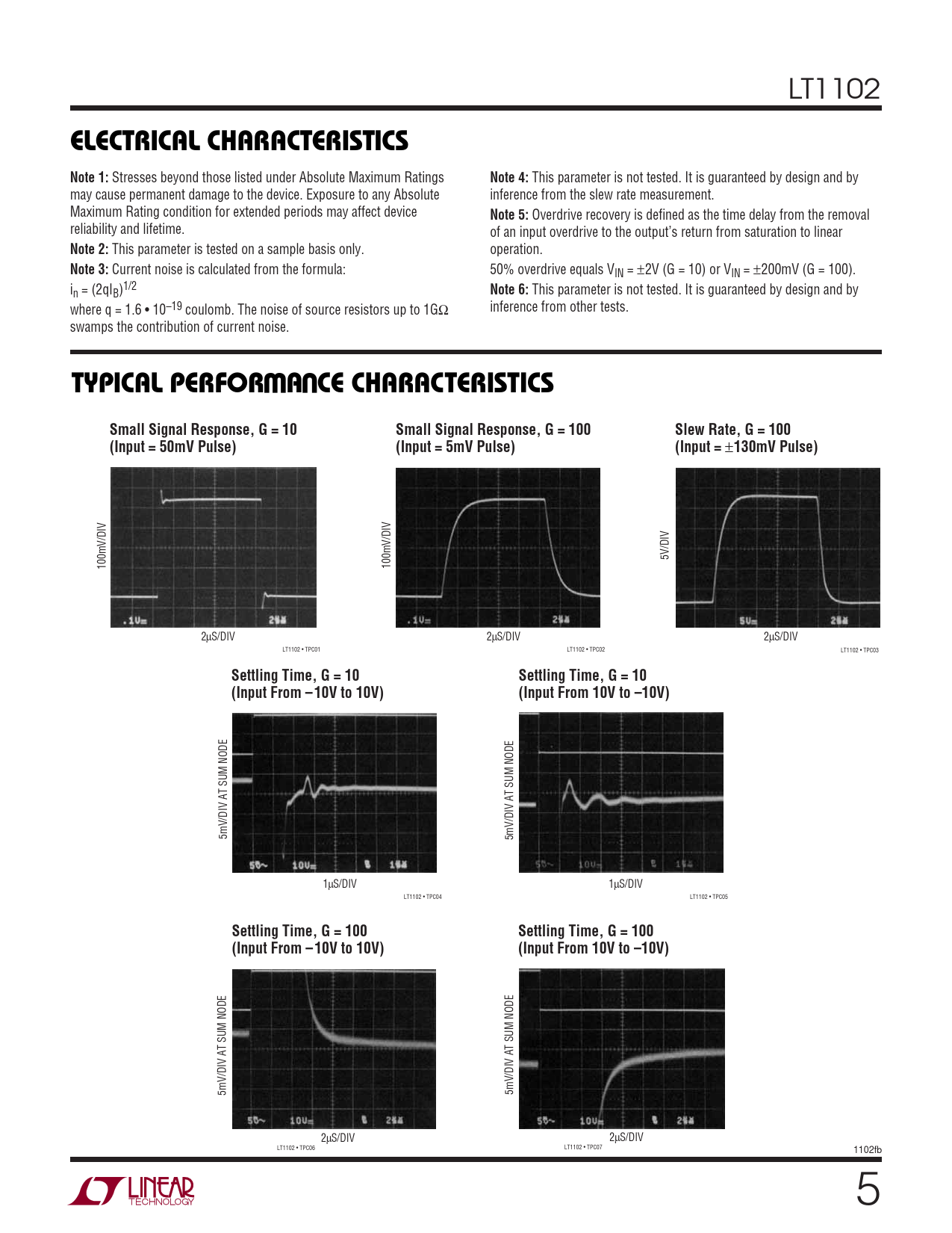

ELECTRICAL CHARACTERISTICS. Note 1:. Note 4:. Note 5:. Note 2:. Note 3:. Note 6:. TYPICAL PERFOR A CE CHARACTERISTICS
ELECTRICAL CHARACTERISTICS Note 1: Note 4: Note 5: Note 2: Note 3: Note 6: TYPICAL PERFOR A CE CHARACTERISTICS
LT1102
Note 4:
This parameter is not tested. It is guaranteed by design and by may cause permanent damage to the device. Exposure to any Absolute inference from the slew rate measurement. Maximum Rating condition for extended periods may affect device
Note 5:
Overdrive recovery is defined as the time delay from the removal reliability and lifetime. of an input overdrive to the output’s return from saturation to linear
Note 2:
This parameter is tested on a sample basis only. operation.
Note 3:
Current noise is calculated from the formula: 50% overdrive equals VIN = ±2V (G = 10) or VIN = ±200mV (G = 100). in = (2qIB)1/2
Note 6:
This parameter is not tested. It is guaranteed by design and by where q = 1.6 • 10–19 coulomb. The noise of source resistors up to 1GΩ inference from other tests. swamps the contribution of current noise.
W U TYPICAL PERFOR A CE CHARACTERISTICS Small Signal Response, G = 10 Small Signal Response, G = 100 Slew Rate, G = 100 (Input = 50mV Pulse) (Input = 5mV Pulse) (Input =
130mV Pulse)
5V/DIV 100mV/DIV 100mV/DIV 2μS/DIV 2μS/DIV 2μS/DIV
FPO
LT1102 • TPC01
FPO
LT1102 • TPC02
FPO
LT1102 • TPC03
Settling Time, G = 10 Settling Time, G = 10 (Input From – 10V to 10V) (Input From 10V to –10V)
5mV/DIV AT SUM NODE 5mV/DIV AT SUM NODE 1μS/DIV 1μS/DIV
FPO
LT1102 • TPC04
FPO
LT1102 • TPC05
Settling Time, G = 100 Settling Time, G = 100 (Input From – 10V to 10V) (Input From 10V to –10V)
5mV/DIV AT SUM NODE 5mV/DIV AT SUM NODE 2μS/DIV 2μS/DIV
FPO
LT1102 • TPC06
FPO
LT1102 • TPC07 1102fb 5
