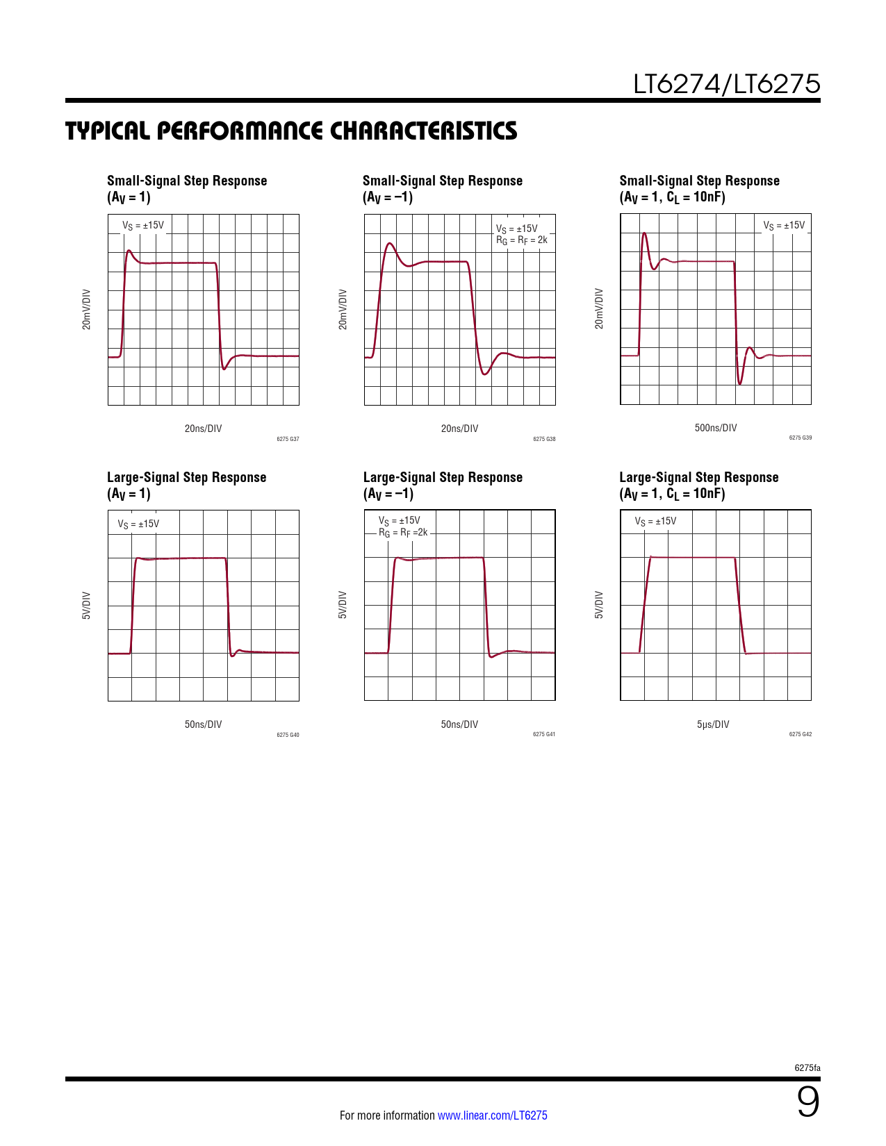

Pages / Page20 / 9 — TYPICAL PERFORMANCE CHARACTERISTICS. Small-Signal Step Response. (AV = …
TYPICAL PERFORMANCE CHARACTERISTICS. Small-Signal Step Response. (AV = 1). (AV = –1). (AV = 1, CL = 10nF)
TYPICAL PERFORMANCE CHARACTERISTICS Small-Signal Step Response (AV = 1) (AV = –1) (AV = 1, CL = 10nF)
LT6274/LT6275
TYPICAL PERFORMANCE CHARACTERISTICS Small-Signal Step Response Small-Signal Step Response Small-Signal Step Response (AV = 1) (AV = –1) (AV = 1, CL = 10nF)
VS = ±15V V V S = ±15V S = ±15V RG = RF = 2k /DIV /DIV /DIV 20mV 20mV 20mV 20ns/DIV 20ns/DIV 500ns/DIV 6275 G37 6275 G38 6275 G39
Large-Signal Step Response Large-Signal Step Response Large-Signal Step Response (AV = 1) (AV = –1) (AV = 1, CL = 10nF)
V V V S = ±15V S = ±15V S = ±15V RG = RF =2k /DIV /DIV /DIV 5V 5V 5V 50ns/DIV 50ns/DIV 5µs/DIV 6275 G40 6275 G41 6275 G42 6275fa For more information www.linear.com/LT6275 9
