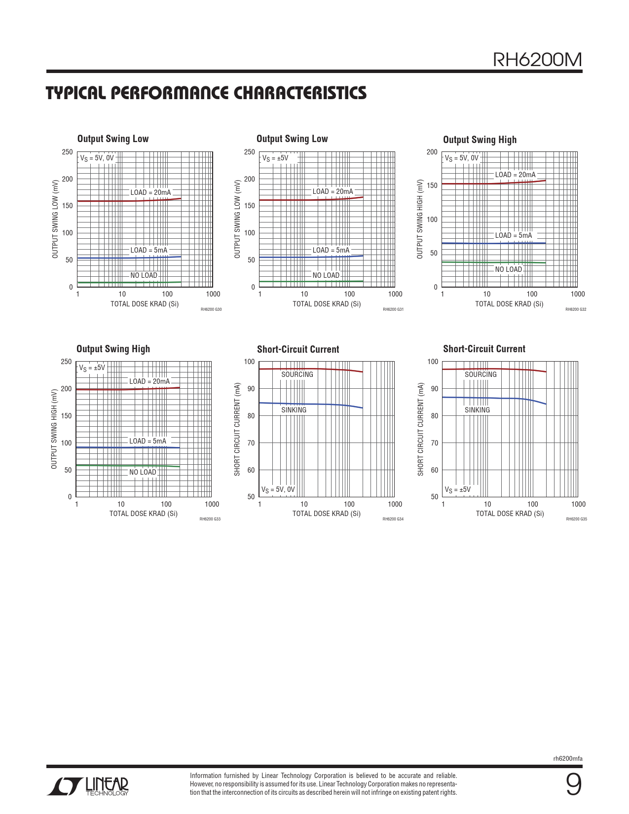

TYPICAL PERFORMANCE CHARACTERISTICS. Output Swing Low. Output Swing High. Short-Circuit Current
TYPICAL PERFORMANCE CHARACTERISTICS Output Swing Low Output Swing High Short-Circuit Current
RH6200M
TYPICAL PERFORMANCE CHARACTERISTICS Output Swing Low Output Swing Low Output Swing High
250 250 200 V V V S = 5V, 0V S = ±5V S = 5V, 0V LOAD = 20mA 200 200 150 LOAD = 20mA LOAD = 20mA 150 150 100 100 100 LOAD = 5mA LOAD = 5mA LOAD = 5mA 50 OUTPUT SWING LOW (mV) OUTPUT SWING LOW (mV) OUTPUT SWING HIGH (mV) 50 50 NO LOAD NO LOAD NO LOAD 0 0 0 1 10 100 1000 1 10 100 1000 1 10 100 1000 TOTAL DOSE KRAD (Si) TOTAL DOSE KRAD (Si) TOTAL DOSE KRAD (Si) RH6200 G30 RH6200 G31 RH6200 G32
Output Swing High Short-Circuit Current Short-Circuit Current
250 100 100 VS = ±5V SOURCING SOURCING LOAD = 20mA 200 90 90 SINKING SINKING 150 80 80 100 LOAD = 5mA 70 70 OUTPUT SWING HIGH (mV) 50 NO LOAD 60 60 SHORT CIRCUIT CURRENT (mA) SHORT CIRCUIT CURRENT (mA) VS = 5V, 0V VS = ±5V 0 50 50 1 10 100 1000 1 10 100 1000 1 10 100 1000 TOTAL DOSE KRAD (Si) TOTAL DOSE KRAD (Si) TOTAL DOSE KRAD (Si) RH6200 G33 RH6200 G34 RH6200 G35 rh6200mfa Information furnished by Linear Technology Corporation is believed to be accurate and reliable. However, no responsibility is assumed for its use. Linear Technology Corporation makes no representa- tion that the interconnection of its circuits as described herein will not infringe on existing patent rights. 9
