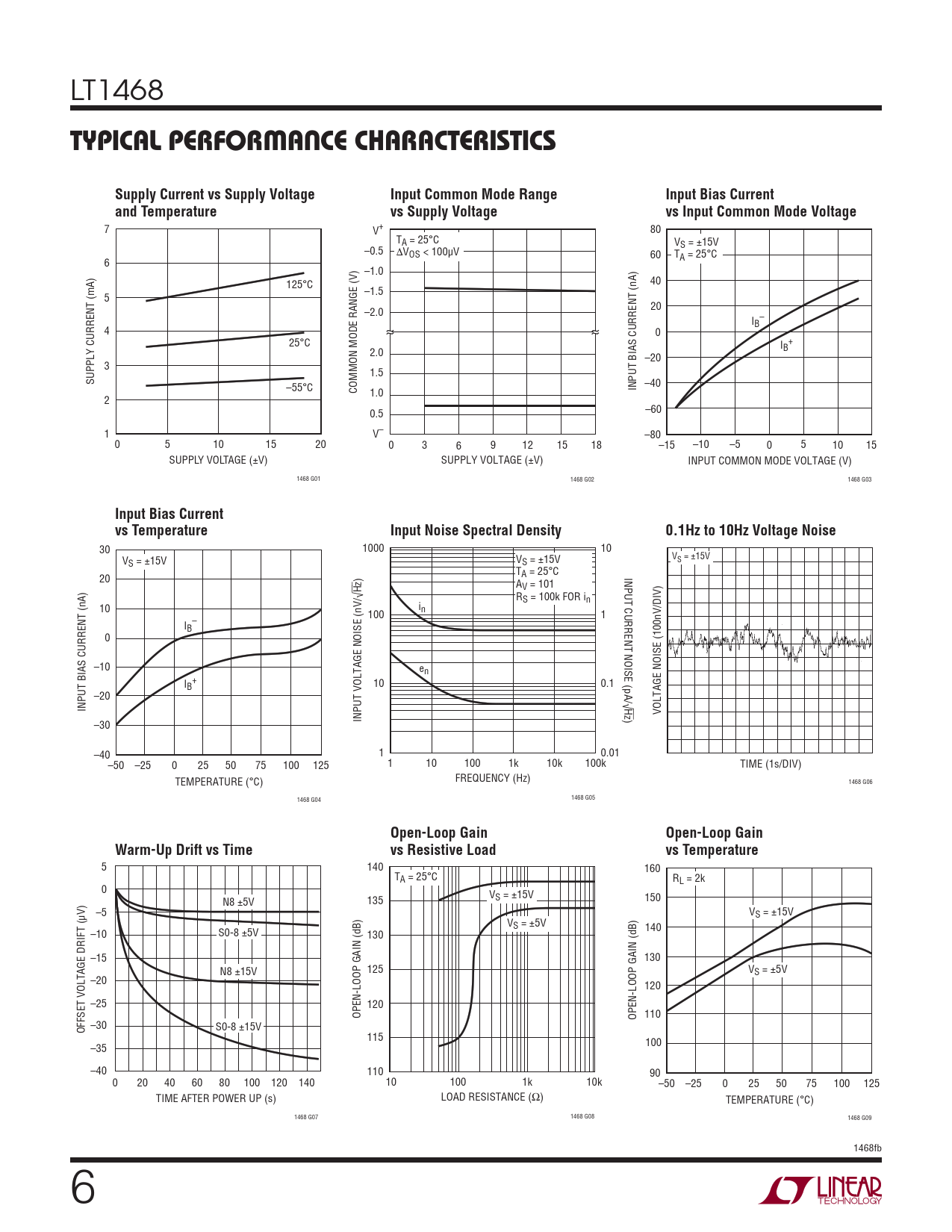

TYPICAL PERFORMANCE CHARACTERISTICS. Supply Current vs Supply Voltage. Input Common Mode Range. Input Bias Current
TYPICAL PERFORMANCE CHARACTERISTICS Supply Current vs Supply Voltage Input Common Mode Range Input Bias Current
LT1468
TYPICAL PERFORMANCE CHARACTERISTICS Supply Current vs Supply Voltage Input Common Mode Range Input Bias Current and Temperature vs Supply Voltage vs Input Common Mode Voltage
7 V+ 80 TA = 25°C VS = ±15V –0.5 ΔVOS < 100μV 60 TA = 25°C 6 –1.0 125°C 40 –1.5 5 20 –2.0 I – B 4 0 25°C I + 2.0 B –20 3 1.5 SUPPLY CURRENT (mA) –55°C –40 COMMON MODE RANGE (V) INPUT BIAS CURRENT (nA) 1.0 2 0.5 –60 1 V– –80 0 5 10 15 20 0 3 6 9 12 15 18 –15 –10 –5 0 5 10 15 SUPPLY VOLTAGE (±V) SUPPLY VOLTAGE (±V) INPUT COMMON MODE VOLTAGE (V) 1468 G01 1468 G02 1468 G03
Input Bias Current vs Temperature Input Noise Spectral Density 0.1Hz to 10Hz Voltage Noise
30 1000 10 V V S = ±15V VS = ±15V S = ±15V T 20 ) A = 25°C INPUT CURRENT NOISE (pA/√ Hz AV = 101 RS = 100k FOR in 10 in 100 1 I – B 0 –10 en I + B 10 0.1 –20 INPUT BIAS CURRENT (nA) Hz VOLTAGE NOISE (100nV/DIV) INPUT VOLTAGE NOISE (nV/√ ) –30 –40 1 0.01 –50 –25 0 25 50 75 100 125 1 10 100 1k 10k 100k TIME (1s/DIV) TEMPERATURE (°C) FREQUENCY (Hz) 1468 G06 1468 G04 1468 G05
Open-Loop Gain Open-Loop Gain Warm-Up Drift vs Time vs Resistive Load vs Temperature
5 140 160 TA = 25°C RL = 2k 0 VS = ±15V N8 ±5V 135 150 –5 VS = ±15V VS = ±5V 140 –10 S0-8 ±5V 130 –15 130 N8 ±15V 125 VS = ±5V –20 120 –25 120 OPEN-LOOP GAIN (dB) 110 OPEN-LOOP GAIN (dB) OFFSET VOLTAGE DRIFT (μV) –30 S0-8 ±15V 115 100 –35 –40 110 90 0 20 40 60 80 100 120 140 10 100 1k 10k –50 –25 0 25 50 75 100 125 TIME AFTER POWER UP (s) LOAD RESISTANCE (Ω) TEMPERATURE (°C) 1468 G07 1468 G08 1468 G09 1468fb 6
