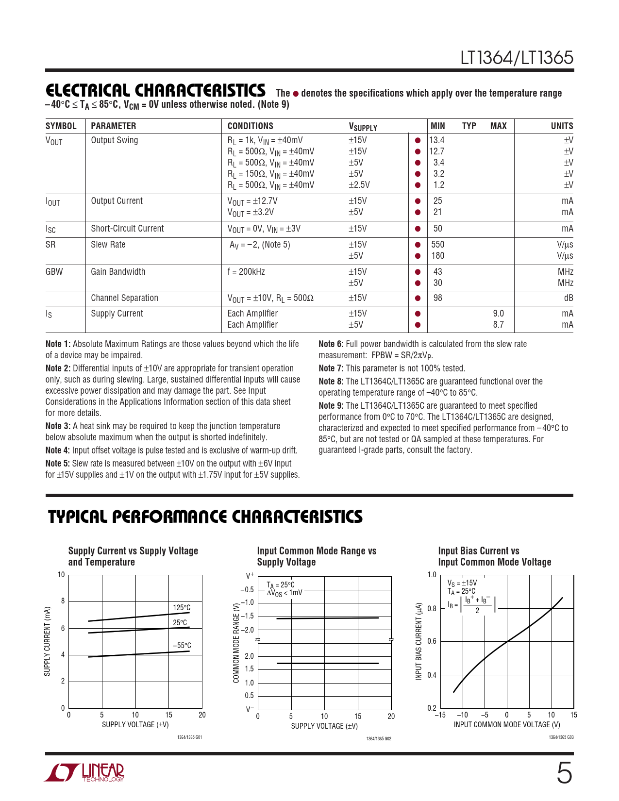

ELECTRICAL CHARACTERISTICS The. denotes the specifications which apply over the temperature range. – 40
ELECTRICAL CHARACTERISTICS The denotes the specifications which apply over the temperature range – 40
LT1364/LT1365
C
TA
85
C, VCM = 0V unless otherwise noted. (Note 9) SYMBOL PARAMETER CONDITIONS VSUPPLY MIN TYP MAX UNITS
VOUT Output Swing RL = 1k, VIN = ±40mV ±15V ● 13.4 ±V RL = 500Ω, VIN = ±40mV ±15V ● 12.7 ±V RL = 500Ω, VIN = ±40mV ±5V ● 3.4 ±V RL = 150Ω, VIN = ±40mV ±5V ● 3.2 ±V RL = 500Ω, VIN = ±40mV ±2.5V ● 1.2 ±V IOUT Output Current VOUT = ±12.7V ±15V ● 25 mA VOUT = ±3.2V ±5V ● 21 mA ISC Short-Circuit Current VOUT = 0V, VIN = ±3V ±15V ● 50 mA SR Slew Rate AV = – 2, (Note 5) ±15V ● 550 V/µs ±5V ● 180 V/µs GBW Gain Bandwidth f = 200kHz ±15V ● 43 MHz ±5V ● 30 MHz Channel Separation VOUT = ±10V, RL = 500Ω ±15V ● 98 dB IS Supply Current Each Amplifier ±15V ● 9.0 mA Each Amplifier ±5V ● 8.7 mA

W U TYPICAL PERFORMANCE CHARACTERISTICS Supply Current vs Supply Voltage Input Common Mode Range vs Input Bias Current vs and Temperature Supply Voltage Input Common Mode Voltage
10 1.0 V + V T S = ±15V – 0.5 A = 25°C T ∆V A = 25°C OS < 1mV + – 8 I + I –1.0 I B B 125°C ———— µA) 0.8 B = 2  –1.5 25°C 6 –2.0 0.6 – 55°C 4 2.0 1.5 SUPPLY CURRENT (mA) 0.4 2 INPUT BIAS CURRENT ( COMMON MODE RANGE (V) 1.0 0.5 0 0.2 V – 0 5 10 15 20 –15 –10 –5 0 5 10 15 0 5 10 15 20 SUPPLY VOLTAGE (±V) INPUT COMMON MODE VOLTAGE (V) SUPPLY VOLTAGE (±V) 1364/1365 G01 1364/1365 G03 1364/1365 G02 5
