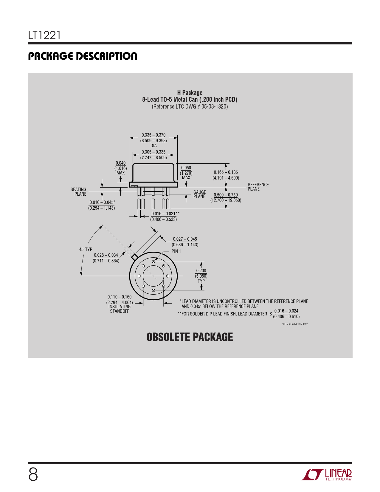

PACKAGE DESCRIPTIO. H Package. 8-Lead TO-5 Metal Can (.200 Inch PCD). OBSOLETE PACKAGE
PACKAGE DESCRIPTIO H Package 8-Lead TO-5 Metal Can (.200 Inch PCD) OBSOLETE PACKAGE
LT1221
U PACKAGE DESCRIPTIO H Package 8-Lead TO-5 Metal Can (.200 Inch PCD)
(Reference LTC DWG # 05-08-1320) 0.335 – 0.370 (8.509 – 9.398) DIA 0.305 – 0.335 (7.747 – 8.509) 0.040 (1.016) 0.050 MAX (1.270) 0.165 – 0.185 MAX (4.191 – 4.699) REFERENCE SEATING PLANE PLANE GAUGE PLANE 0.500 – 0.750 (12.700 – 19.050) 0.010 – 0.045* (0.254 – 1.143) 0.016 – 0.021** (0.406 – 0.533) 0.027 – 0.045 (0.686 – 1.143) 45°TYP PIN 1 0.028 – 0.034 (0.711 – 0.864) 0.200 (5.080) TYP 0.110 – 0.160 (2.794 – 4.064) *LEAD DIAMETER IS UNCONTROLLED BETWEEN THE REFERENCE PLANE INSULATING AND 0.045" BELOW THE REFERENCE PLANE STANDOFF 0.016 – 0.024 **FOR SOLDER DIP LEAD FINISH, LEAD DIAMETER IS (0.406 – 0.610) H8(TO-5) 0.200 PCD 1197
