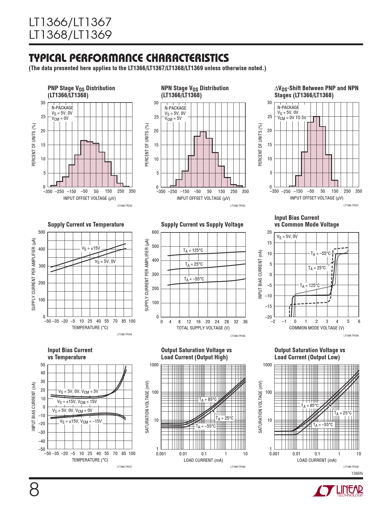

(The data presented here applies to the LT1366/LT1367/LT1368/LT1369 unless otherwise noted.). PNP Stage VOS Distribution
(The data presented here applies to the LT1366/LT1367/LT1368/LT1369 unless otherwise noted.) PNP Stage VOS Distribution
LT1366/LT1367 LT1368/LT1369 Typical perForMance characTerisTics
(The data presented here applies to the LT1366/LT1367/LT1368/LT1369 unless otherwise noted.) PNP Stage VOS Distribution NPN Stage VOS Distribution
VOS-Shift Between PNP and NPN (LT1366/LT1368) (LT1366/LT1368) Stages (LT1366/LT1368)
30 30 30 N-PACKAGE N-PACKAGE N-PACKAGE V V VS = 5V, 0V 25 S = 5V, 0V S = 5V, 0V V 25 CM = 0V 25 VCM = 5V VCM = 0V TO 5V 20 20 20 15 15 15 10 10 10 PERCENT OF UNITS (%) PERCENT OF UNITS (%) PERCENT OF UNITS (%) 5 5 5 0 0 0 –350 –250 –150 –50 50 150 250 350 –350 –250 –150 –50 50 150 250 350 –350 –250 –150 –50 50 150 250 350 INPUT OFFSET VOLTAGE (µV) INPUT OFFSET VOLTAGE (µV) INPUT OFFSET VOLTAGE (µV) LT1366 TPC03 LT1366 TPC02 LT1366 TPC01
Input Bias Current Supply Current vs Temperature Supply Current vs Supply Voltage vs Common Mode Voltage
500 600 20 VS = 5V, 0V 15 500 400 VS = ±15V TA = 125°C 10 TA = –55°C VS = 5V, 0V 400 300 TA = 25°C 5 TA = 25°C 300 0 TA = –55°C 200 –5 T 200 A = 125°C –10 100 INPUT BIAS CURRENT (nA) 100 SUPPLY CURRENT PER AMPLIFIER (µA) –15 SUPPLY CURRENT PER AMPLIFIER (µA) 0 0 –20 –50 –35 –20 –5 10 25 40 55 70 85 100 0 4 8 12 16 20 24 28 32 36 –2 –1 0 1 2 3 4 5 6 TEMPERATURE (°C) TOTAL SUPPLY VOLTAGE (V) COMMON MODE VOLTAGE (V) LT1366 TPC04 LT1366 TPC05 LT1366 TPC06
Input Bias Current Output Saturation Voltage vs Output Saturation Voltage vs vs Temperature Load Current (Output High) Load Current (Output Low)
50 1000 1000 40 30 20 VS = 5V, 0V, VCM = 5V 100 100 10 V T S = ±15V, VCM = 15V A = 85°C 0 TA = 85°C VS = 5V, 0V, VCM = 0V T –10 A = 25°C 10 TA = 25°C 10 –20 VS = ±15V, VCM = –15V T TA = –55°C INPUT BIAS CURRENT (nA) A = –55°C –30 SATURATION VOLTAGE (mV) SATURATION VOLTAGE (mV) –40 –50 1 1 –50 –35 –20 –5 10 25 40 55 70 85 100 0.001 0.01 0.1 1 10 0.001 0.01 0.1 1 10 TEMPERATURE (°C) LOAD CURRENT (mA) LOAD CURRENT (mA) LT1366 TPC07 LT1366 TPC08 LT1366 TPC09 1366fb Document Outline Features Description Applications Typical Application Absolute Maximum Ratings Available Options Order Information Electrical Characteristics Typical Performance Characteristics Applications information Typical Applications Package Description Revision History Typical Application Related Parts
