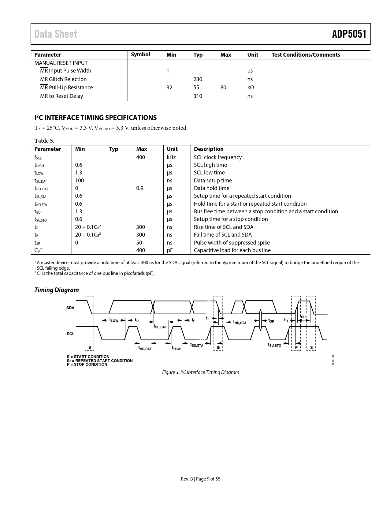

Data Sheet. ADP5051. Parameter. Symbol. Min. Typ. Max. Unit. Test Conditions/Comments. I2C INTERFACE TIMING SPECIFICATIONS
Data Sheet ADP5051 Parameter Symbol Min Typ Max Unit Test Conditions/Comments I2C INTERFACE TIMING SPECIFICATIONS
MANUAL RESET INPUT MR Input Pulse Width 1 µs MR Glitch Rejection 280 ns MR Pull-Up Resistance 32 55 80 kΩ MR to Reset Delay 310 ns
TA = 25°C, VVDD = 3.3 V, VVDDIO = 3.3 V, unless otherwise noted.
Table 5. Parameter Min Typ Max Unit Description
fSCL 400 kHz SCL clock frequency tHIGH 0.6 µs SCL high time tLOW 1.3 µs SCL low time tSU,DAT 100 ns Data setup time tHD, DAT 0 0.9 µs Data hold time1 tSU,STA 0.6 µs Setup time for a repeated start condition tHD,STA 0.6 µs Hold time for a start or repeated start condition tBUF 1.3 µs Bus free time between a stop condition and a start condition tSU,STO 0.6 µs Setup time for a stop condition t 2 R 20 + 0.1CB 300 ns Rise time of SCL and SDA t 2 F 20 + 0.1CB 300 ns Fall time of SCL and SDA tSP 0 50 ns Pulse width of suppressed spike C 2 B 400 pF Capacitive load for each bus line 1 A master device must provide a hold time of at least 300 ns for the SDA signal (referred to the VIH minimum of the SCL signal) to bridge the undefined region of the SCL falling edge. 2 CB is the total capacitance of one bus line in picofarads (pF).
Timing Diagram SDA tBUF tLOW t tF R tF t t tR HD,STA SP tSU,DAT SCL tSU,STA tSU,STO S t t Sr P S HD,DAT HIGH S = START CONDITION
102
Sr = REPEATED START CONDITION P = STOP CONDITION
1635- 1 Figure 3. I2C Interface Timing Diagram Rev. B | Page 9 of 55 Document Outline FEATURES APPLICATIONS GENERAL DESCRIPTION TYPICAL APPLICATION CIRCUIT REVISION HISTORY FUNCTIONAL BLOCK DIAGRAM SPECIFICATIONS BUCK REGULATOR SPECIFICATIONS SUPERVISORY SPECIFICATIONS I2C INTERFACE TIMING SPECIFICATIONS Timing Diagram ABSOLUTE MAXIMUM RATINGS THERMAL RESISTANCE ESD CAUTION PIN CONFIGURATION AND FUNCTION DESCRIPTIONS TYPICAL PERFORMANCE CHARACTERISTICS THEORY OF OPERATION BUCK REGULATOR OPERATIONAL MODES Pulse-Width Modulation (PWM) Mode Power Save Mode (PSM) Forced PWM and Automatic PWM/PSM Modes ADJUSTABLE AND FIXED OUTPUT VOLTAGES DYNAMIC VOLTAGE SCALING (DVS) INTERNAL REGULATORS (VREG AND VDD) SEPARATE SUPPLY APPLICATIONS LOW-SIDE DEVICE SELECTION BOOTSTRAP CIRCUITRY ACTIVE OUTPUT DISCHARGE SWITCH PRECISION ENABLING OSCILLATOR Phase Shift SYNCHRONIZATION INPUT/OUTPUT SOFT START PARALLEL OPERATION STARTUP WITH PRECHARGED OUTPUT CURRENT-LIMIT PROTECTION FREQUENCY FOLDBACK Pulse Skip Mode Under Maximum Duty Cycle HICCUP PROTECTION LATCH-OFF PROTECTION Short-Circuit Latch-Off Mode Overvoltage Latch-Off Mode UNDERVOLTAGE LOCKOUT (UVLO) POWER-GOOD FUNCTION INTERRUPT FUNCTION THERMAL SHUTDOWN OVERHEAT DETECTION LOW INPUT VOLTAGE DETECTION SUPERVISORY CIRCUIT Reset Output Watchdog Input Manual Reset Input Processor Manual Reset Mode Power On/Off Switch Mode I2C INTERFACE SDA AND SCL PINS I2C ADDRESSES SELF-CLEAR REGISTER BITS I2C INTERFACE TIMING DIAGRAMS APPLICATIONS INFORMATION ADIsimPower DESIGN TOOL PROGRAMMING THE ADJUSTABLE OUTPUT VOLTAGE VOLTAGE CONVERSION LIMITATIONS CURRENT-LIMIT SETTING SOFT START SETTING INDUCTOR SELECTION OUTPUT CAPACITOR SELECTION INPUT CAPACITOR SELECTION LOW-SIDE POWER DEVICE SELECTION PROGRAMMING THE UVLO INPUT COMPENSATION COMPONENTS DESIGN POWER DISSIPATION Buck Regulator Power Dissipation Power Switch Conduction Loss (PCOND) Switching Loss (PSW) Transition Loss (PTRAN) Thermal Shutdown JUNCTION TEMPERATURE DESIGN EXAMPLE SETTING THE SWITCHING FREQUENCY SETTING THE OUTPUT VOLTAGE SETTING THE CURRENT LIMIT SELECTING THE INDUCTOR SELECTING THE OUTPUT CAPACITOR SELECTING THE LOW-SIDE MOSFET DESIGNING THE COMPENSATION NETWORK SELECTING THE SOFT START TIME SELECTING THE INPUT CAPACITOR RECOMMENDED EXTERNAL COMPONENTS CIRCUIT BOARD LAYOUT RECOMMENDATIONS TYPICAL APPLICATION CIRCUITS REGISTER MAP DETAILED REGISTER DESCRIPTIONS REGISTER 1: PCTRL (CHANNEL ENABLE CONTROL), ADDRESS 0x01 REGISTER 2: VID1 (VID SETTING FOR CHANNEL 1), ADDRESS 0x02 REGISTER 3: VID23 (VID SETTING FOR CHANNEL 2 AND CHANNEL 3), ADDRESS 0x03 REGISTER 4: VID4 (VID SETTING FOR CHANNEL 4), ADDRESS 0x04 REGISTER 5: DVS_CFG (DVS CONFIGURATION FOR CHANNEL 1 AND CHANNEL 4), ADDRESS 0x05 REGISTER 6: OPT_CFG (FPWM/PSM MODE AND OUTPUT DISCHARGE FUNCTION CONFIGURATION), ADDRESS 0x06 REGISTER 7: LCH_CFG (SHORT-CIRCUIT LATCH-OFF AND OVERVOLTAGE LATCH-OFF CONFIGURATION), ADDRESS 0x07 REGISTER 8: SW_CFG (SWITCHING FREQUENCY AND PHASE SHIFT CONFIGURATION), ADDRESS 0x08 REGISTER 9: TH_CFG (TEMPERATURE WARNING AND LOW VIN WARNING THRESHOLD CONFIGURATION), ADDRESS 0x09 REGISTER 10: HICCUP_CFG (HICCUP CONFIGURATION), ADDRESS 0x0A REGISTER 11: PWRGD_MASK (CHANNEL MASK CONFIGURATION FOR PWRGD PIN), ADDRESS 0x0B REGISTER 12: LCH_STATUS (LATCH-OFF STATUS READBACK), ADDRESS 0x0C REGISTER 13: STATUS_RD (STATUS READBACK), ADDRESS 0x0D REGISTER 14: INT_STATUS (INTERRUPT STATUS READBACK), ADDRESS 0x0E REGISTER 15: INT_MASK (INTERRUPT MASK CONFIGURATION), ADDRESS 0x0F REGISTER 16: FORCE_SHUT (FORCED SHUT DOWN), ADDRESS 0x10 REGISTER 17: DEFAULT_SET (DEFAULT RESET), ADDRESS 0x11 FACTORY DEFAULT OPTIONS OUTLINE DIMENSIONS ORDERING GUIDE
