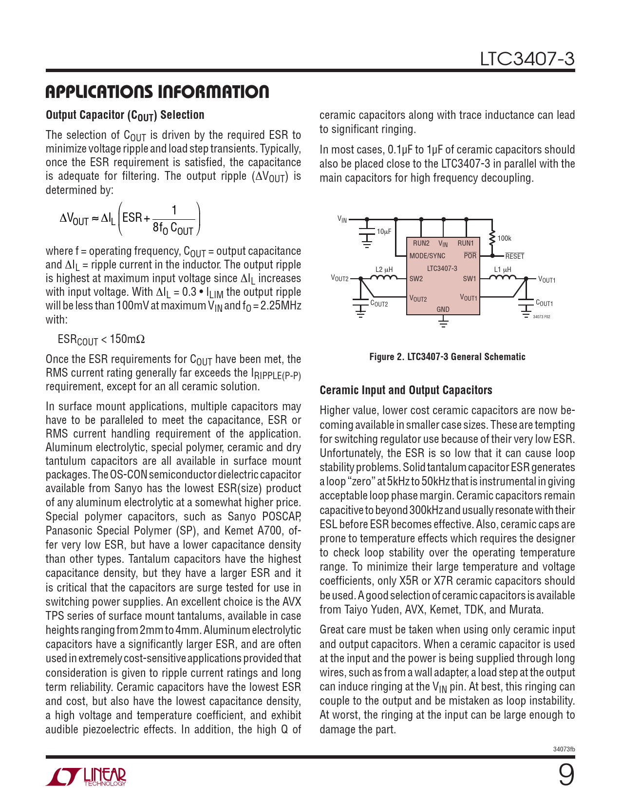

APPLICATIONS INFORMATION Output Capacitor (COUT) Selection
ceramic capacitors along with trace inductance can lead The selection of C to signifi cant ringing. OUT is driven by the required ESR to minimize voltage ripple and load step transients. Typically, In most cases, 0.1μF to 1μF of ceramic capacitors should once the ESR requirement is satisfi ed, the capacitance also be placed close to the LTC3407-3 in parallel with the is adequate for fi ltering. The output ripple (ΔVOUT) is main capacitors for high frequency decoupling. determined by: 1 VOUT IL ES R + VIN 8f O COUT 10μF 100k RUN2 VIN RUN1 where f = operating frequency, COUT = output capacitance MODE/SYNC POR RESET and ΔIL = ripple current in the inductor. The output ripple L2 LTC3407-3 μH L1 μH is highest at maximum input voltage since ΔIL increases VOUT2 SW2 SW1 VOUT1 with input voltage. With ΔIL = 0.3 • ILIM the output ripple V V OUT2 OUT1 will be less than 100mV at maximum V COUT2 COUT1 IN and fO = 2.25MHz GND with: 34073 F02 ESRCOUT < 150mΩ Once the ESR requirements for C
Figure 2. LTC3407-3 General Schematic
OUT have been met, the RMS current rating generally far exceeds the IRIPPLE(P-P) requirement, except for an all ceramic solution.
