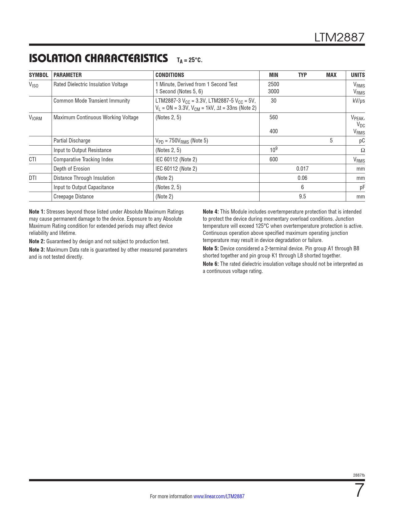

ISOLATION CHARACTERISTICS. TA = 25°C. SYMBOL PARAMETER. CONDITIONS. MIN. TYP. MAX. UNITS. Note 1:. Note 4:. Note 2:. Note 3:. Note 5:. Note 6:
ISOLATION CHARACTERISTICS TA = 25°C SYMBOL PARAMETER CONDITIONS MIN TYP MAX UNITS Note 1: Note 4: Note 2: Note 3: Note 5: Note 6:
LTM2887
ISOLATION CHARACTERISTICS TA = 25°C. SYMBOL PARAMETER CONDITIONS MIN TYP MAX UNITS
VISO Rated Dielectric Insulation Voltage 1 Minute, Derived from 1 Second Test 2500 VRMS 1 Second (Notes 5, 6) 3000 VRMS Common Mode Transient Immunity LTM2887-3 VCC = 3.3V, LTM2887-5 VCC = 5V, 30 kV/µs VL = ON = 3.3V, VCM = 1kV, Δt = 33ns (Note 2) VIORM Maximum Continuous Working Voltage (Notes 2, 5) 560 VPEAK, VDC 400 VRMS Partial Discharge VPD = 750VRMS (Note 5) 5 pC Input to Output Resistance (Notes 2, 5) 109 Ω CTI Comparative Tracking Index IEC 60112 (Note 2) 600 VRMS Depth of Erosion IEC 60112 (Note 2) 0.017 mm DTI Distance Through Insulation (Note 2) 0.06 mm Input to Output Capacitance (Notes 2, 5) 6 pF Creepage Distance (Note 2) 9.5 mm
Note 1:
Note 4:
This Module includes overtemperature protection that is intended may cause permanent damage to the device. Exposure to any Absolute to protect the device during momentary overload conditions. Junction Maximum Rating condition for extended periods may affect device temperature will exceed 125°C when overtemperature protection is active. reliability and lifetime. Continuous operation above specified maximum operating junction
Note 2:
Guaranteed by design and not subject to production test. temperature may result in device degradation or failure.
Note 3:
Maximum Data rate is guaranteed by other measured parameters
Note 5:
Device considered a 2-terminal device. Pin group A1 through B8 and is not tested directly. shorted together and pin group K1 through L8 shorted together.
Note 6:
The rated dielectric insulation voltage should not be interpreted as a continuous voltage rating. 2887fb For more information www.linear.com/LTM2887 7 Document Outline Features Applications Description Typical Application Absolute Maximum Ratings Pin Configuration Product Selection Guide Order Information Electrical Characteristics Switching Characteristics Isolation Characteristics Typical Performance Characteristics Pin Functions Block Diagrams Test Circuits Applications Information Typical Applications Package Description Revision History Typical Application Related Parts
