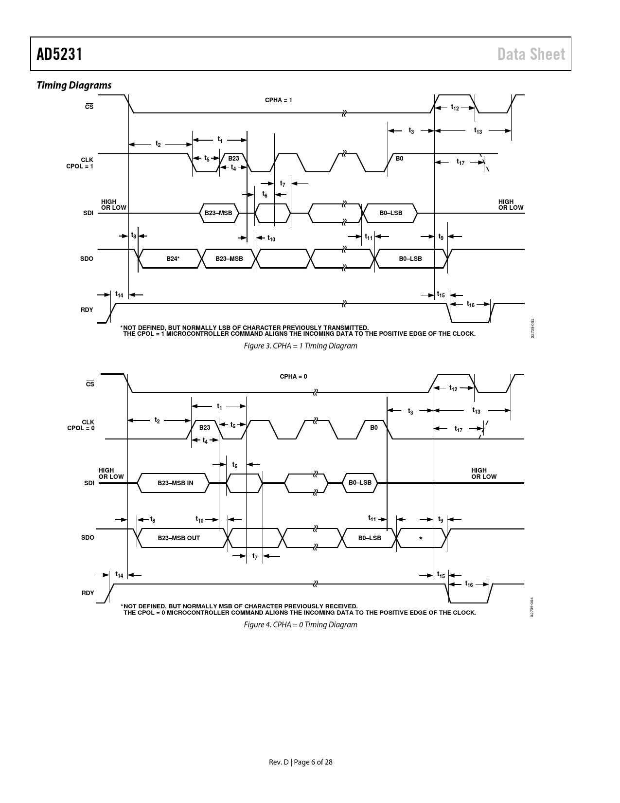

AD5231. Data Sheet. Timing Diagrams. CPHA = 1. t12. t13. CLK. B23. t17. CPOL = 1. HIGH. OR LOW. SDI. B23–MSB. B0–LSB. SDO. B24*. t14. t15. t16. RDY

AD5231 Data Sheet Timing Diagrams CPHA = 1 CS t12 t3 t13 t t 1 2 CLK t5 B23 B0 t17 CPOL = 1 t4 t7 t6 HIGH HIGH OR LOW OR LOW SDI B23–MSB B0–LSB t8 t t 10 11 t9 SDO B24* B23–MSB B0–LSB t14 t15 t16 RDY

* NOT DEFINED, BUT NORMALLY LSB OF CHARACTER PREVIOUSLY TRANSMITTED.

THE CPOL = 1 MICROCONTROLLER COMMAND ALIGNS THE INCOMING DATA TO THE POSITIVE EDGE OF THE CLOCK.
73 02 Figure 3. CPHA = 1 Timing Diagram
CPHA = 0 CS t12 t1 t t 3 13 CLK t2 t CPOL = 0 B23 5 B0 t17 t4 t6 HIGH HIGH OR LOW OR LOW SDI B23–MSB IN B0–LSB t t t 8 10 11 t9 SDO B23–MSB OUT B0–LSB * t7 t14 t15 t16 RDY

* NOT DEFINED, BUT NORMALLY MSB OF CHARACTER PREVIOUSLY RECEIVED.

THE CPOL = 0 MICROCONTROLLER COMMAND ALIGNS THE INCOMING DATA TO THE POSITIVE EDGE OF THE CLOCK.
73 02 Figure 4. CPHA = 0 Timing Diagram Rev. D | Page 6 of 28 Document Outline Features Applications Functional Block Diagram General Description Revision History Specifications Electrical Characteristics—10 kΩ, 50 kΩ, 100 kΩ Versions Timing Characteristics—10 kΩ, 50 kΩ, 100 kΩ Versions Timing Diagrams Absolute Maximum Ratings ESD Caution Pin Configuration and Function Descriptions Typical Performance Characteristics Test Circuits Theory of Operation Scratchpad and EEMEM Programming Basic Operation EEMEM Protection Digital Input/Output Configuration Serial Data Interface Daisy-Chain Operation Terminal Voltage Operation Range Power-Up Sequence Latched Digital Outputs Advanced Control Modes Linear Increment and Decrement Instructions Logarithmic Taper Mode Adjustment Using Additional Internal Nonvolatile EEMEM RDAC Structure Programming the Variable Resistor Rheostat Operation Programming the Potentiometer Divider Voltage Output Operation Programming Examples Flash/EEMEM Reliability Applications Bipolar Operation from Dual Supplies High Voltage Operation Bipolar Programmable Gain Amplifier 10-Bit Bipolar DAC 10-Bit Unipolar DAC Programmable Voltage Source with Boosted Output Programmable Current Source Programmable Bidirectional Current Source Resistance Scaling RDAC Circuit Simulation Model Outline Dimensions Ordering Guide
