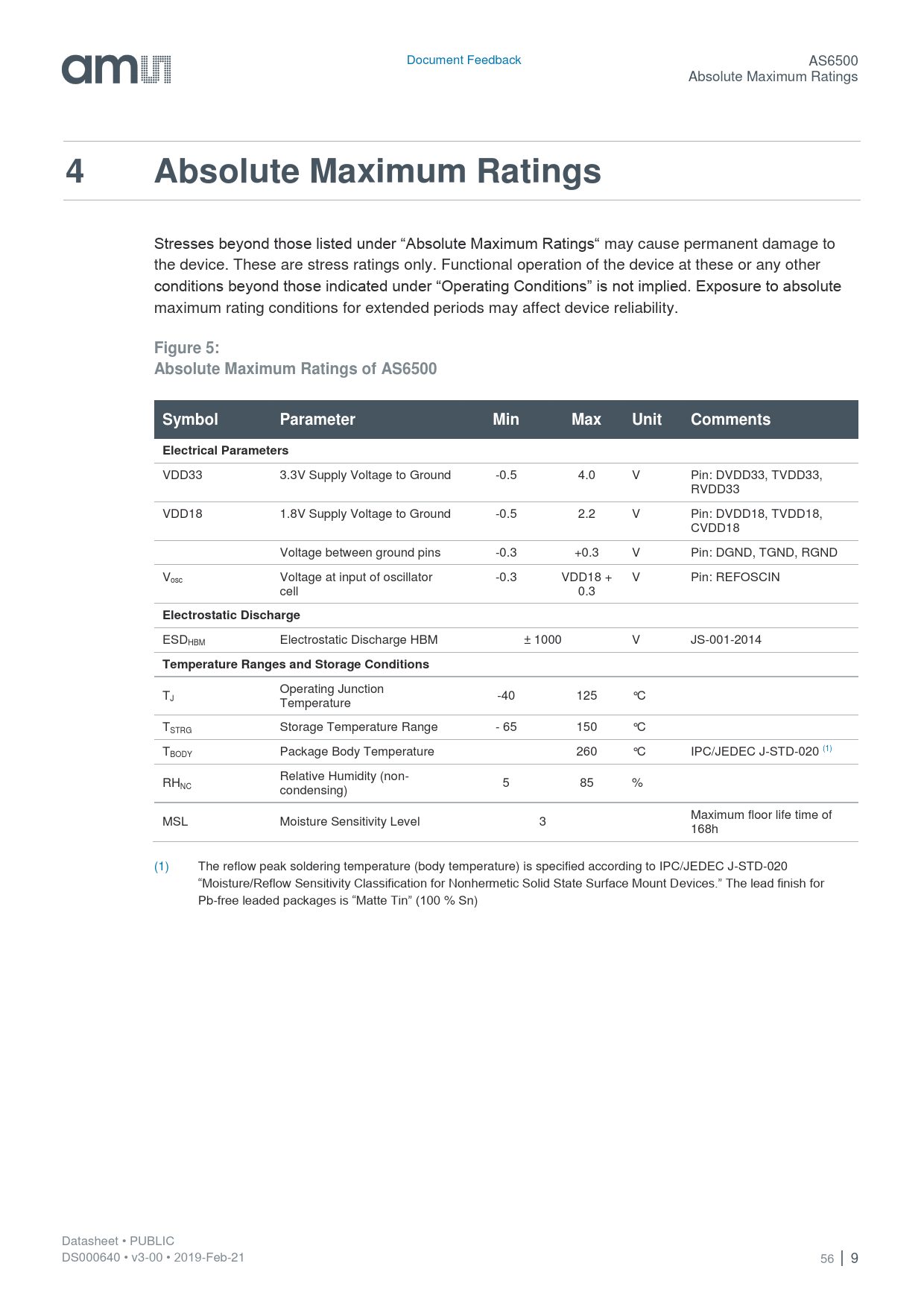

Absolute Maximum Ratings. Figure 5: Absolute Maximum Ratings of AS6500. Symbol. Parameter. Min. Max. Unit. Comments
Absolute Maximum Ratings Figure 5: Absolute Maximum Ratings of AS6500 Symbol Parameter Min Max Unit Comments
Document Feedback AS6500 Absolute Maximum Ratings
4 Absolute Maximum Ratings
Stresses beyond those listed under “Absolute Maximum Ratings“ may cause permanent damage to the device. These are stress ratings only. Functional operation of the device at these or any other conditions beyond those indicated under “Operating Conditions” is not implied. Exposure to absolute maximum rating conditions for extended periods may affect device reliability.
Figure 5: Absolute Maximum Ratings of AS6500 Symbol Parameter Min Max Unit Comments Electrical Parameters
VDD33 3.3V Supply Voltage to Ground -0.5 4.0 V Pin: DVDD33, TVDD33, RVDD33 VDD18 1.8V Supply Voltage to Ground -0.5 2.2 V Pin: DVDD18, TVDD18, CVDD18 Voltage between ground pins -0.3 +0.3 V Pin: DGND, TGND, RGND Vosc Voltage at input of oscillator -0.3 VDD18 + V Pin: REFOSCIN cell 0.3

ESDHBM Electrostatic Discharge HBM ± 1000 V JS-001-2014
Temperature Ranges and Storage Conditions
