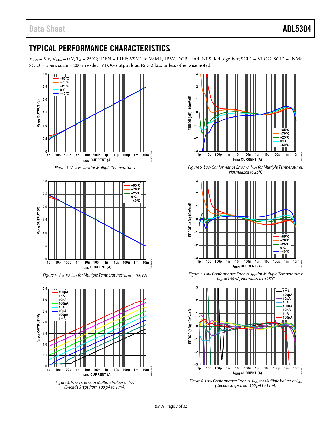

Data Sheet ADL5304 TYPICAL PERFORMANCE CHARACTERISTICS
VPOS = 5 V, VNEG = 0 V, TA = 25°C; IDEN = IREF; VSM1 to VSM4, 1P5V, DCBI, and INPS tied together; SCL1 = VLOG; SCL2 = INMS; SCL3 = open; scale = 200 mV/dec; VLOG output load RL > 2 kΩ, unless otherwise noted.

09459- Figure 3. VLOG vs. INUM for Multiple Temperatures Figure 6. Law Conformance Error vs. INUM for Multiple Temperatures; Normalized to 25°C

09459- 09459- Figure 4. V Figure 7. Law Conformance Error vs. I LOG vs. IDEN for Multiple Temperatures; INUM = 100 nA DEN for Multiple Temperatures; INUM = 100 nA; Normalized to 25°C

09459- Figure 5. V Figure 8. Law Conformance Error vs. INUM for Multiple Values of IDEN LOG vs. INUM for Multiple Values of IDEN (Decade Steps from 100 pA to 1 mA) (Decade Steps from 100 pA to 1 mA) Rev. A | Page 7 of 32 Document Outline FEATURES APPLICATIONS GENERAL DESCRIPTION SIMPLIFIED BLOCK DIAGRAM TABLE OF CONTENTS REVISION HISTORY SPECIFICATIONS ABSOLUTE MAXIMUM RATINGS ESD CAUTION PIN CONFIGURATION AND FUNCTION DESCRIPTIONS TYPICAL PERFORMANCE CHARACTERISTICS TEST CIRCUITS TERMINOLOGY THEORY OF OPERATION BASIC CONCEPTS OPTICAL MEASUREMENTS Decibel Scaling CIRCUIT DESCRIPTION Bandwidth vs. Current Noise vs. Current Filtering to Improve Noise and Dynamic Behavior Photodiode Bias Reference Outputs Buffer Amplifier Setting the Log Slope and Intercept Slope Inversion Log Ratio Operation APPLICATIONS INFORMATION USING THE ADL5304 Using the Adaptive Bias Summing Node Voltage Leakage VLOG Output Dynamic Response USING A NEGATIVE SUPPLY EVALUATION BOARD SCHEMATIC AND SILKSCREENS OUTLINE DIMENSIONS ORDERING GUIDE
