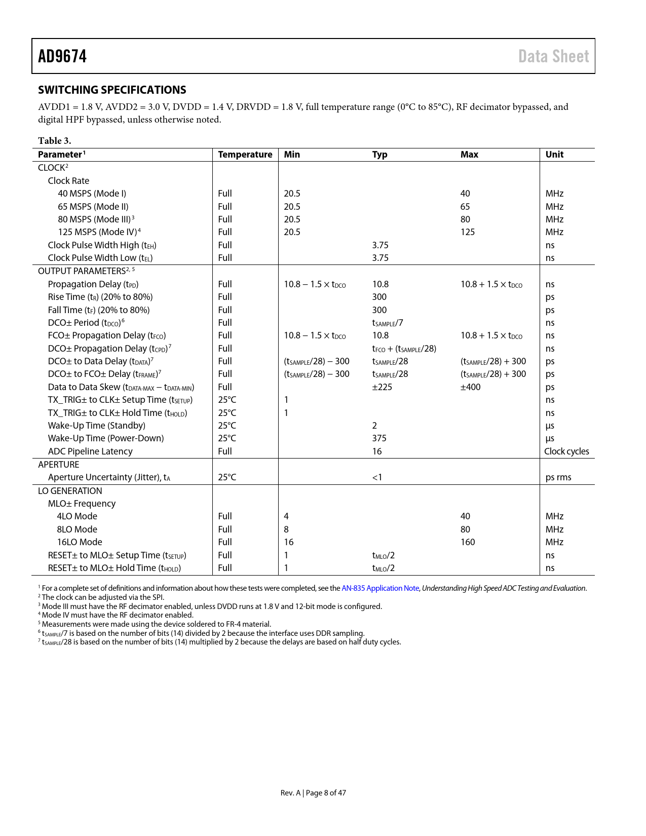

AD9674 Data Sheet SWITCHING SPECIFICATIONS
AVDD1 = 1.8 V, AVDD2 = 3.0 V, DVDD = 1.4 V, DRVDD = 1.8 V, full temperature range (0°C to 85°C), RF decimator bypassed, and digital HPF bypassed, unless otherwise noted.
Table 3. Parameter1 Temperature Min Typ Max Unit
CLOCK2 Clock Rate 40 MSPS (Mode I) Full 20.5 40 MHz 65 MSPS (Mode II) Full 20.5 65 MHz 80 MSPS (Mode III)3 Full 20.5 80 MHz 125 MSPS (Mode IV)4 Full 20.5 125 MHz Clock Pulse Width High (tEH) Full 3.75 ns Clock Pulse Width Low (tEL) Full 3.75 ns OUTPUT PARAMETERS2, 5 Propagation Delay (tPD) Full 10.8 − 1.5 × tDCO 10.8 10.8 + 1.5 × tDCO ns Rise Time (tR) (20% to 80%) Full 300 ps Fall Time (tF) (20% to 80%) Full 300 ps DCO± Period (tDCO)6 Full tSAMPLE/7 ns FCO± Propagation Delay (tFCO) Full 10.8 − 1.5 × tDCO 10.8 10.8 + 1.5 × tDCO ns DCO± Propagation Delay (tCPD)7 Full tFCO + (tSAMPLE/28) ns DCO± to Data Delay (tDATA)7 Full (tSAMPLE/28) − 300 tSAMPLE/28 (tSAMPLE/28) + 300 ps DCO± to FCO± Delay (tFRAME)7 Full (tSAMPLE/28) − 300 tSAMPLE/28 (tSAMPLE/28) + 300 ps Data to Data Skew (tDATA-MAX − tDATA-MIN) Full ±225 ±400 ps TX_TRIG± to CLK± Setup Time (tSETUP) 25°C 1 ns TX_TRIG± to CLK± Hold Time (tHOLD) 25°C 1 ns Wake-Up Time (Standby) 25°C 2 µs Wake-Up Time (Power-Down) 25°C 375 µs ADC Pipeline Latency Full 16 Clock cycles APERTURE Aperture Uncertainty (Jitter), tA 25°C <1 ps rms LO GENERATION MLO± Frequency 4LO Mode Full 4 40 MHz 8LO Mode Full 8 80 MHz 16LO Mode Full 16 160 MHz RESET± to MLO± Setup Time (tSETUP) Full 1 tMLO/2 ns RESET± to MLO± Hold Time (tHOLD) Full 1 tMLO/2 ns 1 For a complete set of definitions and information about how these tests were completed, see the AN-835 Application Note, Understanding High Speed ADC Testing and Evaluation. 2 The clock can be adjusted via the SPI. 3 Mode III must have the RF decimator enabled, unless DVDD runs at 1.8 V and 12-bit mode is configured. 4 Mode IV must have the RF decimator enabled. 5 Measurements were made using the device soldered to FR-4 material. 6 tSAMPLE/7 is based on the number of bits (14) divided by 2 because the interface uses DDR sampling. 7 tSAMPLE/28 is based on the number of bits (14) multiplied by 2 because the delays are based on half duty cycles. Rev. A | Page 8 of 47 Document Outline FEATURES APPLICATIONS GENERAL DESCRIPTION TABLE OF CONTENTS REVISION HISTORY FUNCTIONAL BLOCK DIAGRAM SPECIFICATIONS AC SPECIFICATIONS DIGITAL SPECIFICATIONS SWITCHING SPECIFICATIONS ADC Timing Diagram CW Doppler Timing Diagram ABSOLUTE MAXIMUM RATINGS THERMAL IMPEDANCE ESD CAUTION PIN CONFIGURATION AND FUNCTION DESCRIPTIONS TYPICAL PERFORMANCE CHARACTERISTICS TGC MODE CW DOPPLER MODE THEORY OF OPERATION TGC OPERATION Low Noise Amplifier (LNA) Active Impedance Matching LNA Noise CLNA Connection DC Offset Correction/High-Pass Filter Variable Gain Amplifier (VGA) Gain Control VGA Noise Antialiasing Filter (AAF) AAF/VGA Test Mode ADC Clock Input Considerations Clock Duty Cycle Considerations Clock Jitter Considerations Power Dissipation and Power-Down Mode Power and Ground Connection Recommendations Digital Outputs and Timing Digital Output Test Patterns SDIO Pin SCLK Pin CSB Pin RBIAS Pin VREF Pin General-Purpose Output Pins Chip Address Pins ANALOG TEST SIGNAL GENERATION CW DOPPLER OPERATION Quadrature Generation DIGITAL RF DECIMATOR VECTOR PROFILE RF DECIMATOR DC Offset Calibration Multiband AAF and Decimate by 2 High-Pass Filter DIGITAL TEST WAVEFORMS Waveform Generator Channel ID and Ramp Generator DIGITAL BLOCK POWER SAVING SCHEME SERIAL PORT INTERFACE (SPI) HARDWARE INTERFACE MEMORY MAP READING THE MEMORY MAP TABLE RESERVED LOCATIONS DEFAULT VALUES LOGIC LEVELS RECOMMENDED START-UP SEQUENCE MEMORY MAP REGISTER DESCRIPTIONS Transfer (Register 0x0FF) Profile Index and Manual TX_TRIG (Register 0x10C) OUTLINE DIMENSIONS ORDERING GUIDE
