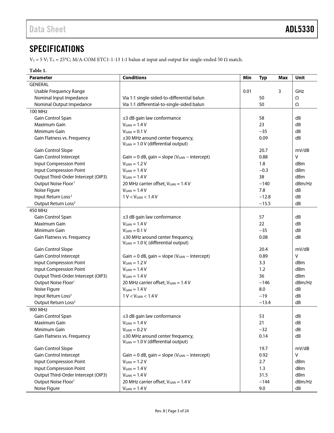

Data Sheet. ADL5330. SPECIFICATIONS. Table 1. Parameter. Conditions. Min. Typ. Max. Unit
Data Sheet ADL5330 SPECIFICATIONS Table 1 Parameter Conditions Min Typ Max Unit
link to page 4 link to page 4 link to page 4 link to page 4 link to page 4 link to page 4 link to page 4
VS = 5 V; TA = 25°C; M/A-COM ETC1-1-13 1:1 balun at input and output for single-ended 50 Ω match.
Table 1. Parameter Conditions Min Typ Max Unit
GENERAL Usable Frequency Range 0.01 3 GHz Nominal Input Impedance Via 1:1 single-sided-to-differential balun 50 Ω Nominal Output Impedance Via 1:1 differential-to-single-sided balun 50 Ω 100 MHz Gain Control Span ±3 dB gain law conformance 58 dB Maximum Gain VGAIN = 1.4 V 23 dB Minimum Gain VGAIN = 0.1 V −35 dB Gain Flatness vs. Frequency ±30 MHz around center frequency, 0.09 dB VGAIN = 1.0 V (differential output) Gain Control Slope 20.7 mV/dB Gain Control Intercept Gain = 0 dB, gain = slope (VGAIN − intercept) 0.88 V Input Compression Point VGAIN = 1.2 V 1.8 dBm Input Compression Point VGAIN = 1.4 V −0.3 dBm Output Third-Order Intercept (OIP3) VGAIN = 1.4 V 38 dBm Output Noise Floor1 20 MHz carrier offset, VGAIN = 1.4 V −140 dBm/Hz Noise Figure VGAIN = 1.4 V 7.8 dB Input Return Loss2 1 V < VGAIN < 1.4 V −12.8 dB Output Return Loss2 −15.5 dB 450 MHz Gain Control Span ±3 dB gain law conformance 57 dB Maximum Gain VGAIN = 1.4 V 22 dB Minimum Gain VGAIN = 0.1 V −35 dB Gain Flatness vs. Frequency ±30 MHz around center frequency, 0.08 dB VGAIN = 1.0 V, (differential output) Gain Control Slope 20.4 mV/dB Gain Control Intercept Gain = 0 dB, gain = slope (VGAIN − intercept) 0.89 V Input Compression Point VGAIN = 1.2 V 3.3 dBm Input Compression Point VGAIN = 1.4 V 1.2 dBm Output Third-Order Intercept (OIP3) VGAIN = 1.4 V 36 dBm Output Noise Floor1 20 MHz carrier offset, VGAIN = 1.4 V −146 dBm/Hz Noise Figure VGAIN = 1.4 V 8.0 dB Input Return Loss2 1 V < VGAIN < 1.4 V −19 dB Output Return Loss2 −13.4 dB 900 MHz Gain Control Span ±3 dB gain law conformance 53 dB Maximum Gain VGAIN = 1.4 V 21 dB Minimum Gain VGAIN = 0.2 V −32 dB Gain Flatness vs. Frequency ±30 MHz around center frequency, 0.14 dB VGAIN = 1.0 V (differential output) Gain Control Slope 19.7 mV/dB Gain Control Intercept Gain = 0 dB, gain = slope (VGAIN − intercept) 0.92 V Input Compression Point VGAIN = 1.2 V 2.7 dBm Input Compression Point VGAIN = 1.4 V 1.3 dBm Output Third-Order Intercept (OIP3) VGAIN = 1.4 V 31.5 dBm Output Noise Floor1 20 MHz carrier offset, VGAIN = 1.4 V −144 dBm/Hz Noise Figure VGAIN = 1.4 V 9.0 dB Rev. B | Page 3 of 24 Document Outline FEATURES APPLICATIONS FUNCTIONAL BLOCK DIAGRAM GENERAL DESCRIPTION TABLE OF CONTENTS REVISION HISTORY SPECIFICATIONS ABSOLUTE MAXIMUM RATINGS ESD CAUTION PIN CONFIGURATION AND FUNCTION DESCRIPTIONS TYPICAL PERFORMANCE CHARACTERISTICS THEORY OF OPERATION APPLICATIONS INFORMATION BASIC CONNECTIONS RF INPUT/OUTPUT INTERFACE GAIN CONTROL INPUT AUTOMATIC GAIN CONTROL INTERFACING TO AN IQ MODULATOR WCDMA TRANSMIT APPLICATION CDMA2000 TRANSMIT APPLICATION SOLDERING INFORMATION EVALUATION BOARD OUTLINE DIMENSIONS ORDERING GUIDE
