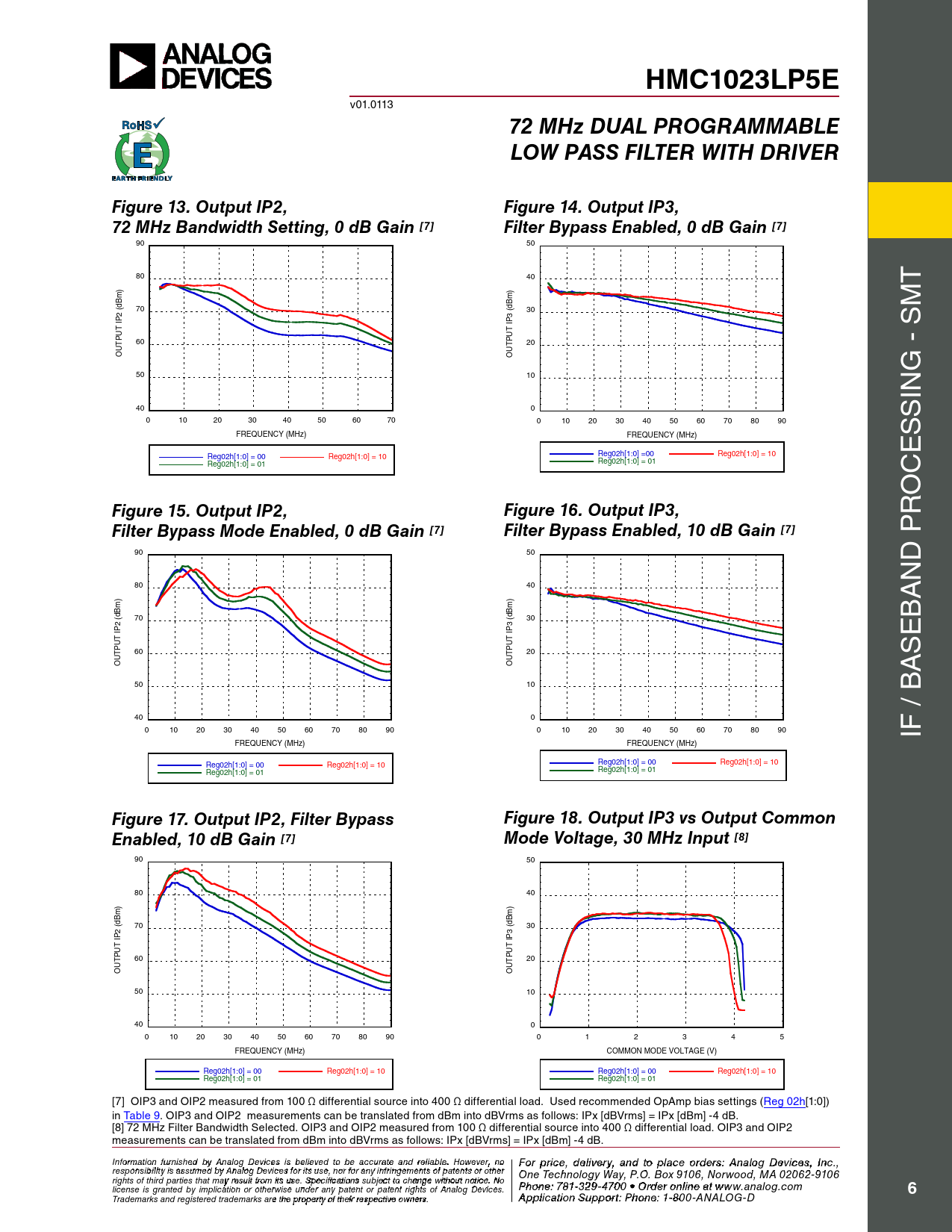

HMC1023LP5E. 72 MHz DUAL PROGRAMMABLE. LOW PASS FILTER WITH DRIVER. Figure 13. Output IP2,. Figure 14. Output IP3,
HMC1023LP5E 72 MHz DUAL PROGRAMMABLE LOW PASS FILTER WITH DRIVER Figure 13 Output IP2, Figure 14 Output IP3,
HMC1023LP5E
v01.0113
72 MHz DUAL PROGRAMMABLE LOW PASS FILTER WITH DRIVER Figure 13. Output IP2, Figure 14. Output IP3, 72 MHz Bandwidth Setting, 0 dB Gain [7] Filter Bypass Enabled, 0 dB Gain [7]
90 50 80 40 T 70 30 M 60 20 OUTPUT IP2 (dBm) OUTPUT IP3 (dBm) 50 G - S 10 IN 40 0 0 10 20 30 40 50 60 70 S 0 10 20 30 40 50 60 70 80 90 FREQUENCY (MHz) FREQUENCY (MHz) S Reg02h[1:0] = 00 Reg02h[1:0] = 10 Reg02h[1:0] =00 Reg02h[1:0] = 10 E Reg02h[1:0] = 01 Reg02h[1:0] = 01 C O
Figure 15. Output IP2, Figure 16. Output IP3,
R
Filter Bypass Mode Enabled, 0 dB Gain [7] Filter Bypass Enabled, 10 dB Gain [7]
90 50 D P N 80 40 A 70 30 B E 60 20 S OUTPUT IP2 (dBm) OUTPUT IP3 (dBm) A 50 10 40 0 0 10 20 30 40 50 60 70 80 90 0 10 20 30 40 50 60 70 80 90 IF / B FREQUENCY (MHz) FREQUENCY (MHz) Reg02h[1:0] = 00 Reg02h[1:0] = 10 Reg02h[1:0] = 00 Reg02h[1:0] = 10 Reg02h[1:0] = 01 Reg02h[1:0] = 01
Figure 17. Output IP2, Filter Bypass Figure 18. Output IP3 vs Output Common Enabled, 10 dB Gain [7] Mode Voltage, 30 MHz Input [8]
90 50 80 40 70 30 60 20 OUTPUT IP2 (dBm) OUTPUT IP3 (dBm) 50 10 40 0 0 10 20 30 40 50 60 70 80 90 0 1 2 3 4 5 FREQUENCY (MHz) COMMON MODE VOLTAGE (V) Reg02h[1:0] = 00 Reg02h[1:0] = 10 Reg02h[1:0] = 00 Reg02h[1:0] = 10 Reg02h[1:0] = 01 Reg02h[1:0] = 01 [7] OIP3 and OIP2 measured from 100 Ω differential source into 400 Ω differential load. Used recommended OpAmp bias settings (Reg 02h[1:0]) in Table 9. OIP3 and OIP2 measurements can be translated from dBm into dBVrms as follows: IPx [dBVrms] = IPx [dBm] -4 dB. [8] 72 MHz Filter Bandwidth Selected. OIP3 and OIP2 measured from 100 Ω differential source into 400 Ω differential load. OIP3 and OIP2 measurements can be translated from dBm into dBVrms as follows: IPx [dBVrms] = IPx [dBm] -4 dB. Inf F or o m r p atio r n ifc ur e n , d ishe e d lbiv y e A r n y a alog n D d t evic o p es is la beclie o eved rd to ebre sa: H ccur iattti e tae M nd re ilicarbloew . H a o ve C wever, o n rp o For price, delivery, and to place orders: Analog Devices, Inc., responsibility is assumed by Analog Devices for its use, nor for any infringements of patents or other oration, 2 Elizabeth Drive, Chelmsford, MA 01824 One Technology Way, P.O. Box 9106, Norwood, MA 02062-9106 Phone: 978-250-3343 Fax: 978-250-3373 O rights of third parties that may result from its use. Specifications subject to change without notice. No P rd hone e r O : 7 n 81- -3li 2n 9 e a -47 t w 0 w 0 • O w rd .h e it r o t niltie n .c e ao t m license is granted by implication or otherwise under any patent or patent rights of Analog Devices. www.analog.com
