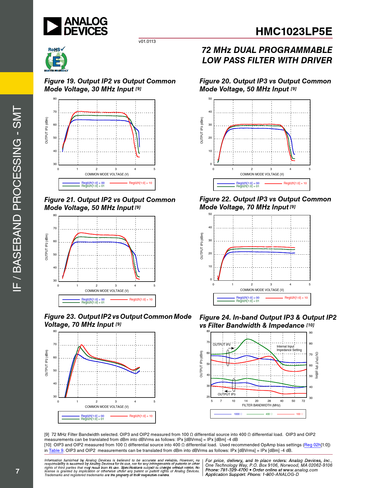

72 MHz DUAL PROGRAMMABLE LOW PASS FILTER WITH DRIVER Figure 19. Output IP2 vs Output Common Figure 20. Output IP3 vs Output Common Mode Voltage, 30 MHz Input [9] Mode Voltage, 50 MHz Input [9]
80 50 T M 70 40 60 30 G - S 50 20 OUTPUT IP2 (dBm) OUTPUT IP3 (dBm) IN 40 10 S S 30 0 0 1 2 3 4 5 0 1 2 3 4 5 E COMMON MODE VOLTAGE (V) COMMON MODE VOLTAGE (V) C Reg02h[1:0] = 00 Reg02h[1:0] = 10 Reg02h[1:0] = 00 Reg02h[1:0] = 10 O Reg02h[1:0] = 01 Reg02h[1:0] = 01 R
Figure 21. Output IP2 vs Output Common Figure 22. Output IP3 vs Output Common Mode Voltage, 50 MHz Input [9] Mode Voltage, 70 MHz Input [9]
D P 80 50 N A 70 40 B 60 30 E S 50 20 A OUTPUT IP2 (dBm) OUTPUT IP3 (dBm) 40 10 30 0 IF / B 0 1 2 3 4 5 0 1 2 3 4 5 COMMON MODE VOLTAGE (V) COMMON MODE VOLTAGE (V) Reg02h[1:0] = 00 Reg02h[1:0] = 10 Reg02h[1:0] = 00 Reg02h[1:0] = 10 Reg02h[1:0] = 01 Reg02h[1:0] = 01
Figure 23. Output IP2 vs Output Common Mode Figure 24. In-band Output IP3 & Output IP2 Voltage, 70 MHz Input [9] vs Filter Bandwidth & Impedance [10]
80 80 90 70 70 80 OUTPUT IP2 Internal Input Impedance Setting OUTPUT IP2 (dBm) 60 70 60 50 60 50 OUTPUT IP2 (dBm) 40 OUTPUT IP3 (dBm) 50 40 30 40 OUTPUT IP3 30 20 30 0 1 2 3 4 5 5 7 10 14 20 28 40 50 72 COMMON MODE VOLTAGE (V) FILTER BANDWIDTH (MHz) 1000 W 400 W 100 W Reg02h[1:0] = 00 Reg02h[1:0] = 10 Reg02h[1:0] = 01 [9] 72 MHz Filter Bandwidth selected. OIP3 and OIP2 measured from 100 Ω differential source into 400 Ω differential load. OIP3 and OIP2 measurements can be translated from dBm into dBVrms as follows: IPx [dBVrms] = IPx [dBm] -4 dB [10] OIP3 and OIP2 measured from 100 Ω differential source into 400 Ω differential load. Used recommended OpAmp bias settings (Reg 02h[1:0]) in Table 9. OIP3 and OIP2 measurements can be translated from dBm into dBVrms as follows: IPx [dBVrms] = IPx [dBm] -4 dB. Inf F or o m r p atio r n ifc ur e n , d ishe e d lbiv y e A r n y a alog n D d t evic o p es is la beclie o eved rd to ebre sa: H ccur iattti e tae M nd re ilicarbloew . H a o ve C wever, o n rp o For price, delivery, and to place orders: Analog Devices, Inc., responsibility is assumed by Analog Devices for its use, nor for any infringements of patents or other oration, 2 Elizabeth Drive, Chelmsford, MA 01824 One Technology Way, P.O. Box 9106, Norwood, MA 02062-9106
