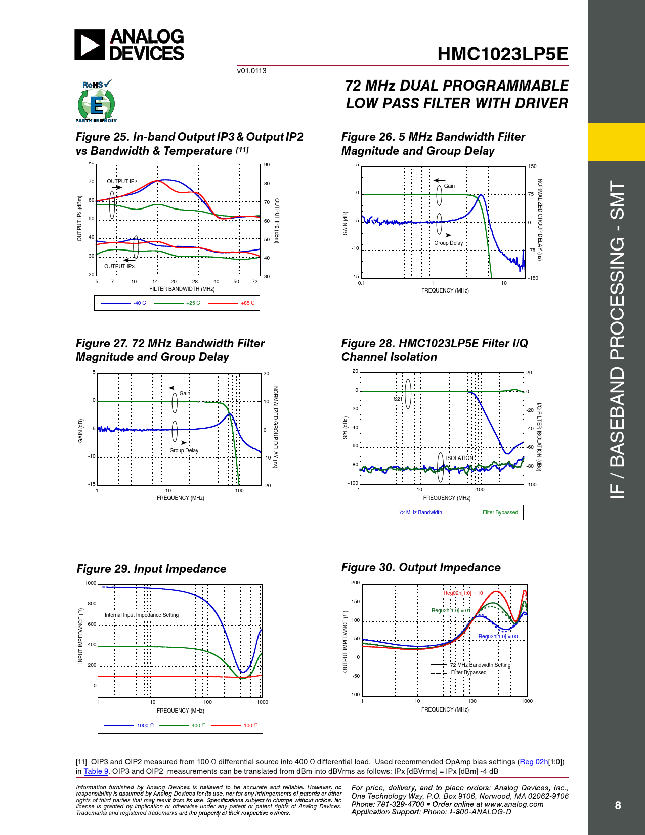

HMC1023LP5E. 72 MHz DUAL PROGRAMMABLE. LOW PASS FILTER WITH DRIVER. Figure 25. In-band Output IP3 & Output IP2
HMC1023LP5E 72 MHz DUAL PROGRAMMABLE LOW PASS FILTER WITH DRIVER Figure 25 In-band Output IP3 & Output IP2
HMC1023LP5E
v01.0113
72 MHz DUAL PROGRAMMABLE LOW PASS FILTER WITH DRIVER Figure 25. In-band Output IP3 & Output IP2 Figure 26. 5 MHz Bandwidth Filter vs Bandwidth & Temperature [11] Magnitude and Group Delay
80 90 5 150 NORM 70 OUTPUT IP2 80 Gain 0 ALIZED GROUP DELAY ( T OUTPUT IP2 (dBm) 75 60 70 M 50 60 -5 0 40 GAIN (dB) OUTPUT IP3 (dBm) 50 Group Delay -10 -75 n G - S 30 s) 40 OUTPUT IP3 IN 20 30 -15 -150 5 7 10 14 20 28 40 50 72 0.1 1 10 S FILTER BANDWIDTH (MHz) FREQUENCY (MHz) S -40 C +25 C +85 C E C O
Figure 27. 72 MHz Bandwidth Filter Figure 28. HMC1023LP5E Filter I/Q
R
Magnitude and Group Delay Channel Isolation
5 20 20 20 D P NORM 0 Gain 0 N 0 10 ALIZED GROUP DELAY ( S21 I/Q FILTER ISOLATION (dBc) A -20 -20 B -5 dBc) 0 -40 -40 E S21 ( GAIN (dB) S -60 -60 Group Delay -10 -10 A n ISOLATION s) -80 -80 -15 -20 -100 -100 1 10 100 1 10 100 FREQUENCY (MHz) FREQUENCY (MHz) IF / B 72 MHz Bandwidth Filter Bypassed
Figure 29. Input Impedance Figure 30. Output Impedance
1000 200 Reg02h[1:0] = 10 800 150 ) W ) Reg02h[1:0] = 01 Internal Input Impedance Setting W ( 100 600 E C N A D Reg02h[1:0] = 00 PEDANCE ( E 50 400 P IM T U 0 INPUT IM P 200 T U 72 MHz Bandwidth Setting O Filter Bypassed -50 0 -100 1 10 100 1000 1 10 100 1000 FREQUENCY (MHz) FREQUENCY (MHz) 1000 W 400 W 100 W [11] OIP3 and OIP2 measured from 100 Ω differential source into 400 Ω differential load. Used recommended OpAmp bias settings (Reg 02h[1:0]) in Table 9. OIP3 and OIP2 measurements can be translated from dBm into dBVrms as follows: IPx [dBVrms] = IPx [dBm] -4 dB Inf F or o m r p atio r n ifc ur e n , d ishe e d lbiv y e A r n y a alog n D d t evic o p es is la beclie o eved rd to ebre sa: H ccur iattti e tae M nd re ilicarbloew . H a o ve C wever, o n rp o For price, delivery, and to place orders: Analog Devices, Inc., responsibility is assumed by Analog Devices for its use, nor for any infringements of patents or other oration, 2 Elizabeth Drive, Chelmsford, MA 01824 One Technology Way, P.O. Box 9106, Norwood, MA 02062-9106 Phone: 978-250-3343 Fax: 978-250-3373 O rights of third parties that may result from its use. Specifications subject to change without notice. No P rd hone e r O : 7 n 81- -3li 2n 9 e a -47 t w 0 w 0 • O w rd .h e it r o t niltie n .c e ao t m license is granted by implication or otherwise under any patent or patent rights of Analog Devices. www.analog.com
