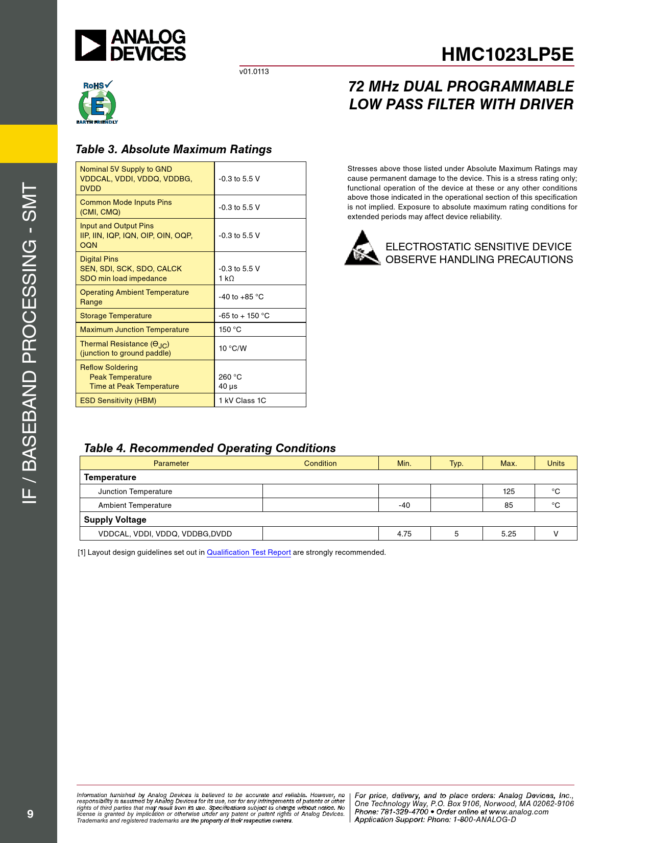

HMC1023LP5E. 72 MHz DUAL PROGRAMMABLE. LOW PASS FILTER WITH DRIVER. Table 3. Absolute Maximum Ratings
HMC1023LP5E 72 MHz DUAL PROGRAMMABLE LOW PASS FILTER WITH DRIVER Table 3 Absolute Maximum Ratings
HMC1023LP5E
v01.0113
72 MHz DUAL PROGRAMMABLE LOW PASS FILTER WITH DRIVER Table 3. Absolute Maximum Ratings
Nominal 5V Supply to GND Stresses above those listed under Absolute Maximum Ratings may T VDDCAL, VDDI, VDDQ, VDDBG, -0.3 to 5.5 V cause permanent damage to the device. This is a stress rating only; DVDD functional operation of the device at these or any other conditions M above those indicated in the operational section of this specification Common Mode Inputs Pins -0.3 to 5.5 V is not implied. Exposure to absolute maximum rating conditions for (CMI, CMQ) extended periods may affect device reliability. Input and Output Pins IIP, IIN, IQP, IQN, OIP, OIN, OQP, -0.3 to 5.5 V G - S OQN ELECTROSTATIC SENSITIVE DEVICE IN Digital Pins OBSERVE HANDLING PRECAUTIONS S SEN, SDI, SCK, SDO, CALCK -0.3 to 5.5 V SDO min load impedance 1 kΩ S Operating Ambient Temperature E -40 to +85 °C Range C Storage Temperature -65 to + 150 °C O Maximum Junction Temperature 150 °C R Thermal Resistance (ѲJC) 10 °C/W (junction to ground paddle) D P Reflow Soldering Peak Temperature 260 °C N Time at Peak Temperature 40 µs A ESD Sensitivity (HBM) 1 kV Class 1C B E S A
Table 4. Recommended Operating Conditions
Parameter Condition Min. Typ. Max. Units
Temperature
IF / B Junction Temperature 125 °C Ambient Temperature -40 85 °C
