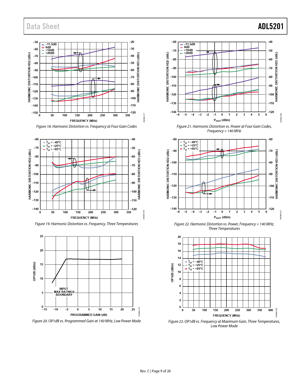

Data Sheet. ADL5201. –50. –20. –60. –40. –11.5dB. 0dB. –30. +10dB. –70. +20dB. Bc –70. Bc). –80. HD2. HD3. HD2 (. HD3 (. N –90. –90. O –100. –110. DI –110. IC DI. –120

09388- Figure 18. Harmonic Distortion vs. Frequency at Four Gain Codes Figure 21. Harmonic Distortion vs. Power at Four Gain Codes, Frequency = 140 MHz

0938 Figure 19. Harmonic Distortion vs. Frequency, Three Temperatures Figure 22. Harmonic Distortion vs. Power, Frequency = 140 MHz, Three Temperatures

09388- Figure 20. OP1dB vs. Programmed Gain at 140 MHz, Low Power Mode Figure 23. OP1dB vs. Frequency at Maximum Gain, Three Temperatures, Low Power Mode Rev. C | Page 9 of 26 Document Outline FEATURES APPLICATIONS FUNCTIONAL BLOCK DIAGRAM GENERAL DESCRIPTION TABLE OF CONTENTS REVISION HISTORY SPECIFICATIONS TIMING DIAGRAMS ABSOLUTE MAXIMUM RATINGS ESD CAUTION PIN CONFIGURATION AND FUNCTION DESCRIPTIONS TYPICAL PERFORMANCE CHARACTERISTICS CHARACTERIZATION AND TEST CIRCUITS THEORY OF OPERATION DIGITAL INTERFACE OVERVIEW PARALLEL DIGITAL INTERFACE SERIAL PERIPHERAL INTERFACE (SPI) Fast Attack UP/DOWN INTERFACE Truth Table LOGIC TIMING CIRCUIT DESCRIPTION BASIC STRUCTURE INPUT SYSTEM OUTPUT AMPLIFIER GAIN CONTROL APPLICATIONS INFORMATION BASIC CONNECTIONS ADC DRIVING LAYOUT CONSIDERATIONS EVALUATION BOARD EVALUATION BOARD CONTROL SOFTWARE SCHEMATICS AND ARTWORK EVALUATION BOARD CONFIGURATION OPTIONS Configuration Options for the Main Section Configuration Options for the USB Section OUTLINE DIMENSIONS ORDERING GUIDE
