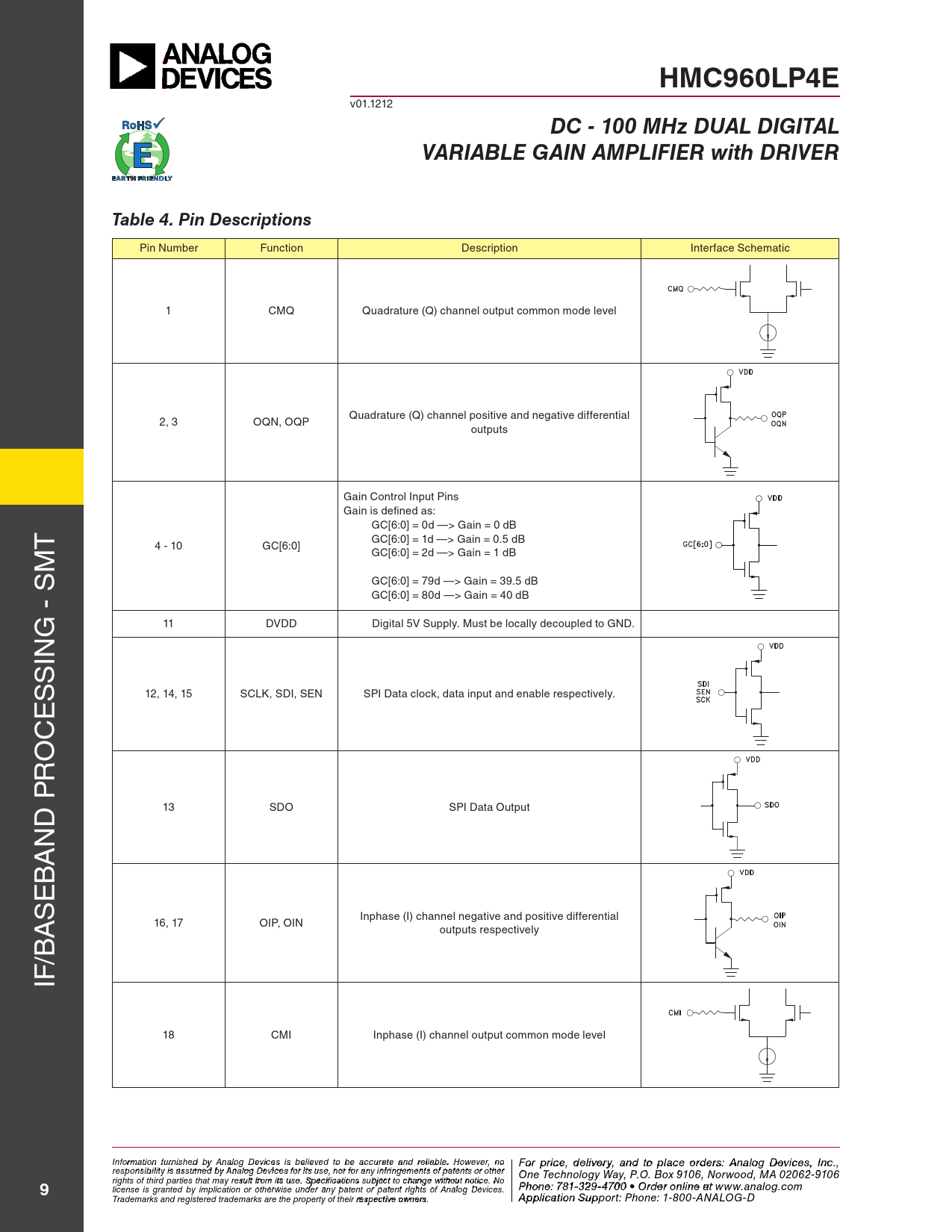

DC - 100 MHz DUAL DigitAL VAriAbLe gAin AMpLifier with DriVer table 4. pin Descriptions
Pin Number Function Description Interface Schematic 1 CMQ Quadrature (Q) channel output common mode level Quadrature (Q) channel positive and negative differential 2, 3 OQN, OQP outputs Gain Control Input Pins Gain is defined as: T GC[6:0] = 0d —> Gain = 0 dB GC[6:0] = 1d —> Gain = 0.5 dB 4 - 10 GC[6:0] M GC[6:0] = 2d —> Gain = 1 dB S GC[6:0] = 79d —> Gain = 39.5 dB - GC[6:0] = 80d —> Gain = 40 dB G 11 DVDD Digital 5V Supply. Must be locally decoupled to GND. IN S S 12, 14, 15 SCLK, SDI, SEN SPI Data clock, data input and enable respectively. E C RO P D 13 SDO SPI Data Output N A B E S A Inphase (I) channel negative and positive differential 16, 17 OIP, OIN outputs respectively IF/B 18 CMI Inphase (I) channel output common mode level Inf F or o m r p atio r n ifc ur e n , d ishe e d lbiv y e Anry a alog n D d t evic o p es is la be c liee o ved rd to e b r e sa: H ccur iattte itae M nd reliic a r bl o e. w H a o v wee C ver, o n rp o For price, delivery, and to place orders: Analog Devices, Inc., responsibility is assumed by Analog Devices for its use, nor for any infringements of patents or other oration, 2 Elizabeth Drive, Chelmsford, MA 01824 One Technology Way, P.O. Box 9106, Norwood, MA 02062-9106
