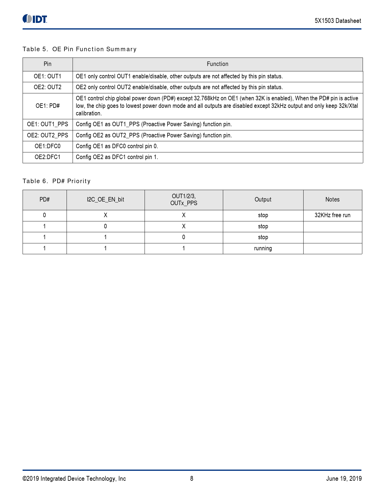

Table 5. OE Pin Function Summary Pin Function
OE1: OUT1 OE1 only control OUT1 enable/disable, other outputs are not affected by this pin status. OE2: OUT2 OE2 only control OUT2 enable/disable, other outputs are not affected by this pin status. OE1 control chip global power down (PD#) except 32.768kHz on OE1 (when 32K is enabled), When the PD# pin is active OE1: PD# low, the chip goes to lowest power down mode and all outputs are disabled except 32kHz output and only keep 32k/Xtal calibration. OE1: OUT1_PPS Config OE1 as OUT1_PPS (Proactive Power Saving) function pin. OE2: OUT2_PPS Config OE2 as OUT2_PPS (Proactive Power Saving) function pin. OE1:DFC0 Config OE1 as DFC0 control pin 0. OE2:DFC1 Config OE2 as DFC1 control pin 1.
Table 6. PD# Priority PD# I2C_OE_EN_bit OUT1/2/3, OUTx_PPS Output Notes
0 X X stop 32KHz free run 1 0 X stop 1 1 0 stop 1 1 1 running ©2019 Integrated Device Technology, Inc 8 June 19, 2019 Document Outline Description Typical Applications Features Output Features Key Specifications Block Diagram Pin Assignments Figure 1. Pin Assignments for 2.0 × 2.0 mm 10-VFQFPN Package Pin Descriptions Table 1. Pin Descriptions Device Feature and Function DFC – Dynamic Frequency Control Figure 2. DFC Function Block Diagram Table 2. DFC Function Priority DFC Function Programming PPS – Proactive Power Saving Function Figure 3. PPS Function Block Diagram Figure 4. PPS Assertion/Deassertion Timing Chart PPS Function Programming Output Divider Selection Table 3. Output Divider Selection Device Output Support 5X1503 5X1503L 5X1503S Input Pin Function Table 4. OE Pin Function Table 5. OE Pin Function Summary Table 6. PD# Priority Spread Spectrum Spread Spectrum Digital Spread Spectrum Figure 5. Digital Spread Spectrum Absolute Maximum Ratings Table 7. Absolute Maximum Ratings Thermal Characteristics Table 8. Thermal Characteristics Recommended Operating Conditions Table 9. Recommended Operating Conditions Crystal Characteristics Table 10. Embedded Crystal Characteristics DC Electrical Characteristics Table 11. DC Electrical Characteristics – Current Table 12. DC Electrical Characteristics – Input and Output Voltage AC Electrical Characteristics Table 13. AC Timing Electrical Characteristics I2C Bus DC Characteristics Table 14. I2C Bus DC Characteristics Table 15. I2C Bus AC Characteristics Spread Spectrum Generation Specifications Table 16. Spread Spectrum Generation Specifications (5X1503S only) General I2C Interface Information How to Write How to Read Glossary of Features Table 17. Glossary of Features Package Outline Drawings Ordering Information Marking Diagrams Revision History
