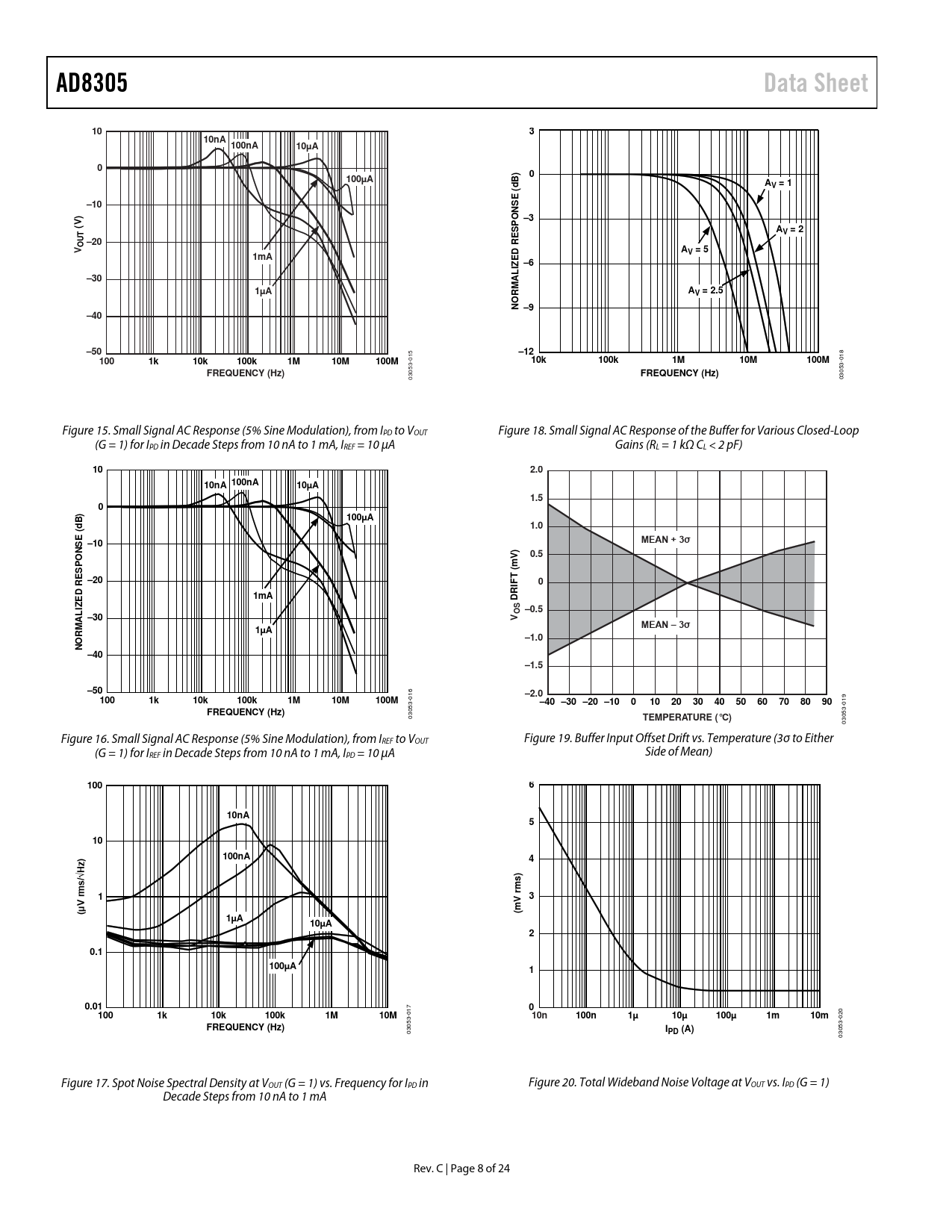

AD8305. Data Sheet. 10nA 100nA. 10µA. 100µA. AV = 1. –10. SE (d N. (V). AV = 2. ESPO. O –20. AV = 5. 1mA. ED IZ –6. –30. 1µA. AV = 2.5. O N –9. –40. –50. –12. 100
AD8305 Data Sheet 10nA 100nA 10µA 100µA AV = 1 –10 SE (d N (V) AV = 2 ESPO O –20 AV = 5 1mA ED IZ –6 –30 1µA AV = 2.5 O N –9 –40 –50 –12 100
AD8305 Data Sheet 10 3 10nA 100nA 10µA 0 ) 0 100µA B AV = 1 –10 SE (d N –3 (V) AV = 2 UT ESPO O –20 R V AV = 5 1mA ED IZ –6 L –30 MA 1µA R AV = 2.5 O N –9 –40 –50 –12 100 1k 10k 100k 1M 10M 100M
015
018
FREQUENCY (Hz) FREQUENCY (Hz)
03053- 03053- Figure 15. Small Signal AC Response (5% Sine Modulation), from IPD to VOUT Figure 18. Small Signal AC Response of the Buffer for Various Closed-Loop (G = 1) for IPD in Decade Steps from 10 nA to 1 mA, IREF = 10 µA Gains (RL = 1 kΩ CL < 2 pF)
10 2.0 10nA 100nA 10µA 1.5 0 ) B 100µA 1.0 MEAN + 3σ SE (d –10 N ) 0.5 mV ( ESPO T –20 F R 0 ED 1mA DRI IZ L OS –0.5 –30 V MA MEAN – 3σ R 1µA O –1.0 N –40 –1.5 –50 –2.0 100 1k 10k 100k 1M 10M 100M
016
–40 –30 –20 –10 0 10 20 30 40 50 60 70 80 90
019
FREQUENCY (Hz)
03053-
TEMPERATURE (°C)
03053- Figure 16. Small Signal AC Response (5% Sine Modulation), from IREF to VOUT Figure 19. Buffer Input Offset Drift vs. Temperature (3σ to Either (G = 1) for IREF in Decade Steps from 10 nA to 1 mA, IPD = 10 µA Side of Mean)
100 6 10nA 5 10 ) 100nA 4 √Hz 1 rms) 3 (µV rms/ (mV 1µA 10µA 2 0.1 100µA 1 0.01 0 100 1k 10k 100k 1M 10M
017
10n 100n 10µ 100µ 1m 10m
020
FREQUENCY (Hz) I
03053-
PD (A)
