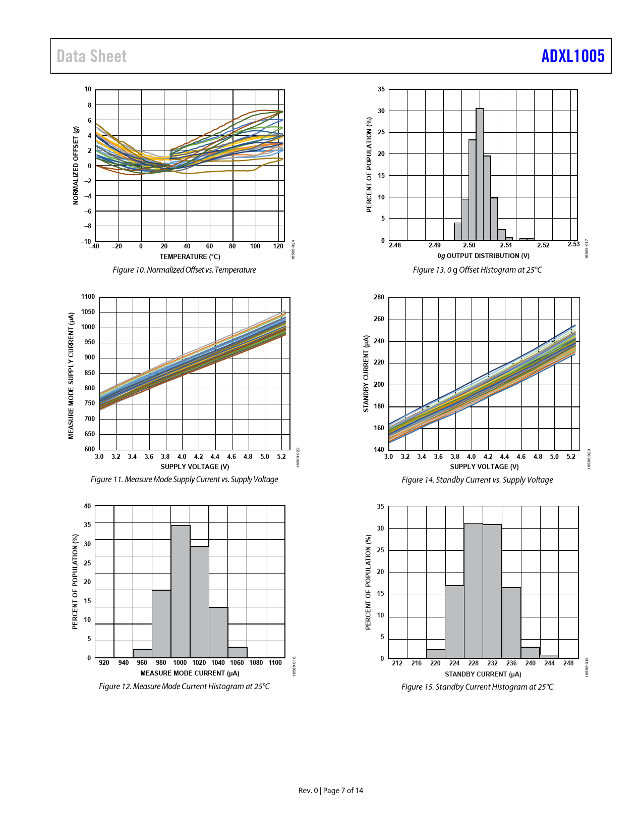

Data Sheet. ADXL1005. ) %. PUL. D O. F 15. RM –4. ENT C 10. –10. 100. 120. 2.48. 2.49. 2.50. 2.51. 2.52. 2.53. TEMPERATURE (°C). OUTPUT DISTRIBUTION (V)
Data Sheet ADXL1005 ) % PUL D O F 15 RM –4 ENT C 10 –10 100 120 2.48 2.49 2.50 2.51 2.52 2.53 TEMPERATURE (°C) OUTPUT DISTRIBUTION (V)
Data Sheet ADXL1005 10 35 8 30 6 ) % ) ( (g N 4 25 T IO E T S A F 2 F 20 PUL D O 0 O E P IZ F 15 –2 AL O RM –4 ENT C 10 NO R –6 PE 5 –8 –10

589 16 16 Figure 10. Normalized Offset vs. Temperature Figure 13. 0 g Offset Histogram at 25°C
1100 280 ) 1050 A 260 1000 NT E 950 A) 240 RR (µ T CU 900 N Y E L 220 R P R P 850 U U C S Y 200 800 DE DB O 750 M TAN 180 E S UR 700 AS 160 E 650 M 600 140

16 Figure 11. Measure Mode Supply Current vs. Supply Voltage Figure 14. Standby Current vs. Supply Voltage
40 35 35 30 ) ) % ( % 30 ( N 25 TIO TION A 25 L A L 20 PU PU 20 PO F PO F 15 O T 15 O T EN EN C C 10 10 PER PER 5 5 0

165 Figure 12. Measure Mode Current Histogram at 25°C Figure 15. Standby Current Histogram at 25°C Rev. 0 | Page 7 of 14 Document Outline FEATURES APPLICATIONS FUNCTIONAL BLOCK DIAGRAM GENERAL DESCRIPTION TABLE OF CONTENTS REVISION HISTORY SPECIFICATIONS ABSOLUTE MAXIMUM RATINGS THERMAL RESISTANCE RECOMMENDED SOLDERING PROFILE ESD CAUTION PIN CONFIGURATION AND FUNCTION DESCRIPTIONS TYPICAL PERFORMANCE CHARACTERISTICS THEORY OF OPERATION MECHANICAL DEVICE OPERATION OPERATING MODES Measure Mode Standby Mode BANDWIDTH APPLICATIONS INFORMATION APPLICATION CIRCUIT ON DEMAND SELF TEST RATIOMETRIC OUTPUT VOLTAGE INTERFACING ANALOG OUTPUT BELOW 10 kHz INTERFACING ANALOG OUTPUT BEYOND 10 kHz OVERRANGE MECHANICAL CONSIDERATIONS FOR MOUNTING LAYOUT AND DESIGN RECOMMENDATIONS OUTLINE DIMENSIONS ORDERING GUIDE
