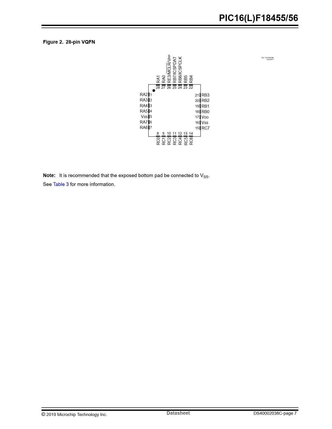

PIC16(L)F18455/56 Figure 2. 28-pin VQFN
P Rev. 00-000028B P T K 6/23/2017 L /V R DA C L P P C S /M /ICS /IC 1 0 3 7 6 5 4 A A E B B B B R R R R R R R 28 27 26 25 24 23 22 RA2 1 21 RB3 RA3 2 20 RB2 RA4 3 19 RB1 RA5 4 18 RB0 VSS 5 17 VDD RA7 6 16 VSS RA6 7 15 RC7 8 9 10 11 12 13 14 0 1 2 3 4 5 6 C C C C C C C R R R R R R R
Note: 
It is recommended that the exposed bottom pad be connected to VSS. See Table 3 for more information. © 2019 Microchip Technology Inc.
