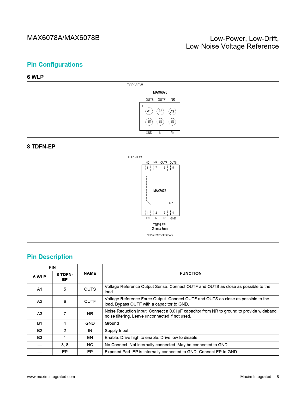

Pages / Page13 / 8 — Pin Configurations. 6 WLP. 8 TDFN-EP. Pin Description. PIN. NAME. …
Pin Configurations. 6 WLP. 8 TDFN-EP. Pin Description. PIN. NAME. FUNCTION. 8 TDFN-
Pin Configurations 6 WLP 8 TDFN-EP Pin Description PIN NAME FUNCTION 8 TDFN-
MAX6078A/MAX6078B Low-Power, Low-Drift, Low-Noise Voltage Reference
TOP VIEW MAX6078 OUTS OUTF NR + A1 A2 A3 B1 B2 B3 GND IN EN
8 TDFN-EP
TOP VIEW NC NR OUTF OUTS 8 7 6 5 MAX6078 EP* + 1 2 3 4 EN IN NC GND TDFN-EP 2mm x 3mm *EP = EXPOSED PAD
Pin Description PIN NAME FUNCTION 8 TDFN- 6 WLP EP
Voltage Reference Output Sense. Connect OUTF and OUTS as close as possible to the A1 5 OUTS load. Voltage Reference Force Output. Connect OUTF and OUTS as close as possible to the A2 6 OUTF load. Bypass OUTF with a capacitor to GND. Noise Reduction Input. Connect a 0.01μF capacitor from NR to ground to provide wideband A3 7 NR noise filtering. Leave unconnected if not used. B1 4 GND Ground B2 2 IN Supply Input B3 1 EN Enable. Drive high to enable. Drive low to disable. — 3, 8 NC No Connect. Not internally connected. May be connected to GND. — EP EP Exposed Pad. EP is internally connected to GND. Connect EP to GND. www.maximintegrated.com Maxim Integrated | 8 Document Outline General Description Applications Benefits and Features Simplified Block Diagram Absolute Maximum Ratings Package Information 8 TDFN 8 WLP Electrical Characteristics – 2.5V Typical Operating Characteristics Pin Configurations 6 WLP 8 TDFN-EP Pin Description Functional Diagram Typical Operating Circuit Detailed Description Wideband Noise Reduction (NR) Output Bypassing Turn-On Time Output Force and Sense Shutdown Thermal Hysteresis Applications Information Precision Current Source Ordering Information Revision History
