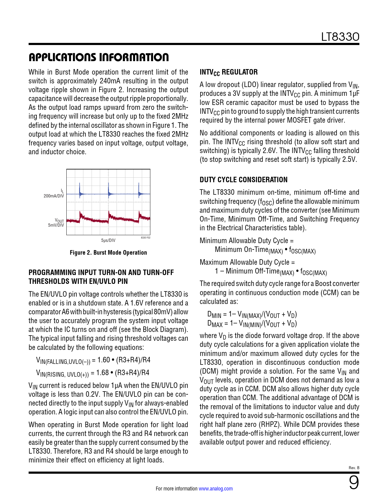

While in Burst Mode operation the current limit of the
INTVCC REGULATOR
switch is approximately 240mA resulting in the output A low dropout (LDO) linear regulator, supplied from V voltage ripple shown in Figure 2. Increasing the output IN, produces a 3V supply at the INTV capacitance will decrease the output ripple proportionally. CC pin. A minimum 1µF low ESR ceramic capacitor must be used to bypass the As the output load ramps upward from zero the switch- INTV ing frequency will increase but only up to the fixed 2MHz CC pin to ground to supply the high transient currents required by the internal power MOSFET gate driver. defined by the internal oscillator as shown in Figure 1. The output load at which the LT8330 reaches the fixed 2MHz No additional components or loading is allowed on this frequency varies based on input voltage, output voltage, pin. The INTVCC rising threshold (to allow soft start and and inductor choice. switching) is typically 2.6V. The INTVCC falling threshold (to stop switching and reset soft start) is typically 2.5V.
DUTY CYCLE CONSIDERATION
IL The LT8330 minimum on-time, minimum off-time and 200mA/DIV switching frequency (fOSC) define the allowable minimum and maximum duty cycles of the converter (see Minimum VOUT On-Time, Minimum Off-Time, and Switching Frequency 5mV/DIV in the Electrical Characteristics table). 5µs/DIV 8330 F02 Minimum Allowable Duty Cycle =
Figure 2. Burst Mode Operation
